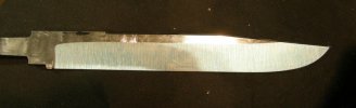

I am very happy to be working on a Big Bowie for Jon Klein, the blade was already forged to shape and surface ground, when I started taking pics so we will start from there.
First I mark a center line around the blade
attachment.php
with this jig I grind a bevel to the center line
attachment.php
I put a different angle on top of the blade
attachment.php
attachment.php
above is the jig I cut the clip with
attachment.php
this is the cut from the first jig
