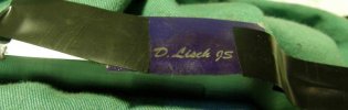

time to put my mark on it
attachment.php
then a bit more sanding

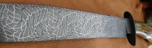

I go in and clean the blade with long strokes with 600 paper until I like what I see and I like what I see.
attachment.php
I just cleaned off the scale with a wire brush they needs another etch

attachment.php
etched and buffed again looks better to me now when I say buffed I mean with a wire wheel
attachment.php
then a little heat blue
attachment.php
nice
attachment.php
then for a swim in the JP Wax while hot

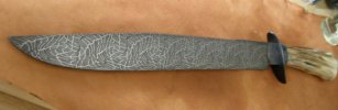

some JB weld for a water tight seal on the guard
attachment.php
put the handle on and with a very big clamp hold the guard in place till dry
attachment.php
now fill the handle with the pest epoxy money can buy tilt the handle and pour in on one side so you don't get a bubble
attachment.php
back in the big clamp

well I hope you enjoyed it I will have pro take a pic of this one as i can not get the hole knife in one shot I will be back in a bit with one last shot thank for looking
