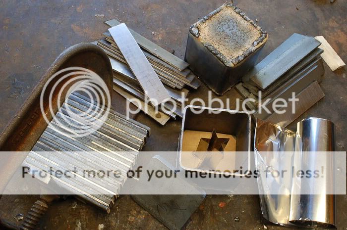

This is an order I just started and I throught I'd try to show some of what is involved in its creation. This is going to be a mosaic tile dagger (hopefully) with a W pattern cutting edge and tip with a few stars down the center, elephant ivory handle, fluted with twisted wire inlay.
This is some of the materials I'm starting with. 1080 & 15n20 for the bar stock to make the W pattern damascus and I'll make 2 cans with stars to asure I have enough material. The can with the stars will use 4800 and 1084 powdered steel, the star shape is made fromthin nickel sheeting.

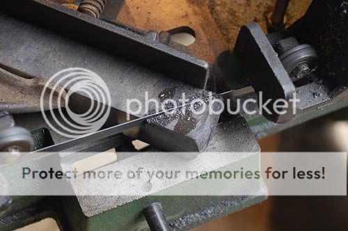

I've welded the billet up and reduced it to 1 1/2" by 3/4", here I'm grinding clean the surfaces that will be cut, stacked and rewelded.

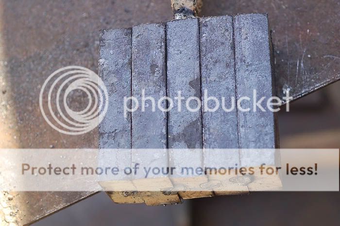

here's the billet cut into 5 equal pieces and restacked, I'll weld this up then cut,stack and reweld again.

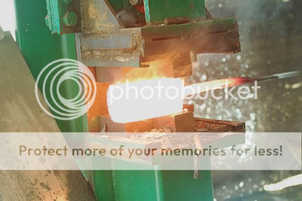

Here I'm welding up 1 of the star cans, I like to use a stop gauge between my dies just to make sure I don't over squeeze the cans and cause a lot of distortion, the stars will get distorted as it is with all the manipulating I'll be doing to them so this helps me keep it as minimal as I can.
