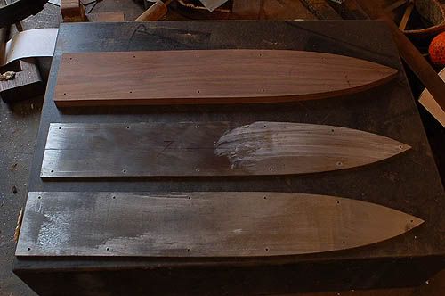

I did get started on the sheath yesterday and this is what I accomplished.

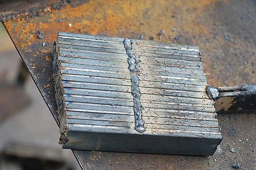

Started with 30 layers.

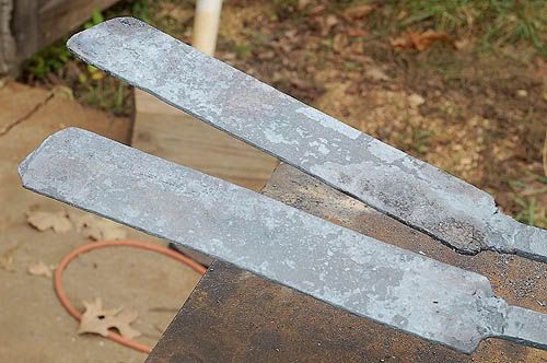

heres the sides of our sheath, today I'll get these cleaned up work on the throat, frog and wood spacer.

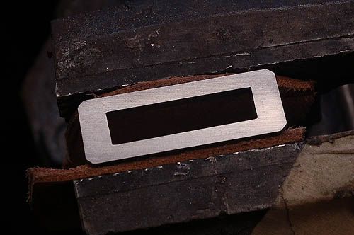

Here's an update on what was accomplished today.
Damascus cleaned up and wood spacer sanded to the correct thickness.

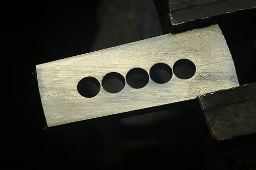

damascus piece drilled and ready to be filed out for throat.
Here it is filed to size,shape and sanded to 1000 grit.

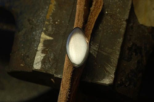

Piece of star damascus to become the frog.
Here it is shaped and sanded to 1000 grit.

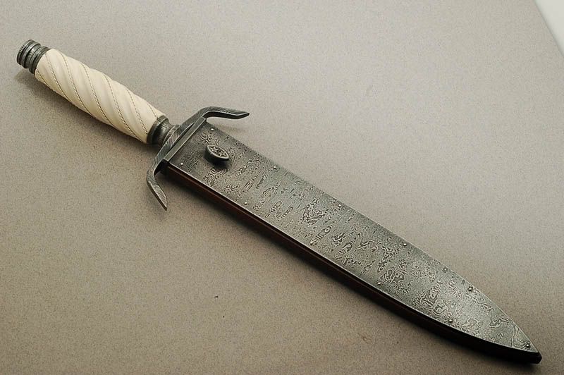

Here's the last of this project, thank you all for looking and for the great comments.

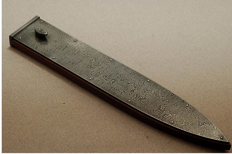

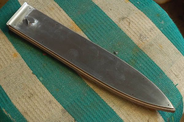

Here's the sheath with the throat and frog soldered in place.
all put together and etched.
the last one, with dagger in place.
