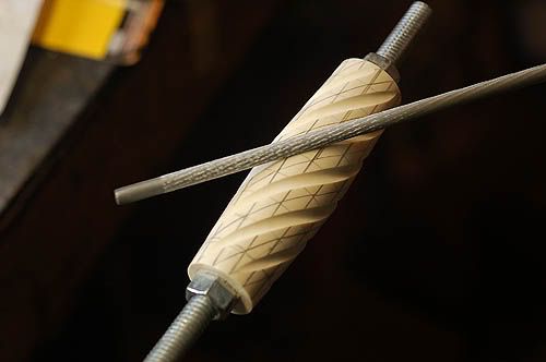

Peter, the jig is just for holding the ivory so it can be turned and marked, after its laid out its taken from the jig with a rod down the center and held in a bench vise while filing.
I purchased the DVD " The Quillion of Quality" by Jerome Anders a couple years ago and Jeromes instruction helped me a great deal, I would recommend it to anyone that has never made a fluted quillion dagger before, he offers several helpful hints and suggestions.
Here's where I was first rough cutting in the flutes with a round file, I actually cut a shallow groove on the lines with a 3 corner file first then followed up with the round file, that way I had a channel to help keep the round file straight, probably not necessary but it helped me feel more comfortable.

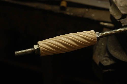

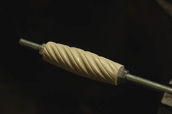

Here's 2 different angles showing it with the flutes and wire channels cut in.

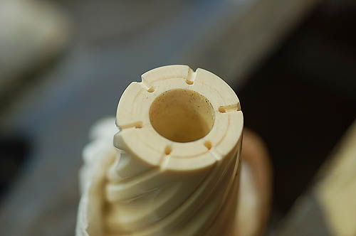

The ivory ends were drill to accept and hold the wire ends.

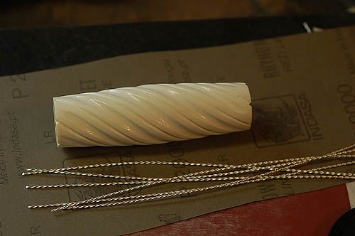

heres the handle with the silver wires all twisted and ready to be put in place.

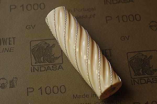

Here it is all finished, tomorrow I'm going to etch everything and get it all put together , I hope. :)

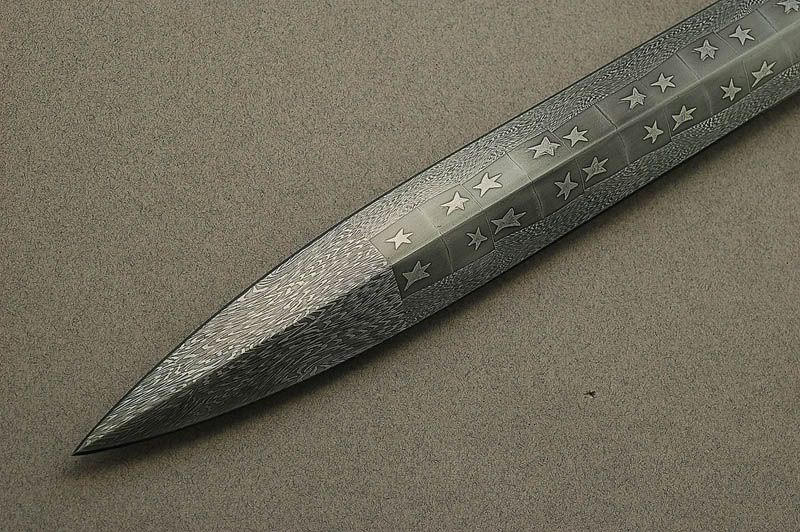

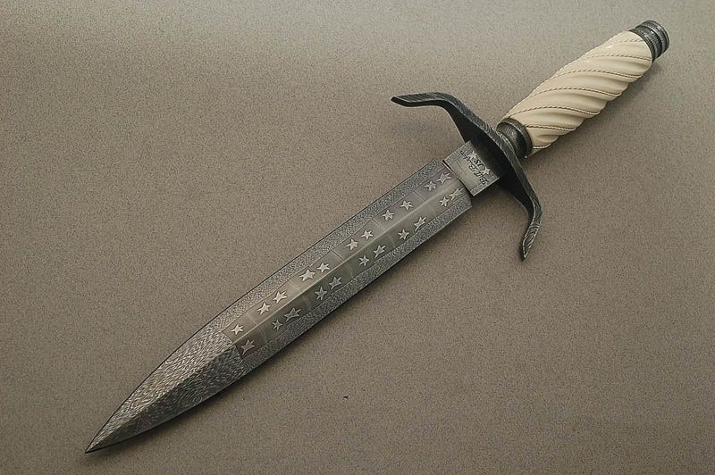

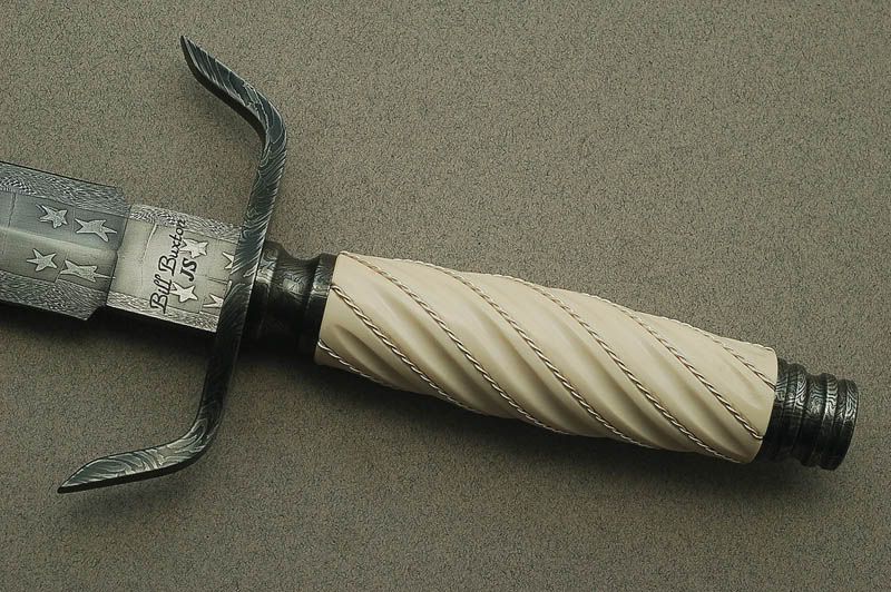

Got her finished today and here it is,
OAL- 15 1/2" with a 10 1/4" blade. .999 silver wire and elephant ivory.
Tomorrow I'll get started on that sheath.
Thanks for looking and all the great comments.
Bill
