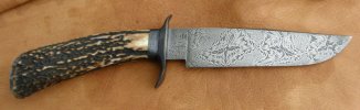

Good Thread Gary Hear is 3 ex I would call mosaic the first two our done by the Ferry flip way putt the 3rd is done buy the way they call loafing the pattern is compressed at the end of the par then opened up as you forge out the blade I would call this a mosaic. ? would I be wrong to do so
attachment.php
attachment.php
attachment.php
