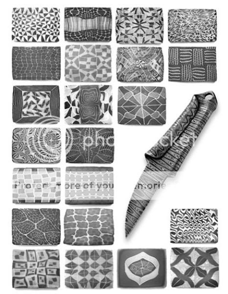

Some Robert Eggerling Mosaic.
Johnny
Hello Johnny,
The full page image you used here is from one of my books and
is fully copyrighted material. It is okay to use on the Forums but
this should be done only with full mention of the source...
From "The Art of Modern Custom Knifemaking" by Dr. David Darom (2006)
All the best,
David Darom (ddd)
