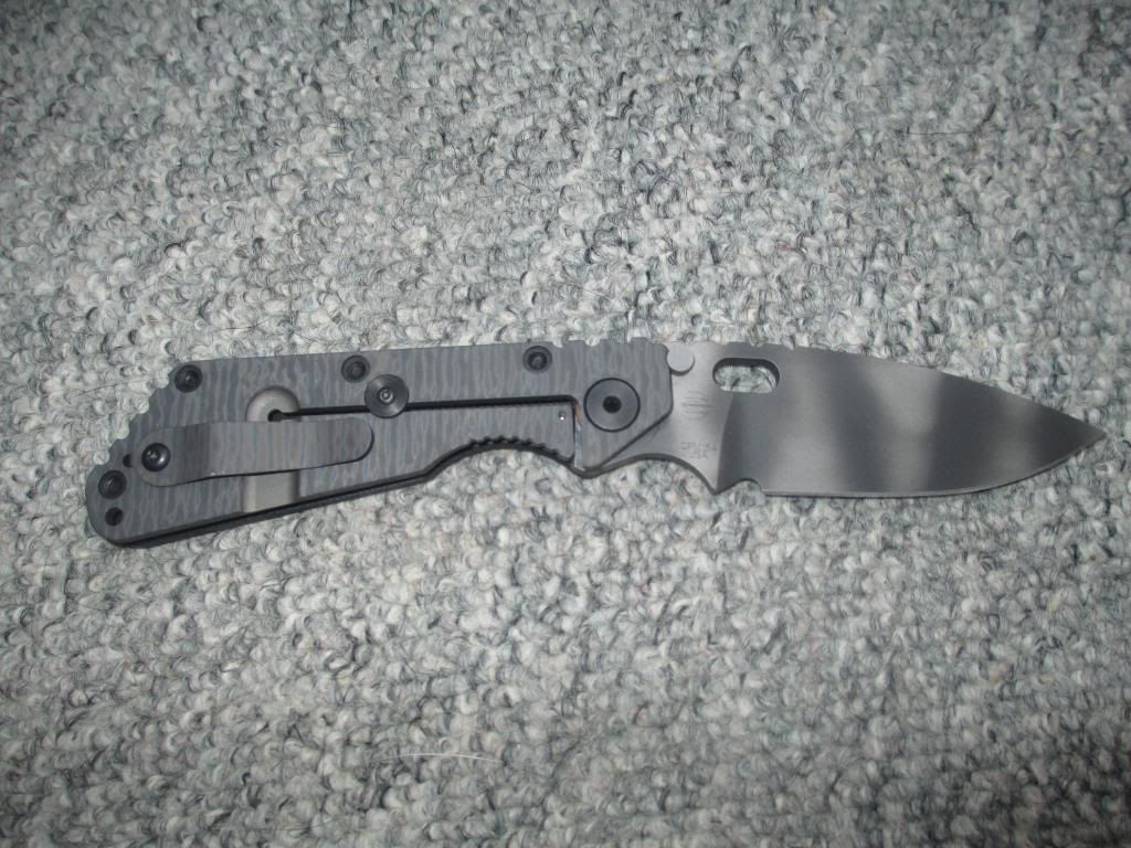

I'm posting this for posterity purposes.
I took the plunge and bought a Strider SMF, having never held a Strider before. My first high end production knife. Most expensive knife I had bought before was a ZT 0801. Loved the look, so I bought a Tiger Stripe Black g10 lego, with flamed titanium lock side. I purchased from a reputable dealer of Striders. Not sure when it was produced.
When I got the knife in hand I was IN LOVE. The flamed titanium is amazing, pictures on the internet do not do it justice. The g10 is the gripiest I've handled. The ergos are great for my hand. The gimping is super effective (at tearing up my knuckles when I reach in my pocket).
The first thing I noticed when I started to look at the lock function is that the lock bar is no where near as strong as my 0801. The 0801 is a pain to close, it's super tensioned and there just isn't enough material to really good a good grip on the lock bar with your thumb. The lock up on the strider was very early when I got it, maybe 10%? As the next week or so went by, I started to notice the lock rock develop. And it slowly got worse. Having never handled a Strider, and not knowing anyone who has, I took it to a semi-local knife shop to get a second opinion. The salesman thought the tension was weak too. But another guy in the store said that Strider would just put some rubber on the stop pin to stop the lock rock.
It's been a week since I went to the knife store, and the lock rock hasn't gotten any worse. The lock won't slip and let the knife close, I've tested it with pressure on the spine of the blade. Once I have a good grip on the knife, the problem goes away. Obviously, since I am applying pressure to the lock bar. I'm not afraid of the knife failing on me, so I think I'm going to continue to use it. If it gets worse or I start to be concerned about the safety aspect, I'll send it back to Strider.
I'm curious has to how Strider would fix this issue. Anyone have any experience with Strider spa services? If I send this in, what are they going to do to it?

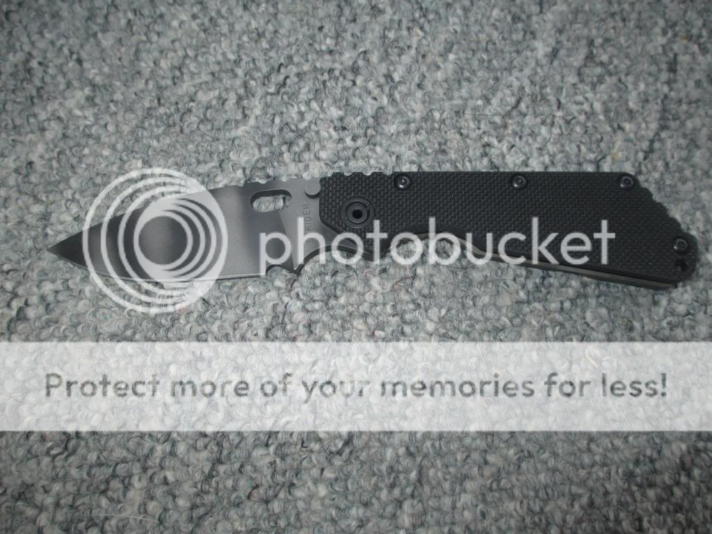

And, because all threads without pictures are useless:
This happens to a lot of Striders. I personally think it's a bit of a design flaw but others will definitely disagree. Just keep using it and see if the lock face breaks in a bit more. As far as sending it in, Strider will probably put caps on the stop pin so the lock face contacts earlier.
Try imgur for hosting pictures. It sounds like maybe not enough tension in your lockbar? If that is the case Strider would put more bend in the lockbar and send it back to you. If you have the old style lockup and the blade developed lock rock they install a larger stop pin to move the lockup to an earlier position. Check for a loose pivot also
I'm guessing it needs more lockbar tension. I received an SnG-T earlier this week that developed cosmetic lock rock (cosmetic in that the lock is not at risk of failure) and it's obvious that it needs more tension on the lockbar. It's a fix you can do yourself if you have the guts for it, but I chose to send mine back to Strider. A quick google shows that it's an issue people have had in the past with them.

Send it back to Strider via private carrier (NOT USPS...that would be too convenient) with a note and $25.00. They will either bend over the lockbar, or push the thumbstud out and replace it with a slightly larger one.
A few weeks later, and $40 poorer (for insured shipping both ways, of course), you will get your 3 week old knife back! Ain't it grand??
( If you are tempted to try and bend the lockbar further yourself, you have voided the warranty as soon as the knife is disassembled, and they won't touch it.)

I remember one guy sending his in and getting it back with a larger stop pin which fixed the issue. But your issue sounds like the lock is slipping out a small amount since it is fixed by gripping the lock bar. I have a boker plus manaro bullseye. It has this exact type of lock up issue. And when I look I can see the lock bar move a millimeter or so. I don't send it back because its a cheapo. If it was a strider it'd go back.
