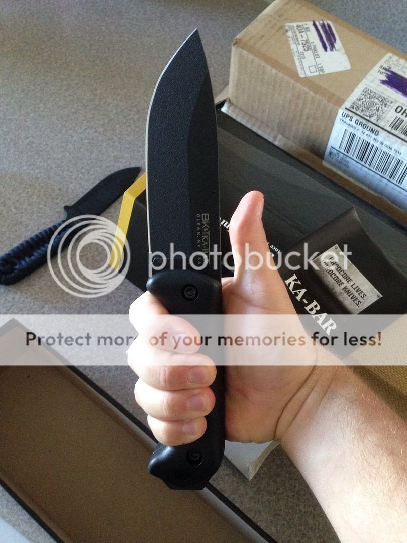

I heard from Customer Service, and a new bk2 will be forthcoming in the next few days. Truly remarkable service and professionalism from uncle E and Ka-Bar.
Customer and potential Beckerhead for life!
Hey Gents,
Take a looky-Lou at what the nice man in the brown clothes brought me from the nice people with the magic steel...
Wow, it looks even sharper than my old one.
Impressed doesn't begin to describe me right now...
When I got my first Becker, my 9, I said that I owed Ethan a steak dinner.
Well, that debt is now owed thrice over on my part.
I'm not used to customer service like this anywhere, courteous, professional, and prompt.

Even though my old one broke, deemed a poor heat treat issue, this thread should be all the nudge you need if you're on the fence with Becker/Ka-Bar.
I hope folks read this thread and buy at least a couple, or like cereal box toys, collect them all!
I know that my next several fixed blades WILL be Beckers.
I think this is all the advertisement a guy would need.
They'll really take care of a guy, even a dork like me who has so much to learn.
