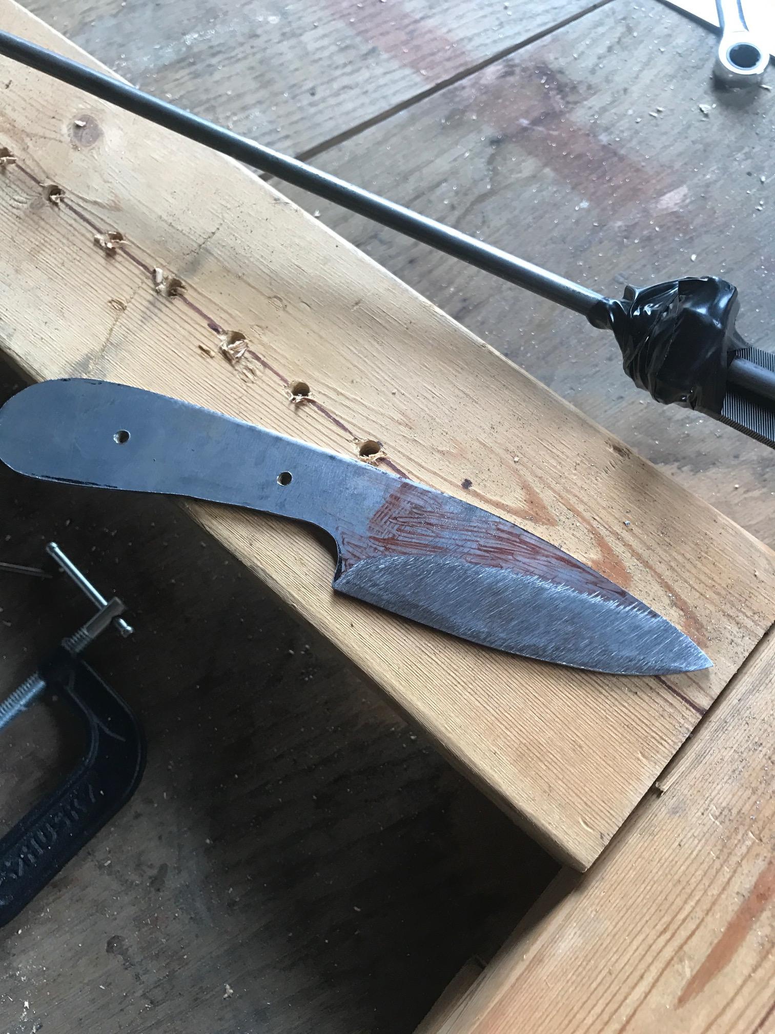

A few hours in. Lots of learning. Who knew that I didn't know how to properly use a hacksaw? Lots of sweat and even some blood into this one so far (wear gloves). Going to make a jig tomorrow for filing the bevel and also work more on cleaning up the profile. Any feedback is welcome.
See how your drew the top of your grind straight?
That grind line should follow the edge of the blade and curve with the blade.
As you file you will need to follow the edge to be successful and will drive yourself crazy trying to keep that straight. Follow the flow of the curve, then it will all come together much easier.
I'm assuming the jig will help with this. I'm considering just tapering the whole thing(flat gring I believe?).

Good start.
I would also suggest that you leave off the lanyard hole for now. It will add one more problem to your first build. Once you have the basics down, add the extras.

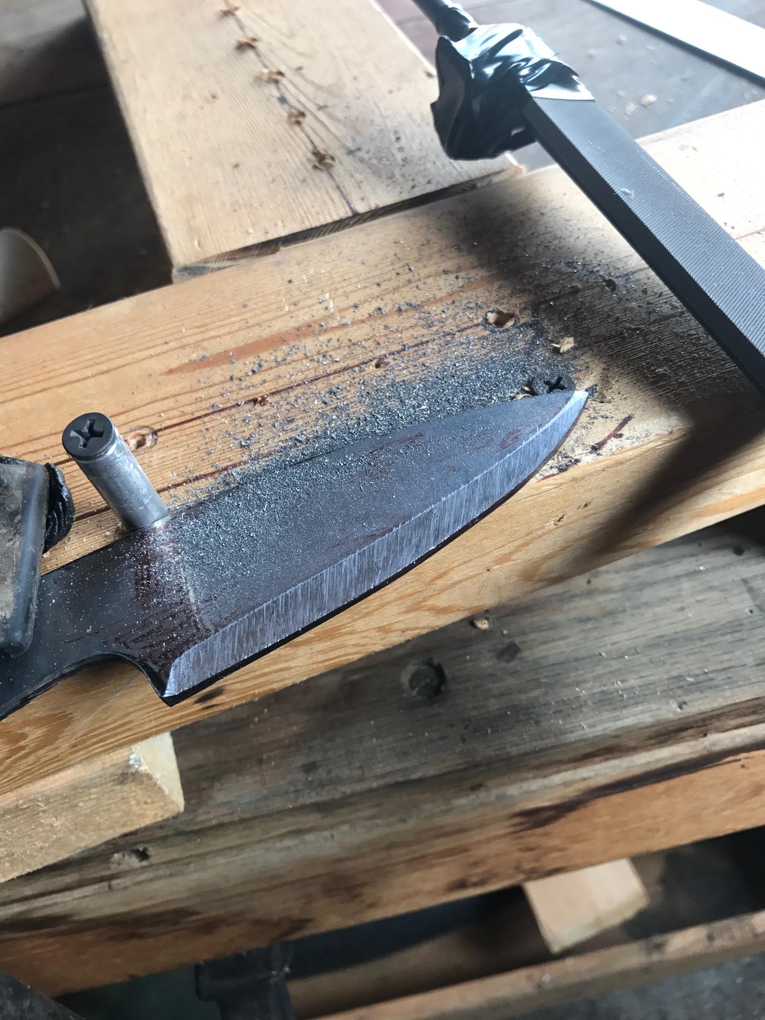

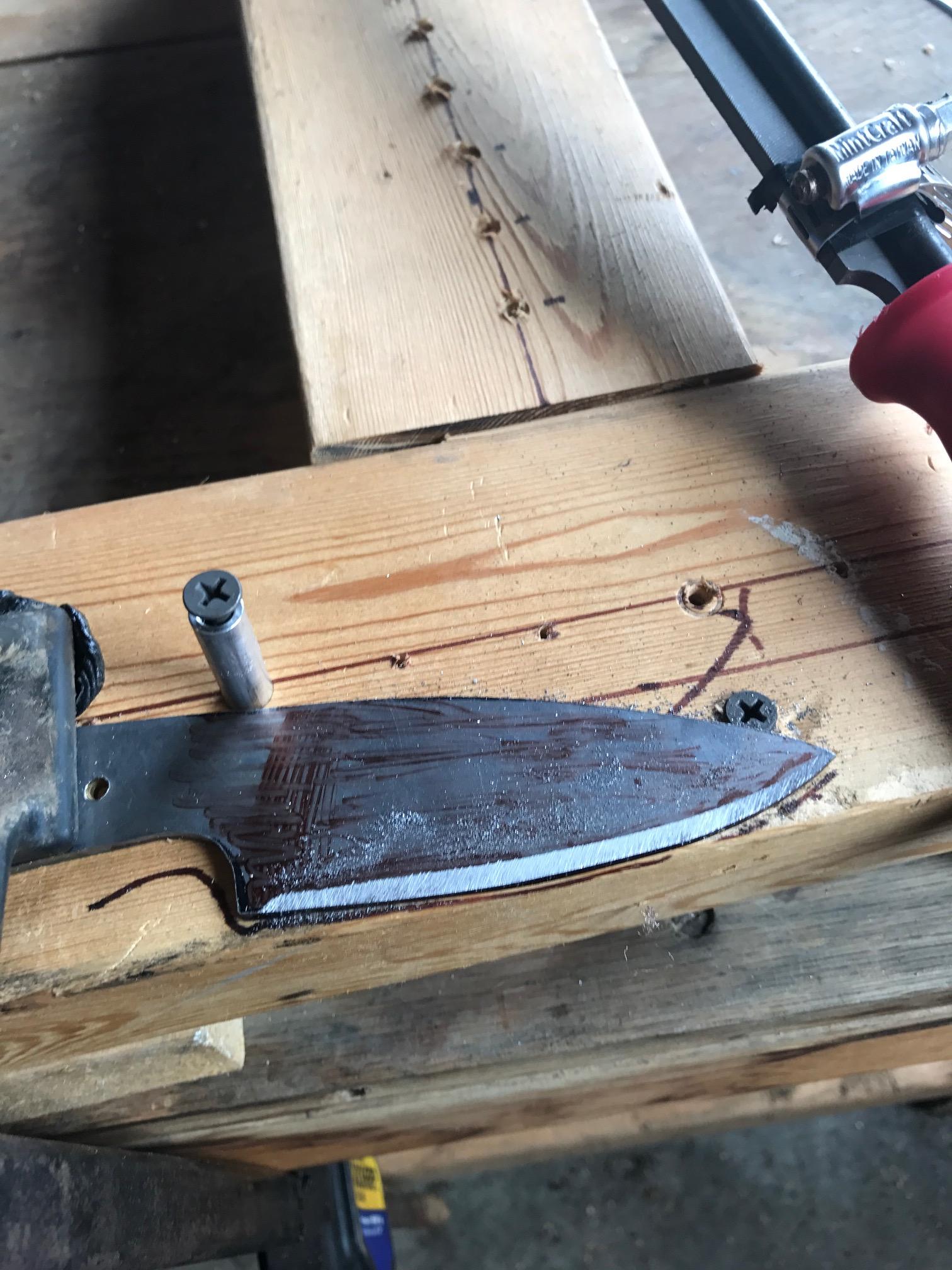

Day 2.
I spent the majority of today rearranging my garage and building a filing jig. I'm not really a handy person so this was an accomplishment. I am not completely impressed with it and v2 will be a lot better.
I'm also not impressed with my files. I bought a pack of the Husky files as that is all my hardware store had. I will be going out to get a Nicholson Bastard file probably tomorrow. The filing started out ok but after a while my file became so littered with chips that it is just scratching up the blade. I need to get one of those file brushes too.
Oh and the whole drill bit as an edge scribe thing...thumbs down. I hope I end up with an even bevel but at this point I wouldn't put money on it. One more thing I need to look into purchasing.
Definitely going to need a file card. On the next one start the plunge further forward on the blade. I seem to remember when I used a jig like that the plunge always seemed to end up further back than I planned.
I would also (on the next one) clamp the blade in a position so that when the file is against the bolt stop, it is in more of a vertical position. It is easier to work with a straight up an down plunge line as a beginner.

Thanks guys! I bought a file card yesterday and started using some sidewalk chalk on the file as well. It seemed to help some. It's still not moving enough metal. I didn't open the Nicholson that I bought yesterday and will be returning it and seeing if I can find it a double cut bastard file somewhere.
I have noticed that I'm getting more of a convex edge than a flat grind. I was doing some reading and I think it's because I'm seesawing the file a little bit. Going to try to work that out as well.
Try draw filing after a bit. That will smooth out the high spots quickly. I have and used a course double cut 10" bastard file when I did my first few on the filing jig like you have. They work very well for quick removal.
