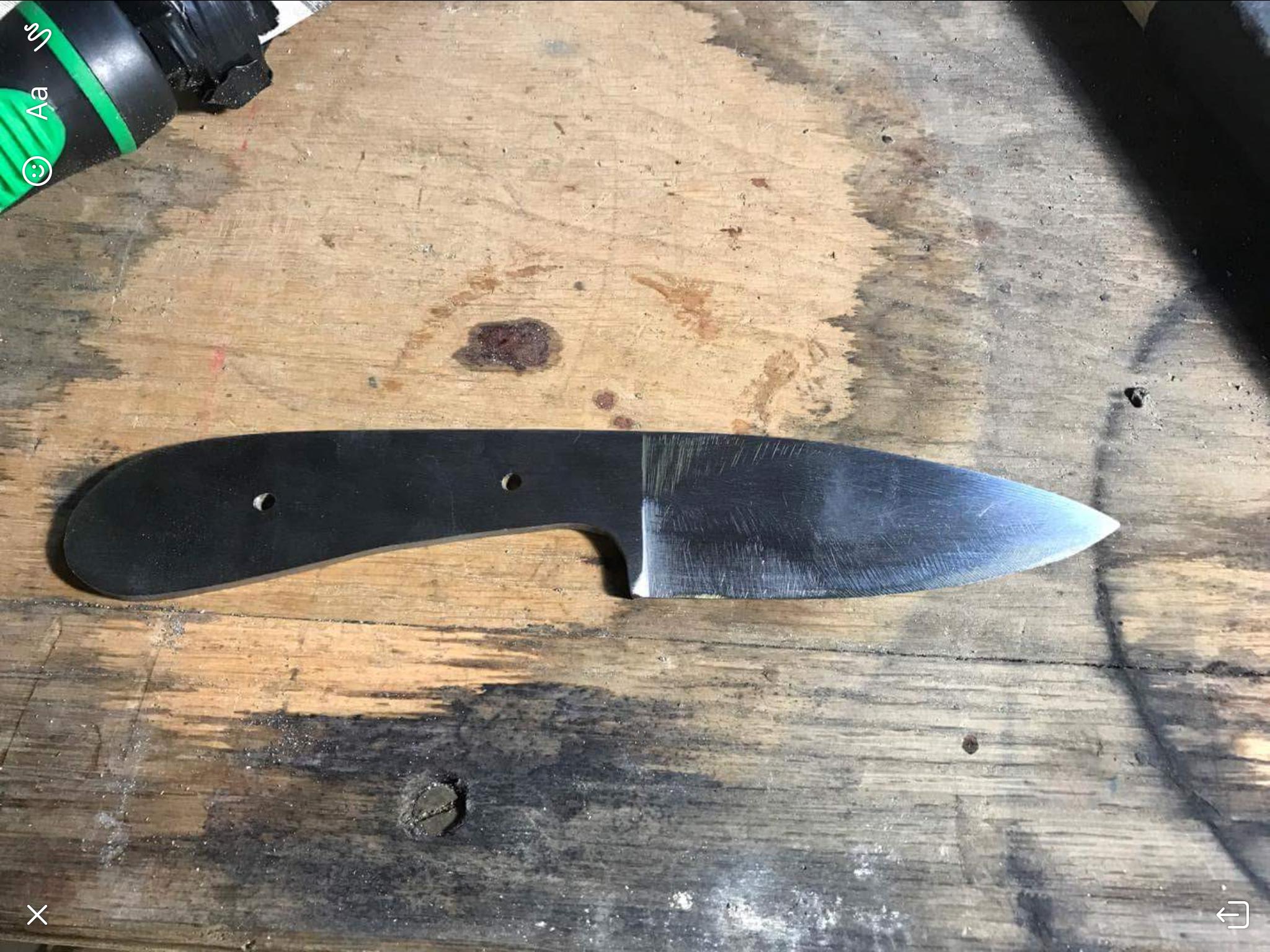

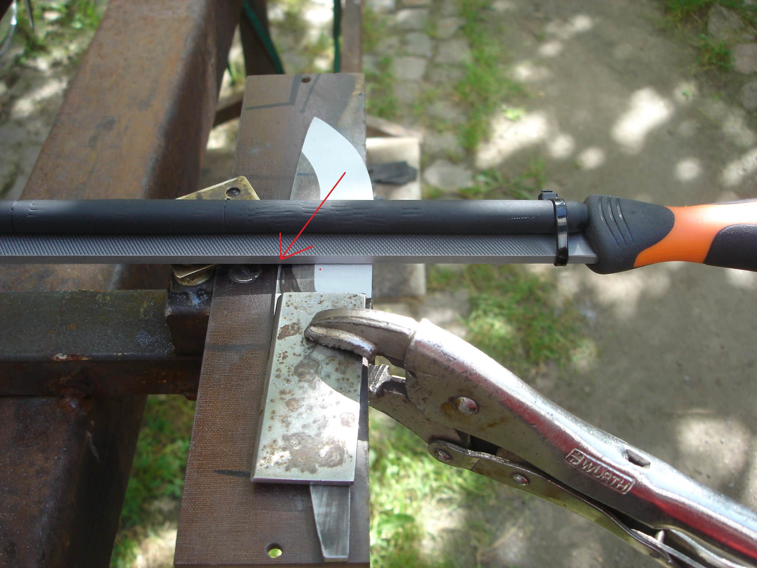

It was not the tools . . . . but how you use them ;) I do not really understand how it might turn out like this . File jig is so simple to use . First mark the central line / where will be edge / Start grind with large angle from both sides until you reaches the required thickness on edge for HT . Then lower the angle and continue to grind until you reach the height of bevel you want .If you reaches the edge while you grind before you get imagined height of bevel change the grinding angle ... that's it .Before you change grinding angle be sure you grind both sides on previous angle .On the picture looks like you often change grinding angle or rod you use for file is too thin or too long and flex ??
That was after I had done some sanding to the blade as well.
My bevel is not good because I didn't know what I was doing when i started and I rocked the file creating a convex edge. I have been able to straighten it up some but it is not going to be perfect. I have though about tossingthis one and starting over but I want to continue through the process because it is a learning experience and I would rather mess up heat treating or putting a handle on this one than the next one that will likely look much prettier.

I changed the bevel angle on this knife about 4 times so I don't know if flattening it out completely is even possible. I'm not too concerned about the finish at this point so I will probably heat treat soon.

For the plunge line stop I'm thinking of dropping a carbide drill rod into a bearing so it doesn't wear down when the file hits it, and I'm thinking by spinning instead of providing resistance it'll give a smoother plunge line. I suppose I could do it with a screw too but the drill rod should be pretty true.
My problem was that the screw slowly bent so the plunge line moved. I'm just going to clamp a piece of bar stock on top of the knife to use as a guide.
Go with a bigger screw. A lag screw. It will be easier than a bar.

I have and use two file , one for one side of knive . They have one side without teeth ......
To get smooth , symmetrical plunge line and all grind line from booth side ..when you flip blade to grind other side is most important to PLACE the blank in exactly the same position ...
I have that part already, but I read that rounding that edge makes for an "easier" plunge. But steel is pretty cheap, I suppose practicing the form and alignment right now will pay off in the long run.
