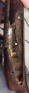

It arrived! My stupid phone died so I can't take a picture. The lock itself looks pretty old but some of the screws look modern. Other screws look old.
The cock won't move at all, though. Some WD40 might loosen it up. The flash pan snapped off too, but nothing a little solder couldn't fix.
Edit: WD40 did the trick, the cock moves now. But it doesn't lock no matter how far back I pull it. Even pulled fully back the seer is still covered by the cock so it doesn't pop out. I'm beginning to think this lock was put together from parts that don't quite match up, which would explain the modern screws.

Honestly I doubt it'll ever shoot without the risk of flying apart.. And I bought it with that in mind, as a wall hanger that would be cool to shoot if it was possible. It just doesn't seem like these parts were meant to work together. The cock doesn't fit the lock, the lock doesn't fit the stock, and the stock doesn't fit the barrel!

Never mind, the mainspring is held where it is with a pin, I wouldn't be able to move the spring even if I could get the screw out.
Edit: I've been messing around with the barrel and that tongue does "mate" pretty well with the stock if you push down on it. I think it would stay in place if I put a screw through it.

I've been poking at prodding at this thing a bit more and I definitely think it'll take the talents of Mr. Bookie to get the lock to function. When I pull the cock all the way back, the tumbler's rotated so the red line in the picture below is parallel to the mainspring, so I think that's about as far back as it's supposed to go. But even at that point, the cock is still completely covering the seer, but enough to keep it from popping out and engaging the lock. If I really lean on the thing with my whole body I can get the cock to clear about 2/3rds of the seer but I'm afraid to push any harder on it.
There's also a hole in the tumbler that doesn't seem to serve any purpose, pointed to by a red arrow. Any idea what it might be for? (edit: Never mind, it appears to be for the pan cover, which this doesn't have. )
Edit: Okay, so I mounted the lock back in the stock and I was able to get some extra leverage and pull the cock all the way back. The seer still didn't pop out and engage the cock.
It's fully "at rest" here, not pushing against the spring at all, yet it's not sticking out.
