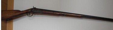

Second boom stick! Seller says it's a 18th century military musket converted in the 18th century to a hunting musket. I don't know if that means it started its life as a flintlock and was converted to percussion or what.
Looks nice! Yes, it's a converted flinter to percussion of which I believe the conversion took place in the mid-1840s. Regardless when, it was initially manufactured in the 19th century and I suspect in Belgium or perhaps Austria. The US government purchased many old arms from Europe and some were converted to percussion here, but most had been converted in the home country in order to fulfill a fat contract and unload a bunch of undesirable/obsolete weapons. The arms were sound for the most part and pretty well maintained, so your purchase ought to be a good, solid 200 dollar investment and make a great shot-gun! Lucky you.

image.jpgSecond boom stick arrived. Lock is a little stiff but functions perfectly. Only mark I can see on it is the guard over the trigger. A small A over a W.
W with a crown over it could be Prussian or English, not sure about this one...
I've been messing around with my new toy, it seems super sturdy. The lock engages at half and full cock and fired from full cock. I dropped the ramrod down the barrel and it seems to hit the bottom, so nothing's stuck in the barrel. The nipple is a bit corroded but it looks like it's still structurally sound and unobstructed
I shined a flashlight down the barrel, the inside is a little pitted but no more so than the outside. Is that a problem? Does it need to be completely smooth? Other than that I think the thing is in shooting condition. Oddly there are no proof marks or armory marks anywhere on the thing except on the trigger guard. I posted photos on another site and somebody though it might be an Italian copy of French style musket.
