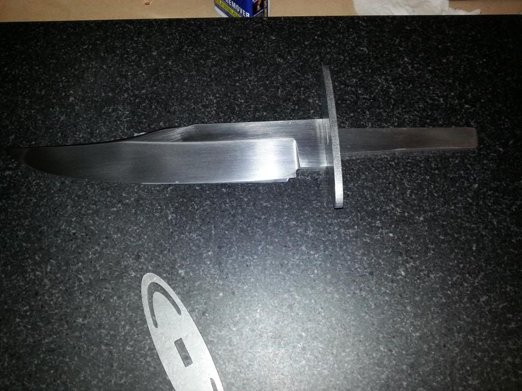

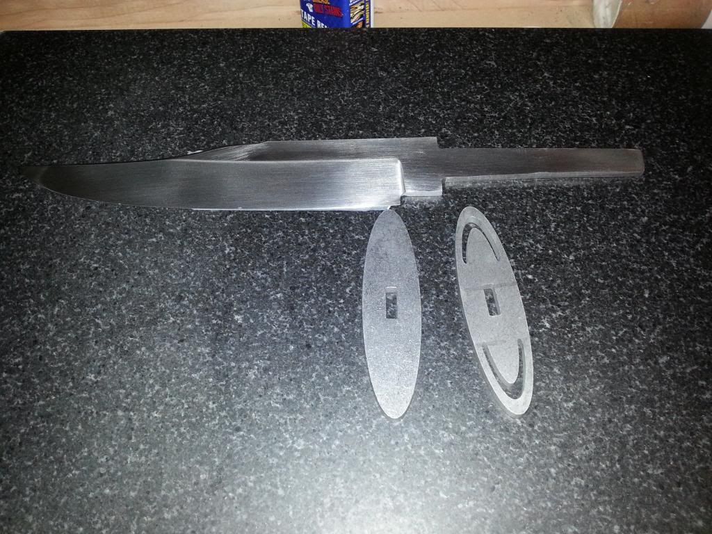

So speaking of guards I was a tad slow on ordering them but they came today. I ordered a basic one in case I want to attempt bending it (how I'll accomplish this accurately I don't know since I really have nothing to mold it around). And one kinda decorative looking guy should I decide to not be that ambitious and just put a flat guard on this thing. So I'm guessing the trick to this is filing out the guard to fit around the tang, then square everything up? Progress wise I'm still sanding I have one side done to 320 just about ready for 400 then going to tape that side and hit the other one. I don't know why I'm not doing both sides equally in the past I would. The whole blade got whatever grit I was at. Hoping the sanding will be done by the end of the week then it's onto I guess fitting the guard?? As far as the handle I don't know if I mentioned it or not but it's going to be a block of dyed blue curly maple. If my plan comes together it should look pretty sexy with the blue stingray skin I want to put on the sheath.
Now I'm far from an expert and maybe I was thinking they were going to be a bit smaller but do these things look too huge for this knife? To me at least, they look a bit on the thick side and stick out way too wide am I mistaken on this? I laid one on the blade to get an idea. What say ye?

Those guards are made to curve.
Use a broken baseball bat, or a piece of pipe, and a hammer to curve it. Mark where the guard sits against the blade, and make sure you don't curve any of that area. I have seen people bolt two plates of 1/4" steel, that are the width of the blade, through the guard slot to assure it does not bend there. The best way is to use a torch and heat the part of the guard you want to bend red, hammer to shape on the bat/pipe, re-heat, shape more ,etc. You can control where it bends the most by the amount of heat applied .

IMHO, those guards are way too big in every direction. You'd be far better off to start from raw stock...

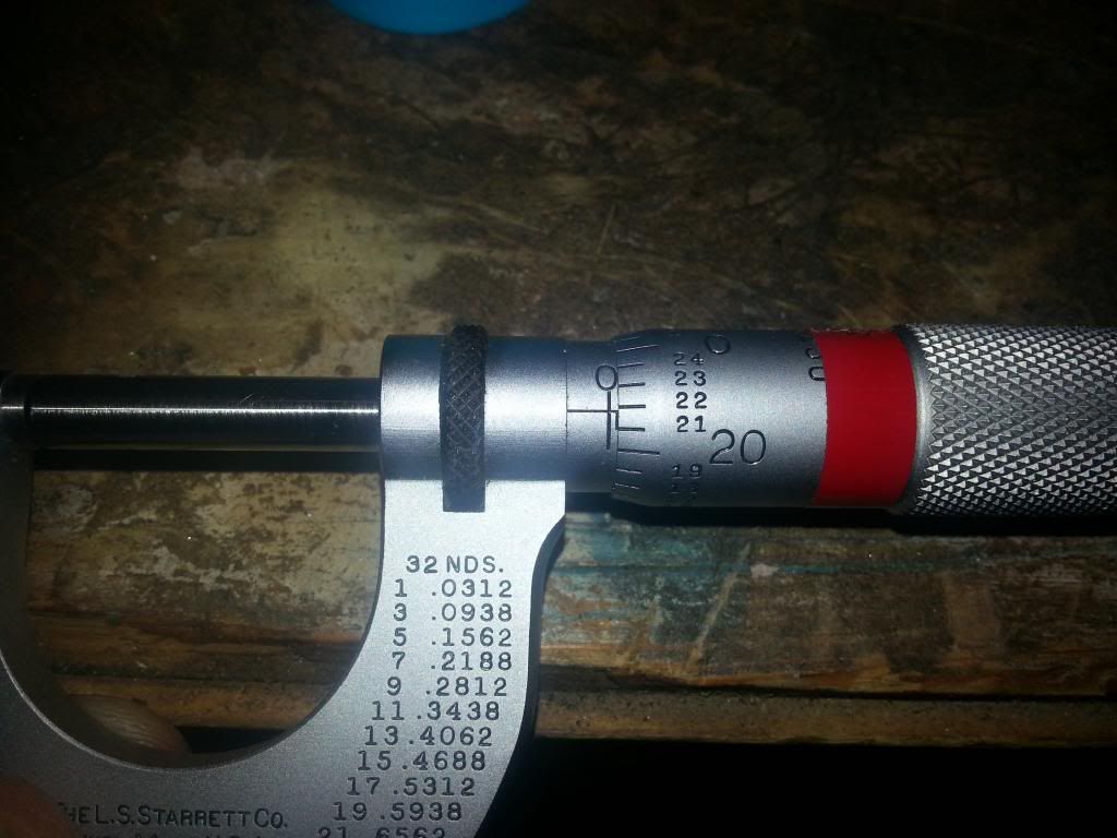

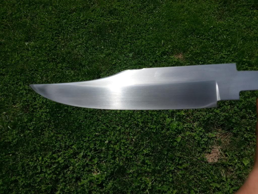

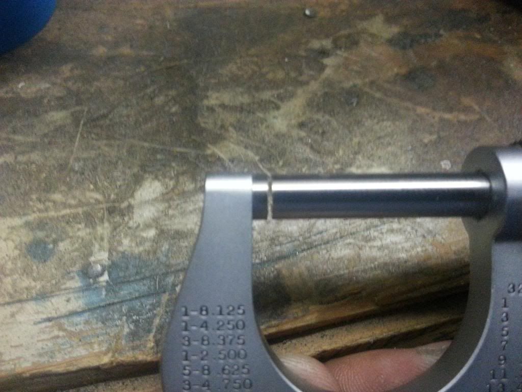

Okay been a bit of time but I THINK it's ready for HT. I have everything sanded to 400 there are only a few areas of concern unless you guys happen to see something else. First off, I'm not sure if the edge is too thin it's stainless ATS-34. A while back I picked up a Starrett micrometer and a Mitutoyo height gauge up off a guy for $20 (I'm still pretty damn proud of that :D) unfortunately I don't really know how to read the damn thing as it's not digital and I don't have much experience with using anything that is a Vernier scale :o. But here is what the thing reads I tried best I could to get the edge centered halfway between the caliper. I'm just wondering if it's too thin for HT as the ones I've done in the past have had a thicker edge.
This is the opening of it probably a moot point for anyone who knows how to read the damn thing LOL.

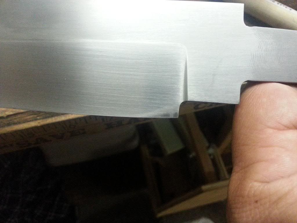

This is my other area of concern. I know when I put the edge on it, I MIGHT eliminate this spot, or I'm wondering if I should just put the edge on the grinder or hit it with a file to eliminate some of this, or not worry about it as it should disappear with the edge. For as much sanding as I did on the surface plate this area never really got touched.

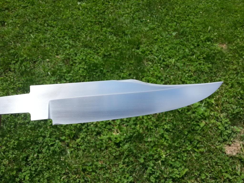

And here is the full Monty of her. I missed my date of when I wanted this to be built it was a few days ago so it's a definite belated present but the good news is I can take my time and not try and bang it out for the sake of meeting a deadline. You can really see that ugly spot in the first pic.

The blade looks good. Your micrometer says the blade is about .0218" at the edge. That is the upper side of the thickness you want for a stainless steel at HT. Since this is a Bowie, not a slicer, that thickness is OK. I usually go to about .100-.015" on my kitchen blades.
That spot at the plunge may be an artifact of my profiling the plunge. Another reason that appears is over filing on the plunges. In either case, the edge was ground/filed a bit thin there. I would leave it as is, and it will disappear in post-HT sanding and sharpening.

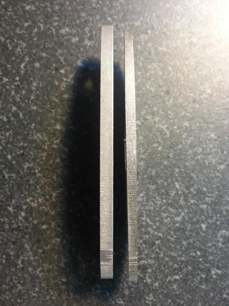

Okay after a long drawn out process thanks to the USPS I finally got the blade back a couple weeks ago and get back in the groove a bit. Last night got it sanded to 320 to get all it all shiny again from the HT. Per Nicks instructions I'm probably going to take it a little further than his instructions and go to 600 before I start fitting the guard. In the meantime I've decided to attempt going with one of those guards I showed. I have one of two options: If I want to just keep it an oval guard I can just keep grinding the thing down to make it smaller and retain its shape or I can go for gold and attempt to make it an "S" guard. I'm opting to go for gold what I did since it's too thick IMO I decided to spend some time on the belt grinder thinning it down a bit. I have a piece of 3/4" galvanized pipe I can try using to bend it around unless anyone has any other suggestions I'm open. I want to sand it down a bit more to maybe 220 or 320 before I attempt bending it this way I can get the deep scratches out easier on a flat surface.....Then again I'm sure whacking it with a hammer is going to require some decent sanding too but whatever.
Here is a pic comparing the difference in thickness to what it was to where it is. Since I have to guards the same thickness it served as a decent reference. Do you guys think I should go a bit thinner on it or is this good? The sanded down one is on the right, kinda hard to tell in the pic but more noticeable in person.

You can probably bend it now. It will end up thinner after clean up.
There are two ways to do the bend...cold or hot. I would go with hot.
Get a 6" piece of solid 1" steel rod, not galvanized pipe. Drill two 1/4" holes near the ends. Screw the rod down to a piece of 4X4 to make it rigid. If you tied to hammer against the rod in a vise or on the bench, it would jump around more than a 14 year old girl at a Justin Beeber concert.
Heat one end of the guard to dull red, and shape on the rod. Take additional heats if needed. Go slow, and remember, you can bend it more easier than you can un-bend it. Then shape the other end. You can do fine tuning of the shape cold from here. When the guard is shaped as you wish, make sure you flatten the center part so it will fit the blade right.
Is it better/easier to fit the guard over the blade before bending it out does it not matter one way or another?
Long guards like that hamper the way the knife can be used, and like to get bent while their at it. From a strictly visual standpoint, having the guard drop down below the edge gives it an "off" appearance, though I know there are plenty of examples of just that. Jutting high over the spine gets in the way of moving the thumb forward to the spine for a saber grip which can come in handy.
Were I to go that route, I'd want thick stock, not thin. I'd start at something like .250" at the tang and use files to taper the stock so it can have a thin appearance from the side. Maybe even some decorative filework to brighten up what is going to be billboard in the middle of the whole.
That little bit of "missed" steel at the ricasso looks to me to be the perfect place for a spanish notch. It is a bowie, after all!
