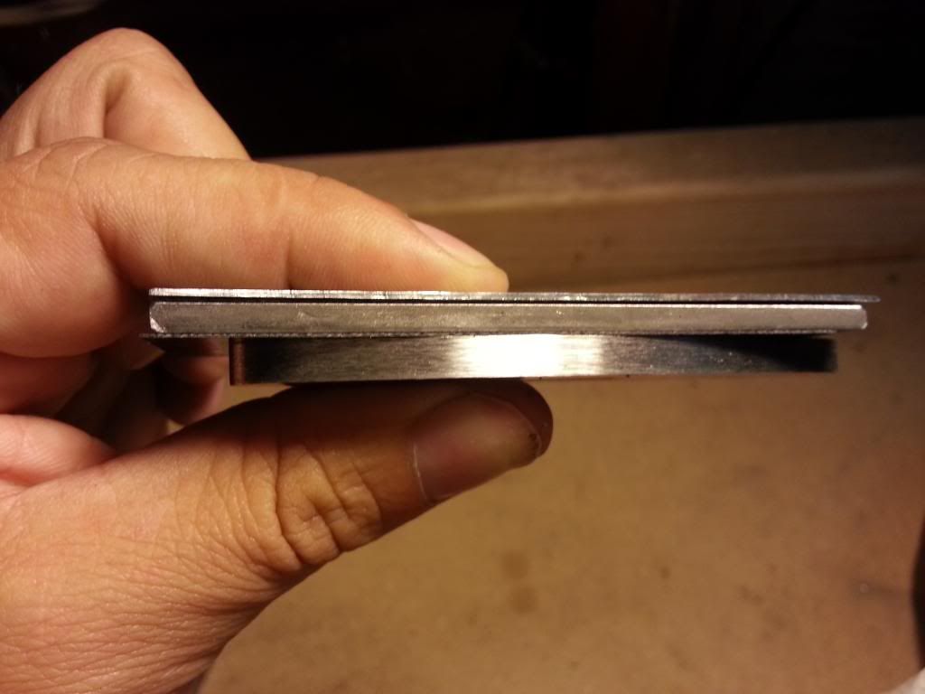

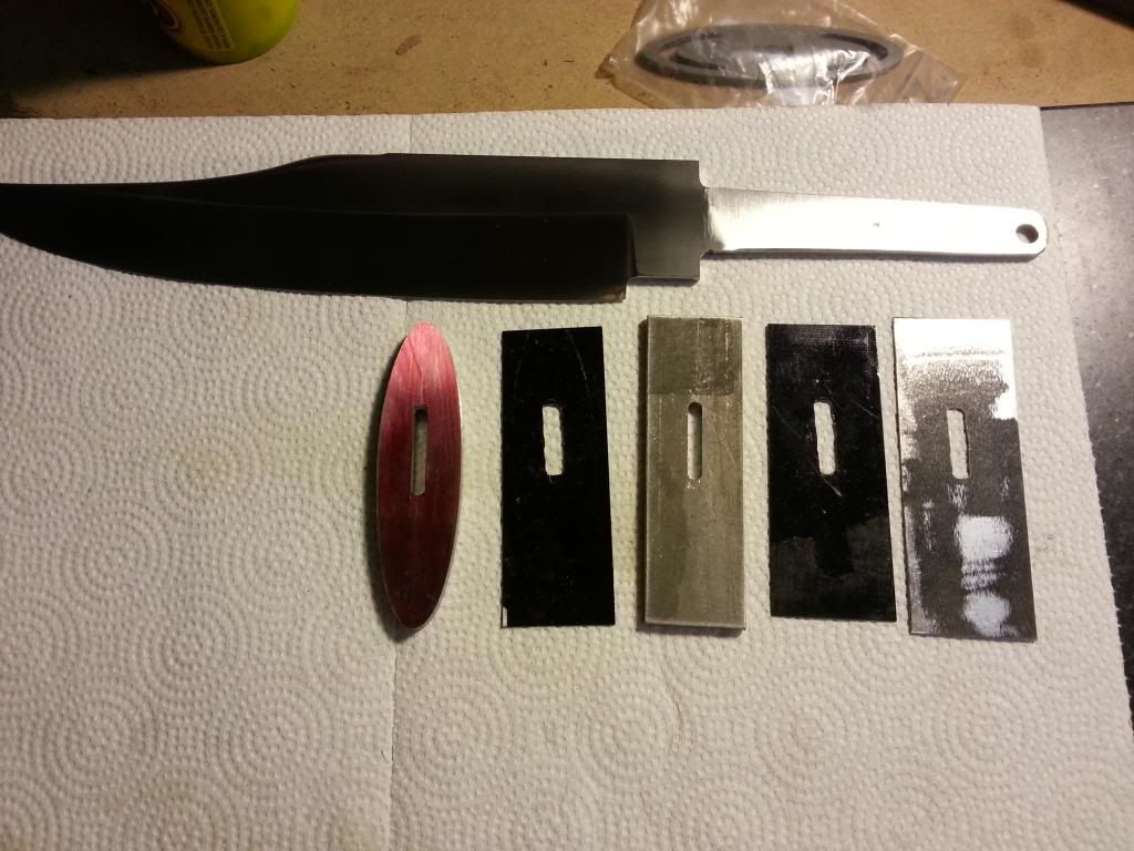

Here are some pics of what got done, instead of doing just a flat guard she should look a lot sexier thicker, shaped and with some black spacers in it.
Here's all the pieces laid out thickest to thinnest with black spacers in between:
And this is what it will roughly look like sandwiched together.
All said and done (assuming I don't screw it up) I should look a lot better than I even anticipated. I just wanted to give a big thank you to Shawn for offering to help and having me up to his shop so he could put his foot to my ass and get me over this hump I can't say thank you enough :thumbup:

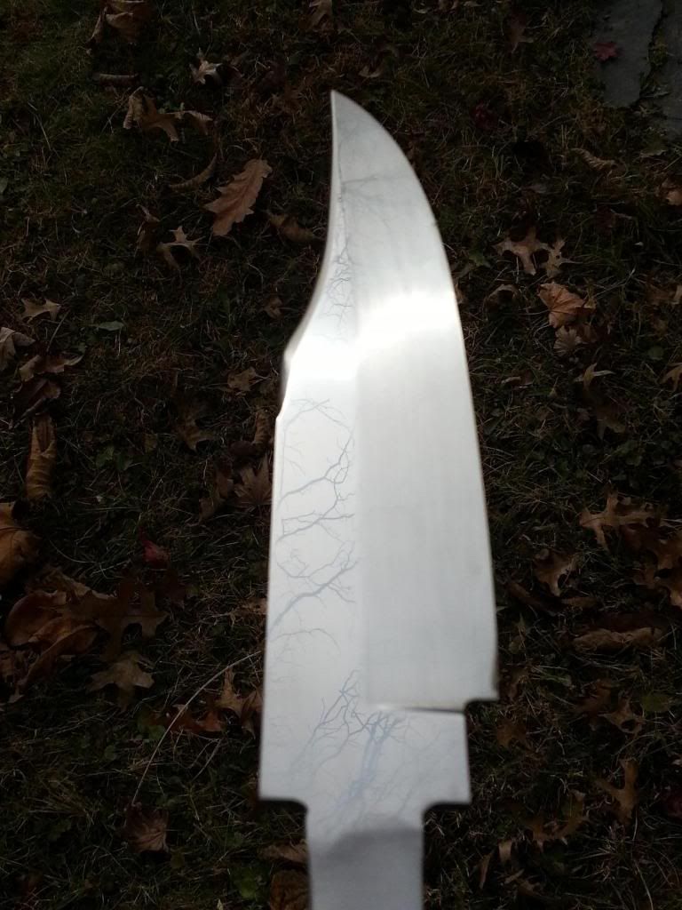

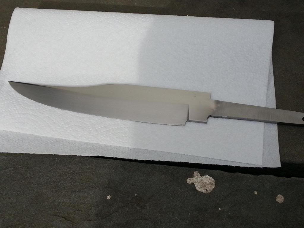

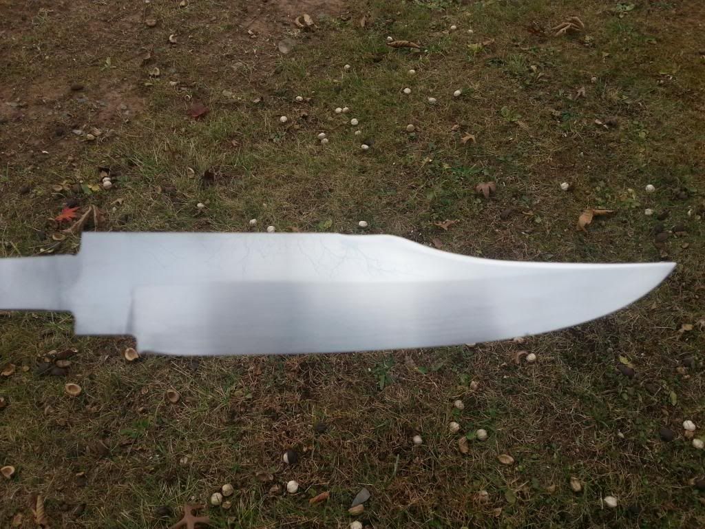

I FINALLY managed to get some decent shop time in a bit the other day and a few hours tonight. I'll post pics tomorrow but tried something different as I have been doing the hand sanding. And by different I mean something I never really thought about doing but sure it's been done before. I hand rubbed the bevel to 800 grit, took the flat to 1500, and polished the clip up to 8000. This is all on one side mind you I still need to do the other side. Hopefully I'll be able to tackle that a bit more soon and get the handle on this thing and move towards completion. I'm so far out on this maybe make it a St Patrick's day present or something hopefully :D. I'll try and post up pics tomorrow when I have some good light.
I was just wondering how it was coming along. Glad you are still working on it. I look forward to the photos.
Okay pics or it didn't happen right?

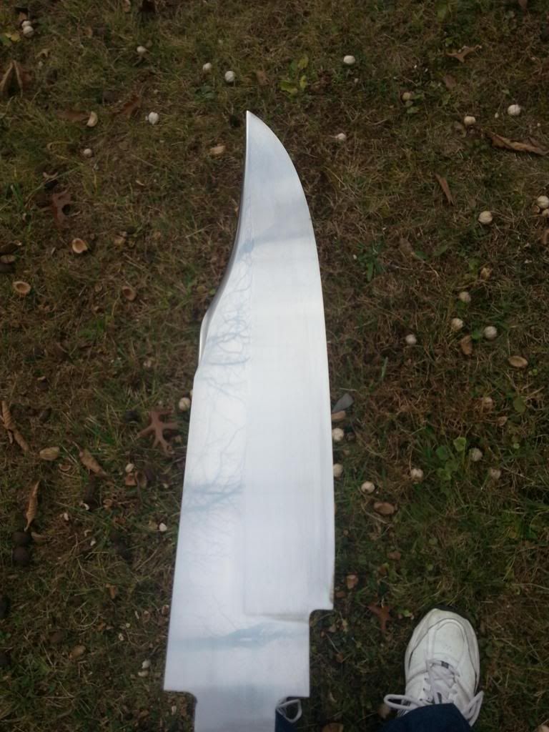

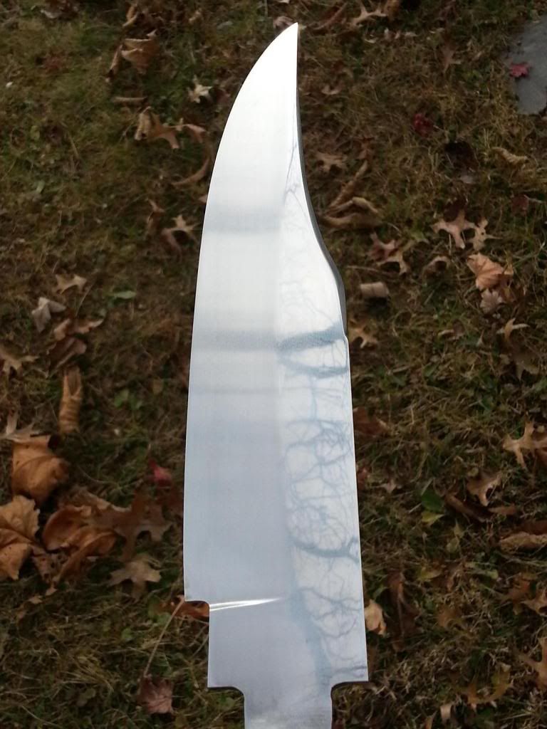

My phone seems to want to take very clear pics of everything except the blade but here is what we got out of it.
Maybe if I set it down somewhere and zoom in a bit on it would help but I'm pretty happy with how the finish looks in person
Okay I think if I don't move on I'll obsess over this thing as it is after finishing up the other side I decided to take the polishing cloths out and brought the flats up to 4000. I think it's time to get the handle and guard fitted on this thing soon and get er done. Handle work is probably my favorite part of the process so I'm pretty stoked about getting on to that and working on my first guard. I was short on time so ran outside and just snapped a few pics.

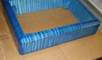

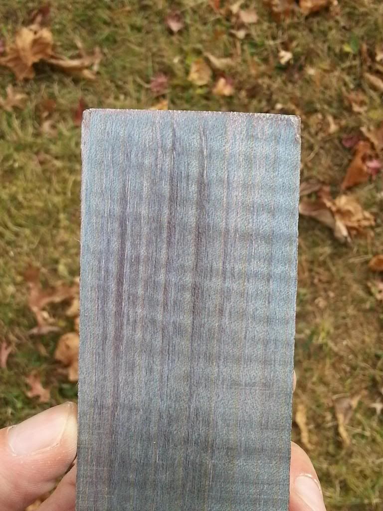

Also decided to just clean up the back part of the block I have for this (curly maple) when we drilled the tang out the dust was pretty blue. I'm seeing what looks like a fair amount of brown in there I'm wondering if that will change a bit. I've seen quite a few pictures of some blue curly maple and it was BLUE I;m just hoping that brownish lines will somehow go away?

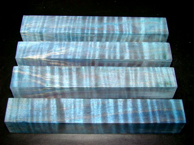

I'm kinda hoping for a look along these lines:

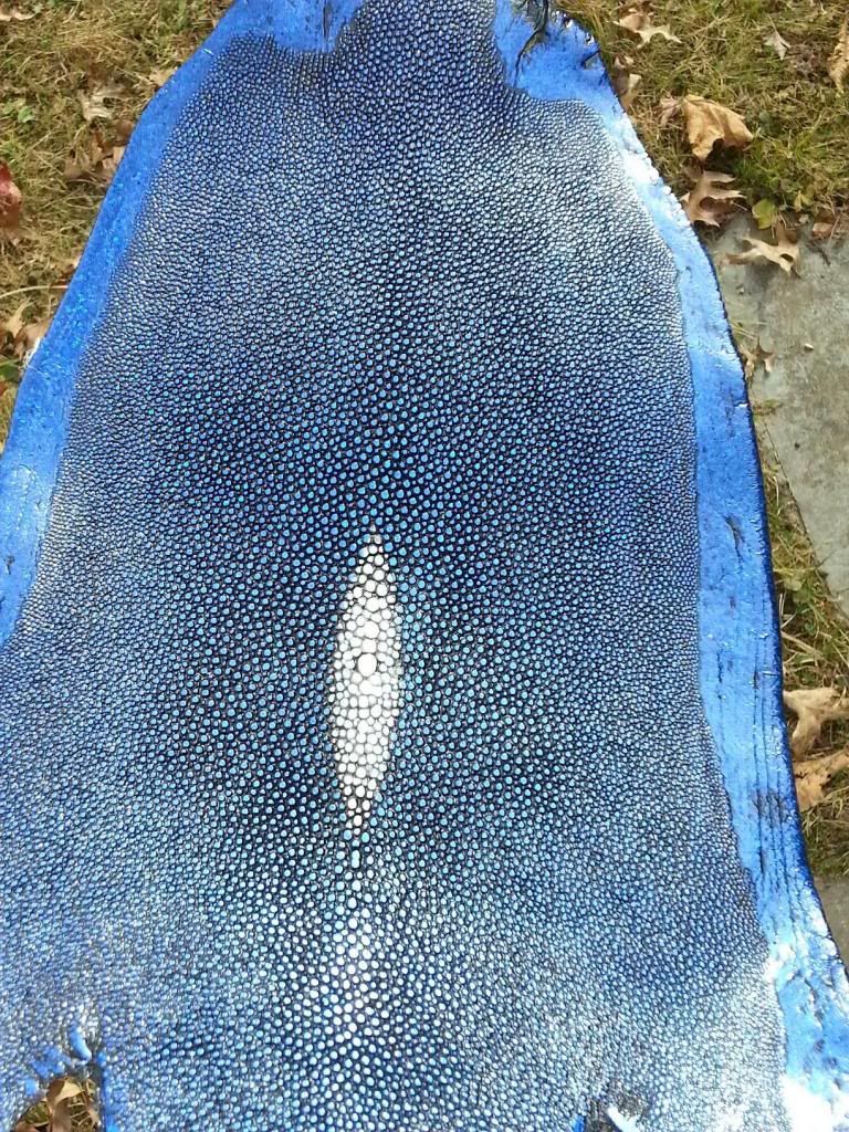

Also here is the piece of stingray that I'm planning on using for the sheath inlay. The pics really do it no justice this thing changes like crazy as you move it around.
That batch of blue has a sort of UV blue glow to it. It isn't the in-your-face looking neon blue in some dyed wood. When sanded down smooth and buffed it should have a nice blue tone. It will be much more distinct than the rough block looks.
