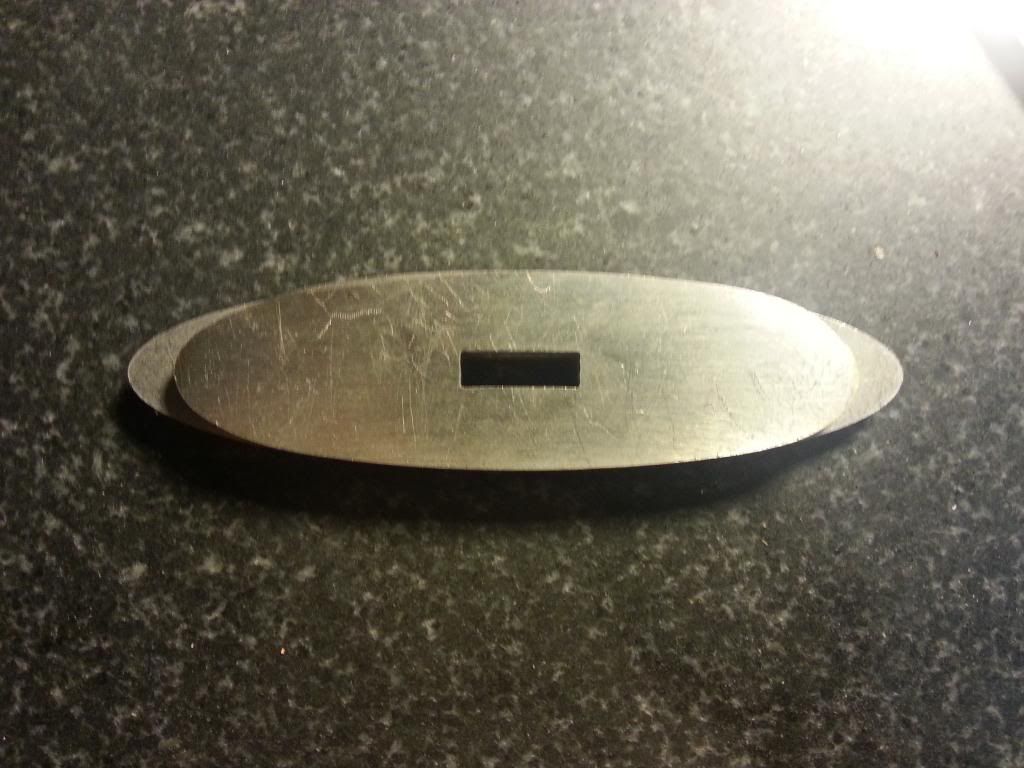

So decided to monkey with the guard a bit more to get an idea what it would look like bent. I took a piece of paper and cut it out the same size as the guard and bent it the way I was thinking and put it up against the knife and it still looked too big for what I'd like to see. So finally something went off in my head that said "hey dumbass, why don't you see if that metal cutting bandsaw and little grinder you have that are actually designed specifically to cut and shape steel can be applied in this situation?" Son of a gun! Wouldn't you know they actually do? :o So I knocked down the guard a bit and I still have a little shaping to do it make it fairly equal looking on both ends of the oval, and if I can't I can always modify it a bit with those fancy machines I mentioned earlier.
So here is the other guard that was the same size that I put underneath to show how much I took off.
Here is a layout of it on the knife. Possibly still a tad long but I'll do another mock up and see if I need to make it smaller

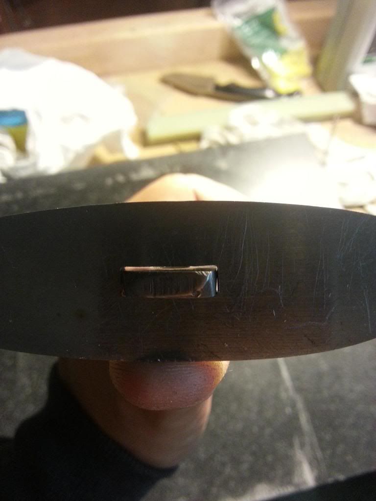

Okay this thing is likely going to wind up being a Christmas present at this rate. Unfortunately I haven't been able to get much shop time in but I'm getting in what I can. I got the whole blade sanded to 400. (I opted to go with Nick's advice and sand it to 400 at least before fitting the guard). Now onto this guard situation. Per Stacy I tried hammering this thing to the point I took a mini sledge to it and whacked it pretty good (which it laughed at) and even tried putting it in my vice and squeezing it together (without trying to kill it) and it still did nothing. So I'm not sure if I should just use the thing as a template and cut a guard out of some 5/32 ATS-34 I have or attempt closing the gap on this.
In the meantime I bout myself a pair of calipers and the end of the tang is definitely wider than where it will sit. So I need some input on two things guys.
1. Do I go monkey with this thing or try making one out of the 5/32 stock?
2. How do I go about tapering the tang? It seems most folks like to make a little jig for it with a block of wood, put a small nail in it and drill a small hole in the tang to sit in and put it on the belt grinder. Is this the only way or are there other tricks I should know about on this.
I'm putting up a picture of the tang/guard so you guys can get an idea of what I'm working with here and mind you this is currently a bit thicker than near the ricasso. To me there seems like an awful lot of daylight already.
I don't think that gap will close very easily. I taper the tang on a belt sander, much like doing a distal taper.
That gap wont close much,and if it did there would be gaps at the corners .As far as tapering goes, you dont need anything radical,just a teensy,weensy bit.Often times there is a burr or mushrooming at the end of the tang from being worked on,and that is all that needs cleaning up. Here is what I have done when using brass and had a gap problem: Lay the guard down on your anvil with the blade side up and a peice of paper under it to protect the other side.Hammer it all over with a ball-peen hammer ,being carefull not to land a blow in the slot too much,but trying to mushroom the metal a little bit at the edges of the slot .This will give a hammertone finnish on the front of the guard and narrow the slot some.
The gap is certainly too big for a show piece, but if you use JB Weld to set the guard, it will be closed up. Since this is a shelf queen, I think that is a viable option. There are other ways of closing the gap, but I'll give them later.
The tangs will almost always end up thicker at the end than the middle if you don't taper them to start with. The best time is when doing the profiling and basic beveling. Just grind it backwards from the ricasso area toward the tang end. Taper it to about half as tick as the ricasso. By the time the blade is filed and sanded smooth and flat, that will still leave a slight taper.
If you need to do it after the blade is done, tape the blade up well to avoid accidents happening to the smooth bevels. Just go to the belt sander and grind a taper that is continuous and is at least 15-25% thinner at the end. It should also have a slight taper in the height. The last 1/2" at the ricasso shoulders is all that needs to be neat and pretty, so don't waste much time beyond a coarse belt.
Now for closing a guard gap that is just too big to live with:
1) Hammer it from the sides to close up the slot a bit and re-fit things. This often works, but will require a good bit of clean-up on the guard edges where the hammer was hitting.
2) Use a smoothly sanded (and preferably polished) ball peen hammer to peen all around the slot from both sides. This will displace the metal and close up the slot. You can either peen the whole guard and leave the hammer-tone finish, or file it smooth again. Most folks go for the hammer finish.
3) Make an escutcheon for the front of the guard. This is called a seppa in Japanese. It is nothing more than a thin decorative washer or shaped sub-guard to cover the actual slot. This is not all that uncommon on a bowie knife. I like to make them as an elongated diamond, or an fluted oval. Try and make the shape somewhat fit with the guard shape. Copper works well, or use the same color material as the guard for a less noticeable cover. I have also made them to be just slightly larger that the actual blade, where they look like a 45° bevel coming off the blade toward the guard. These only stuck out about 1/8" past the blade, and were rectangular in shape.
