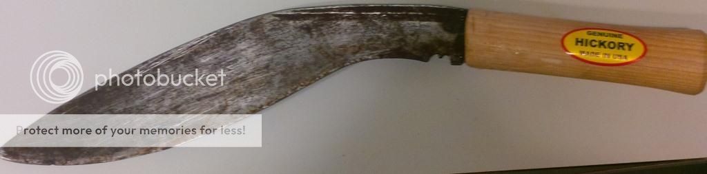

Just a thought which came to my mind while dropping one of my kids in preschool.
Wood recedes sometimes (dry) leaving a gap between wood and epoxy. (Epoxy will probably stick better to the metal tang which tends not to shrink)
No if there's a gap the whole block of epoxy will just be able to slide out.
How to avoid that? Have the cavity in the handle have a larger diameter than the opening of said hole. This way the epoxy slab holding the tang will always be bigger than the opening and can never come out. It should still be safe even if a gap develops and wiggling starts.
Only disadvantage if you ever have to do Rehandling again It will have to be somewhat destructive.
