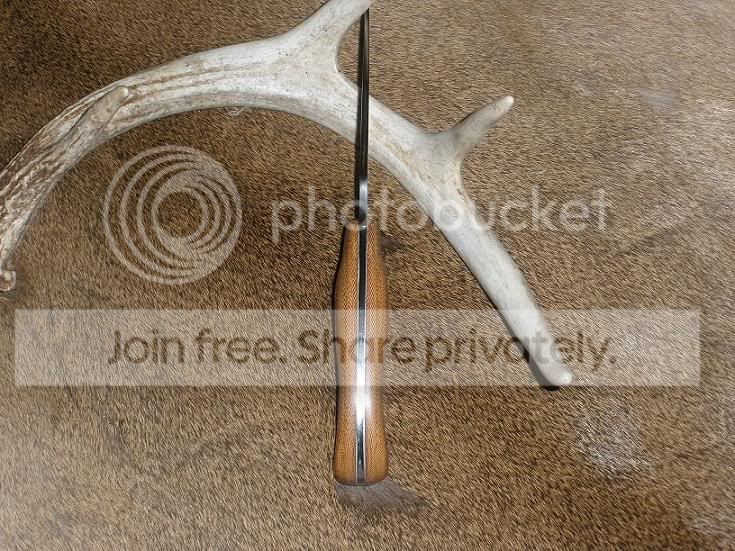

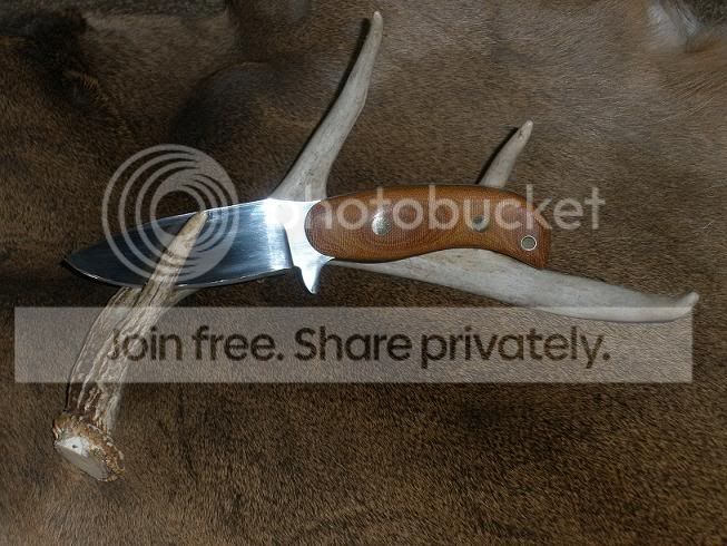

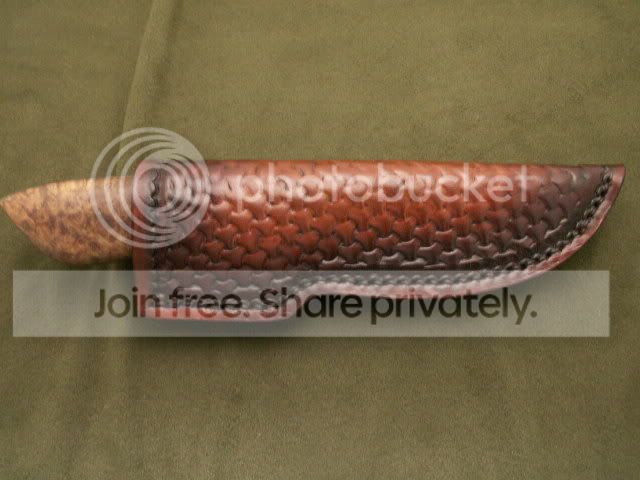

My first knife design. Critiques and Comments welcome
So tonight I took a fresh piece of 120 grit paper to a nice 800 grit hand rubbed finish :(. I know I''m not the first person to do this but if any people who are thinking about making a knife are reading this are curious what that's like. The feeling of doing that falls somewhere between putting together a 1000 piece jigsaw puzzle then ripping it apart the minute you finish. And bringing the hottest looking girl you've even seen back to your place and as you're rounding the bases you find out she's actually a man.

Wish I could see outside link posted pics on government computers. I always have to wait till the next morning to see the posts at home. Anyways nice knife! You were talking about being obsessive with your finish? Wait till you get to the point that you try to make all of the micarta rings look exactly the same on both sides! That sucks sometimes.

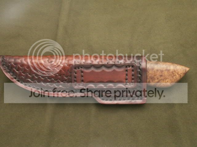

Sweet knife! just a suggestion, I went to the leatherworker.net forum and THAT place has EVERY SINGLE BIT of sheath making info and sheath makers -full time ones too- so you can get it all figured out. I would say the forum is 50 50 sheath and gunleather makers. Chuck Burrows posts both here and over at leatherworker.net, that guy makes some super sick leather creations.
I am cheap, I use tin snips to cut my leather, using the xacto takes too long cause you have to go back over it again and again till it goes through. At the minimum you are gonna need stitch needles, 3 cord waxed thread, a diamond punch for the holes, an overstitch wheel (makes dimples so the holes are evenly spaced when you punch em), stitching groover (that lets the row of stitching set in the leather instead of on top, looks cleaner), and contact cement. Some folks use barge cement but I use plain jane Dap contact cement from Depot.

If you have links of things I would need by all means fire away here. This way I (and any potential makers who manage to make it through this whole thread). Would have a one stop shop of what to do and not to do from start to finish making their first knife.

These are the tools I have, of course everybody has their own ideas as to what works, or little tricks to make life easier. you get the point.
needles, think I have the small size.

Diamond hole punch, one prong. I chuck this up in my drill press and use it as an arbor press with it turned off. I also modded mine by grinding the cutting edge taller to punch more layers of leather at once. Go to depot and get a decent double sided mallet with the plastic side and the hard rubber side. Not too heavy, and not too light. The plastic side will not mushroom the top of the chisel or your stamps like a regular hammer will. I did not see the need to spend the money on a rawhide mallet.

LEATHER!! I get a whole side from Wickett & Craig. Costs a lot up front but their prices are hard to beat sometimes. I get a whole side of standard grade harness in 9-11oz. Their grading seemed confusing at first, but after talking to them on the phone everything was peachy.

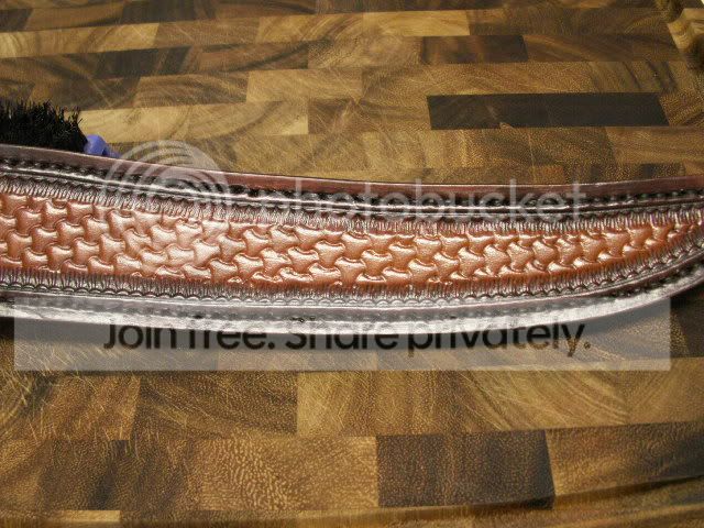

Dye. I started off not having a clue and bought the Eco Flow stuff. EVERYBODY hates that stuff, it is difficult to work with. The sheaths I posted above I used Eco Flow and it indeed sucks to work with. I had to use a wet toothbrush to remove excess residue. Also how I stumbled upon my process for the two tone sunburst too. Lots of folks use the fiebings spirit dye. My advice here is before you put any of that stuff on your semi finished leather, practice on scrap -a lot- till you find out what is rock solid for you. I also put pure neatsfoot oil on the leather after the dye is dry.

Gum tragacanth. This you use on the edges of the leather so harden it up when you slick the edges. Makes it look real nice after you burnish and let it harden. Depending on how hard you burnish the edges you might have to touch em up with the dye again.

Finish. Here's another area where you have to experiment before you put it on your hard work. I have tried dipping the whole sheath in warm beeswax and mink oil -that sucked for me-, and now I airbrush resolene. For me it is hard to brush on without getting brush strokes showing in the finished product. I got satin shene but have not really worked with it yet. After thinking about it I got away from the dipping in wax cause if yer knife gets put away after being ridden hard the moisture has nowhere to go and is kept on the knife. At least if you are only using an outer coating the leather will absorb some of the moisture.

Wow, that has to be the biggest thread I have ever posted! Oh, I forgot to add ALWAYS make a template out of paper or light cardboard first. Makes life easier. And use a welt!

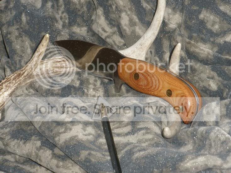

Thanks again for all the comments guys. By the way what I would also really appreciate is anything you guys notice that could be improved upon, basically constructive criticism. I'm very happy and proud with the result but I also know there is plenty that could also be improved upon. So by all means feel free to make suggestions there.

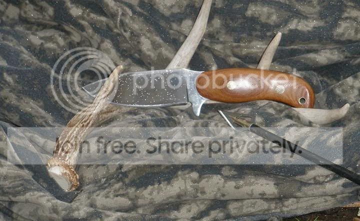

I got some more pictures of it and sharpened it last night. Fred, it's not scary sharp yet but I was able to shave thin curls of paper with it...So it's getting there :D. My strop came today I need to get some buffing compound for it. It has one side leather and the other side is leather the other side is canvas. Not sure how the canvas is used :confused:. Anyway I took some more pics, today was nice overcast day however there was a slight misting raid so forgive the water spots in some pics. I wanted to get some finalized pics up (minus the sheath of course). I need to get a better camera, this one has no way of shutting the flash off so even with a light box I don't think it will be useful.

Well done, Fletch. Did you like the result of micarta or will you use wood on your next handle?
I liked the micarta, however I have a bunch of blocks I bought from Burl Source on here the last few months and will definitely be putting them to use soon. I'm getting them organized to be sent out for stabilization.

Dude, that turned out freakin awesome man!!! How did you go about sharpening it up and how did you finish out the scales?
Thanks. I used Fred's bubble jig to put the secondary bevel on it. And then used the Gatco sharpener I have. Then I did some semi final touching up on with my fine DMT diamond stone. I used the bubble jig and set the angle I wanted and just kept that angle consistent as I drew the blade across the stone. I'll still work on getting it a bit sharper with my strop over the next few days as well. It's sharp enough to shave fine curly pieces of paper right now, but it snags a bit at times.
The handle I sanded up to 8000 grit with some of the 3M polishing cloths I got from Stacy. I was going to finish it off by rubbing a diaper over it but that seemed a bit much even for me ;)
