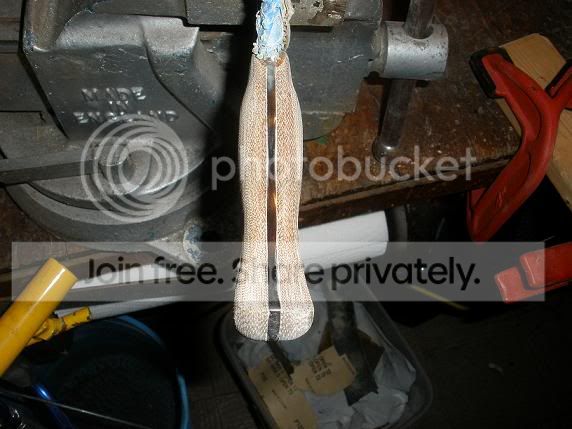

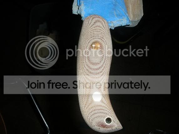

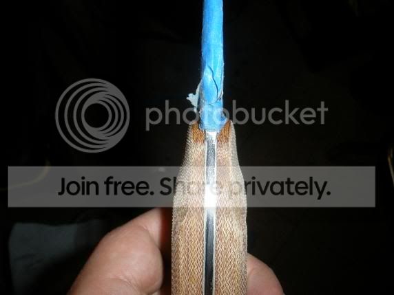

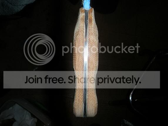

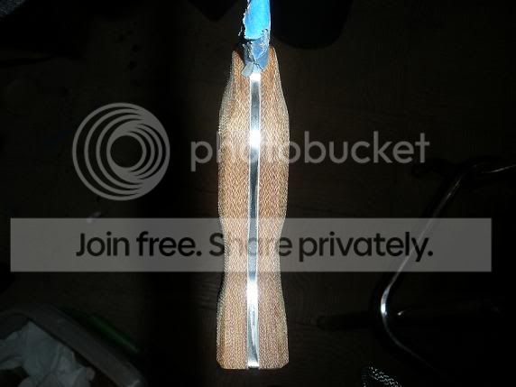

I don't know if anyone else feels the same but I really enjoy the handle shaping process. Progressed a little further while trying to keep a decent amount of symmetry as I go along. My plan for the butt area is to have it taper a bit more closer to the lanyard hole and then have it flare back out. Which would create a kind of stop for the back of your hand.
Some progress pics since I've been taking a ton so far. Why slow down now, right?
Spine side
Edge side
Spine side
Edge side

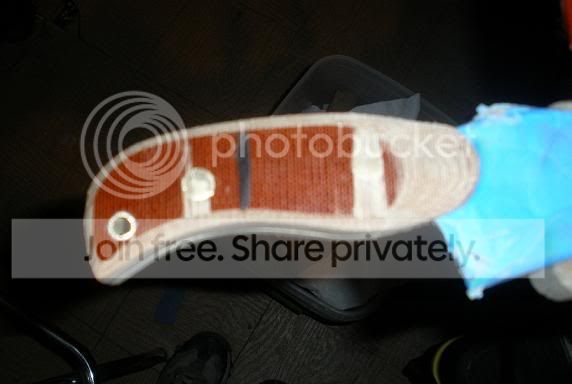

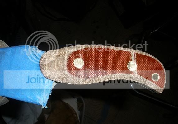

Well I think all the rough stuff is just about wrapped up. Did some cleanup work tonight with some finer paper and files. The ONLY real problem I have at the moment is one of the rivets has a few deep gouges in it. Which I think got in there from the bandsaw when I cut them off. Thing is it's in a spot that I would prefer to be more convex. However trying to round it off is going to take the palm swell down a bit I think and not be as round as I'd like it. Unless it's something that will work itself out as I move through the girts... Not sure if it will though, first time and all.
I wanted to make the handle a bit rounder but apparently not going to happen now. Other than that little SNAFU I think it's almost time to start smoothing it out and making it shine.
Hey, it's looking good--can't wait to see the final product! Does micarta polish up with sanding or do you need to apply some sort of finish?

It may look like the grand canyon, but will come out quickly. Just sand it on down the grits. It will probably start to disappear at 220, and go away at 400. The last traces of marks will go away as you buff the handle with the 3M cloth papers. If you wish, take the smoothest file you have , and lightly go over the rivet now, to get the smoothing started.
The handle looks good. The "bird head" butt was really accented by the placement of the thong tube.
I think you will end up with a first class knife soon.
A note:
The canvas micarta always looks like it isn't getting much smoother. Just sand with one grit until the surfaces are curved as you like, and go to the next . It will look good at 400/800 grit. You can continue to a higher grit and see if you like the look, or quit at 400-800 range. I find that the 3M cloth papers do a great job of bringing out the final color when hand finishing this material. The end result surface will have a grippy look to it caused by the warp and woof of the canvas.
MBE the micatra will polish up on it's own afaik.

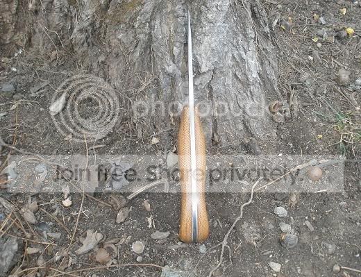

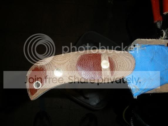

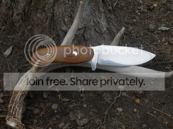

Well took the handle up to it's final finish. Not the greatest of pics, I just ripped the tape off and hit the blade with some acetone to get some of the glue from the tape off. Once it's fully done (sharpened, all pretty, etc.) Then I'll take a bunch more pics and with a little better dressing up. This was just a quick set it up and snap 2 pictures of it deal.
Only thing left to do I think is sharpen it (which I'm kinda nervous about). Still not sure what the best way to go about it is. Anyway here are the home stretch pics :D
Forgot to take a spine shot so snapped a quick one. The angle makes it look like the handle near the ricasso is thicker on one side than the other. I think I was just a bit off center but when you're centered behind it, it doesn't look like like the pic shows.
I just sharpened mine on a 1X30 belt grinder to rough in the edge then went to work with the stones till the convex edge was gone. Just keep that edge centered and you will be all good. Looks great too, good work it was worth the wait.:thumbup::thumbup:
Thanks for the comments guys. Yeah it feels good to get it done, although I was really enjoying working on it so it's kind of a bitter sweet ending :). The handle work especially I enjoyed.
I still have to go about making a sheath, which is something I know ZERO about. So I'll have to get some leather and the working tools for that. I don't have a Tandy or any leather places nearby afaik, so I'll have to order everything online. No clue what to get yet but that will come with time I guess.
I owe a HUGE THANK YOU to Stacy for everything he has done with this. As well as to everyone who has chimed in from the beginning and anyone else who has helped me out with questions along the way. The whole success of this project has been a combination of all of that.

I know you are a bit obsessive, and would freak out if the blade got scratched in sharpening, so tape the blade up all but the last 1/4" before the edge. That way if the knife slips, or you set it on the stone/belt wrong, all us not ruined. Put several layers on.
