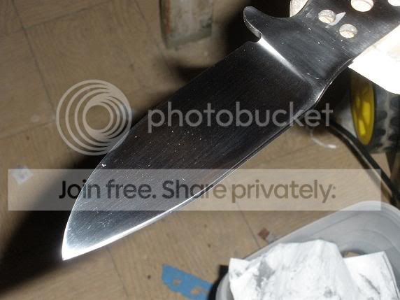

Alright here is a pic, somehow I lost the pic of the other side and I'm too lazy to try and take another decent pic of it. For some reason my "satin" finish doesn't seem to be as satiny as a lot of the finishes I see. This was taken to 800 grit with Mobil 1 and it's awful shiny if you ask me. It looks more like a finish with some sanding marks in it than a satin finish :confused:. When I look at it I can see my reflection pretty clearly in the damn thing...Aren't you not supposed to be able to do what with a satin finish?
I like getting scotchbright pads from the local auto parts store. They make a nice satin finish.
Fletch, here's one finished to 600 grit if I remember correctly:
So, yeah, you can see your reflection in a hand finished satin. :D A machine finished satin, tumbled, or sand blasted are more "true" satins.

I had #5 sanded to 600 then buffed shiny. I thought it looked too shiny for satin so I buffed it shiny. I didn't like the shiny because it would get scuffed way too easy(bad material, different thread). I sanded back to 400 and love the satin finish. Although, I also considered a cheap sand-blaster to do the same.

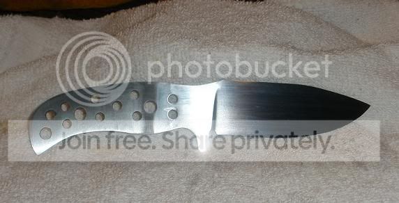

BTW: All the holes in the handle, are they all for pins or just to reduce weight?
Only 3 serve a purpose. 2 for the Corby rivets and 1 for the lanyard tube. Rest are for weight reduction. Page 4 post 78 like Stacy mentioned shows that it looks like with the handles on.

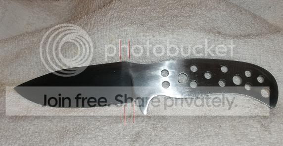

Alright I think I'm just about there on the finish. The only thing I'm a little unsure of (both what it is and how to get rid of it)... Is marked in red on the top pic. It looks like I've mentioned before a 2" grind line right where the plunge is. Not sure how it got there because I did a tip to tang rub on this and just touched it up to make sure it all flows from the blade to the ricasso area... And it was all with a 1/4" piece of square stock. Since they were done separately I wanted to have the finish look as uniform as possible. There is still a little oil on it I'm sure which makes some spots look a little smudgy. Not sure what the best thing is to get all the Mobil 1 off the blade before I put the scales on.
Good call on the brake cleaner, I degreased the blade today and spent a little time on the handle. Mostly just the area that will sit on the ricasso I tapered it down and buffed up the front edges to 1200 rather than try and do that when it's against the metal. I'm planning on doing the handle with a taper towards the tip then widening in the middle of the grip and taper again towards the butt. So it'd be thin, wide, thin is the current plan.

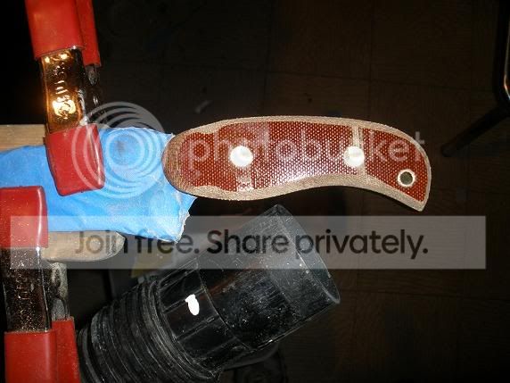

Everything was glued up a few nights ago. Cut the rivets and tube off last night and did a little filing. Tonight I basically took all the excess material off the edges (not sure if that's considered profiling). Also did basically what you see on both sides. The more indented areas near the ricasso are roughly where the handle will start to get thicker. Never really did this before so I'm flying strictly by feel here.
