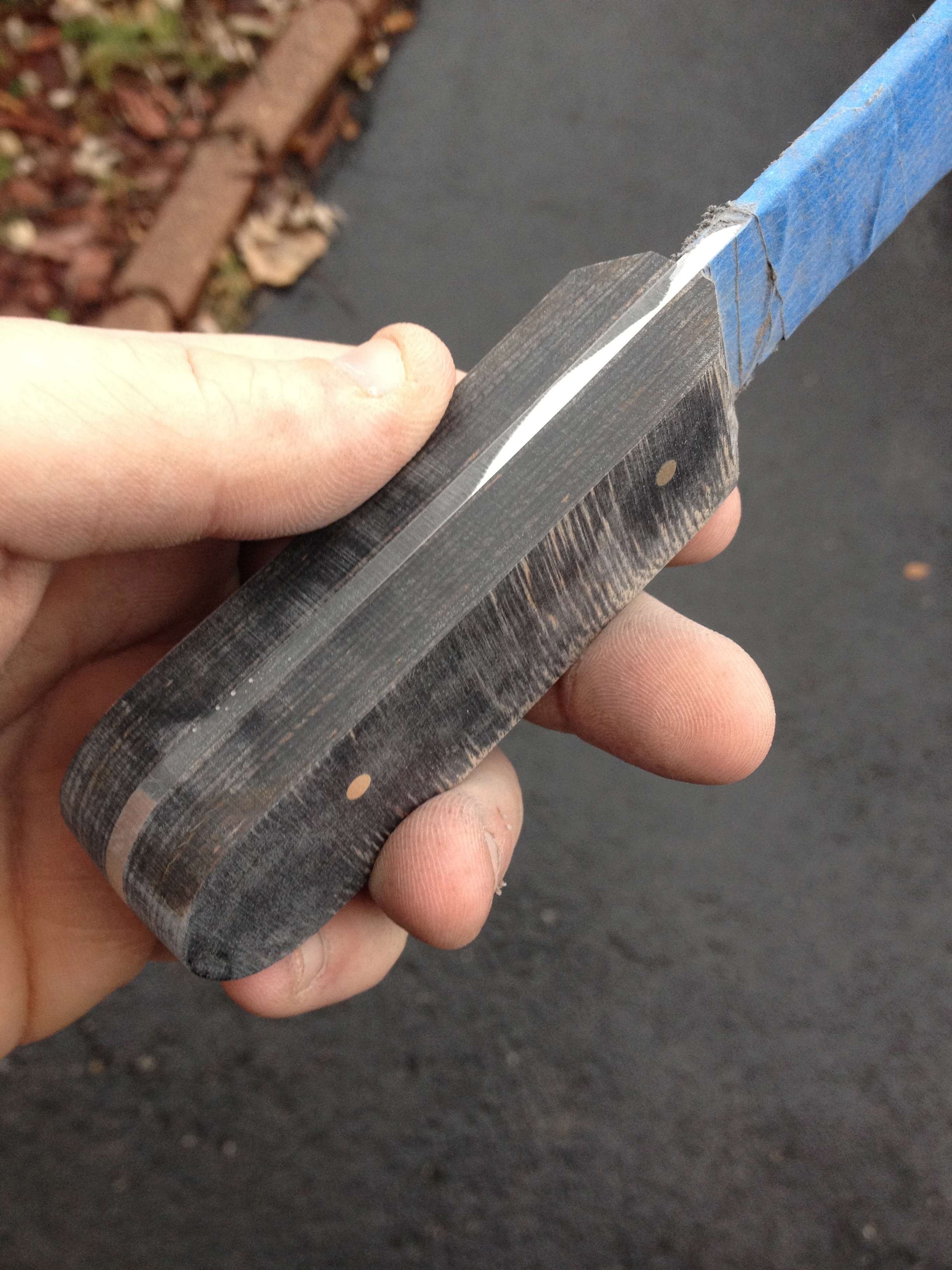

My First Knife WIP
What that knife suffers from is called BHS.....Blocky Handle Syndrome. You need to round that handle up a lot. Taper it toward the bottom as you make it rounder, making it egg shaped in cross-section.

Thanks Stacy, any thoughts on the blade not getting razor sharp?

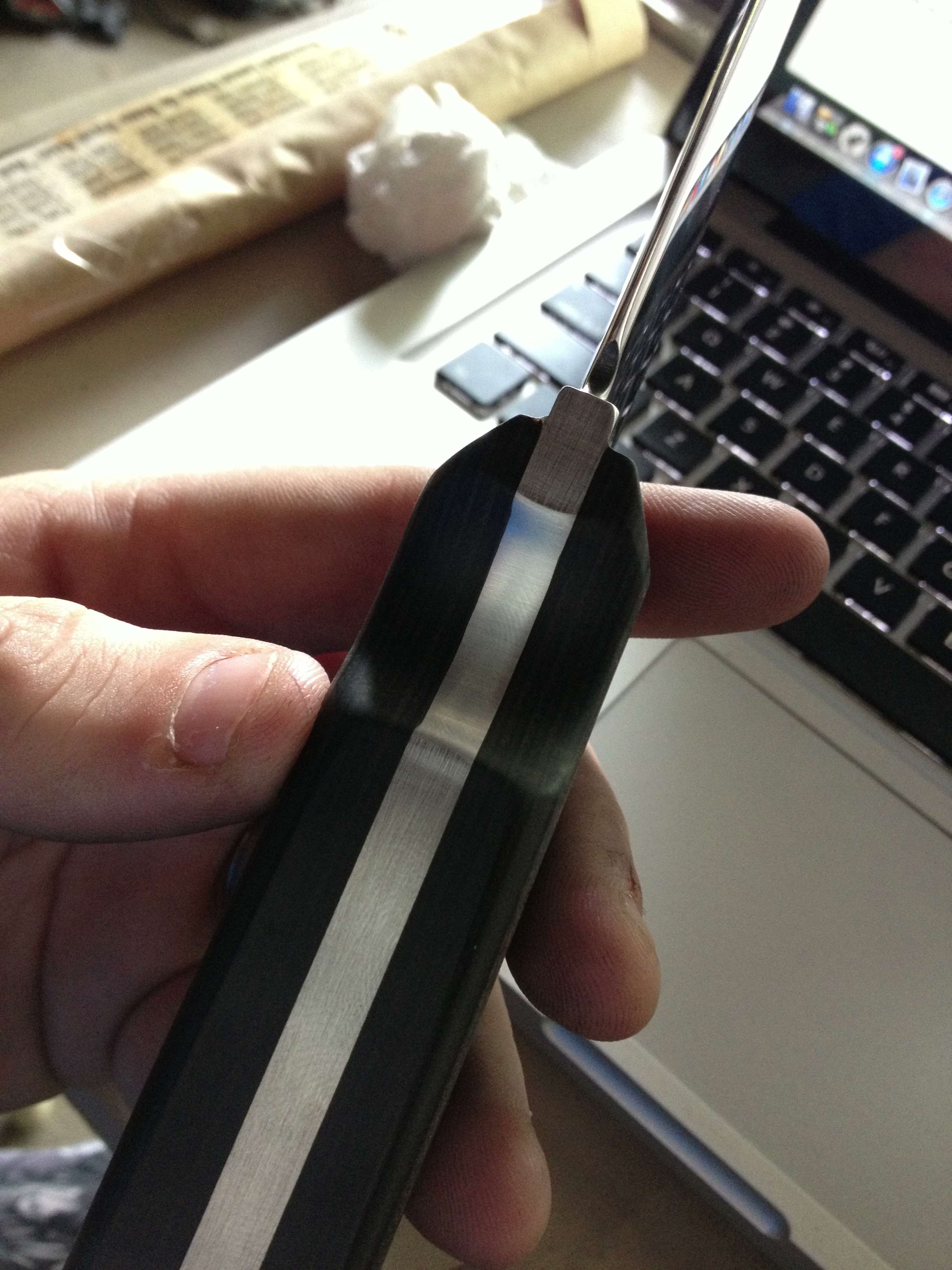

Quick Update: I sanded down the epoxy in the finger guard, I have higher standards than that (momentary lapse of laziness).

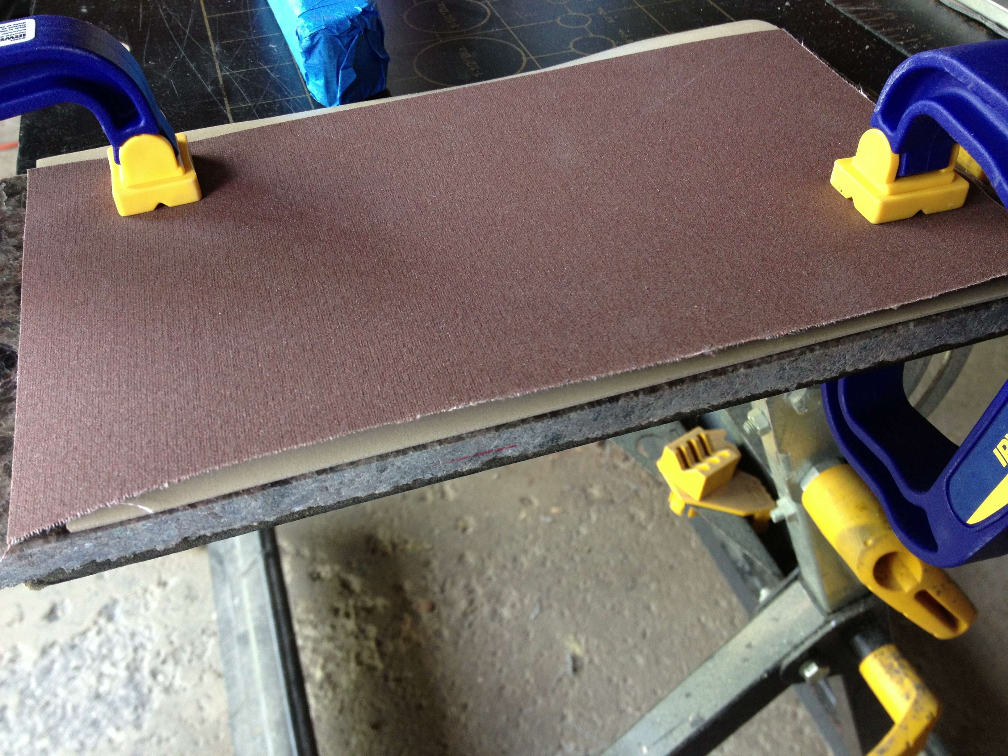

Are you pulling or pushing when you sharpen? Think spreading butter, not shaving off the paper. In other words from spine to edge not edge to spine for your direction. And make sure its not too spongy of a material you are using. Too soft will wreck it. Needs to be fairly firm. Mouse pads are great...

Here's my sanding station...
I was moving in both directions while sharpening so I will try moving the blade edge to spine only, thanks!

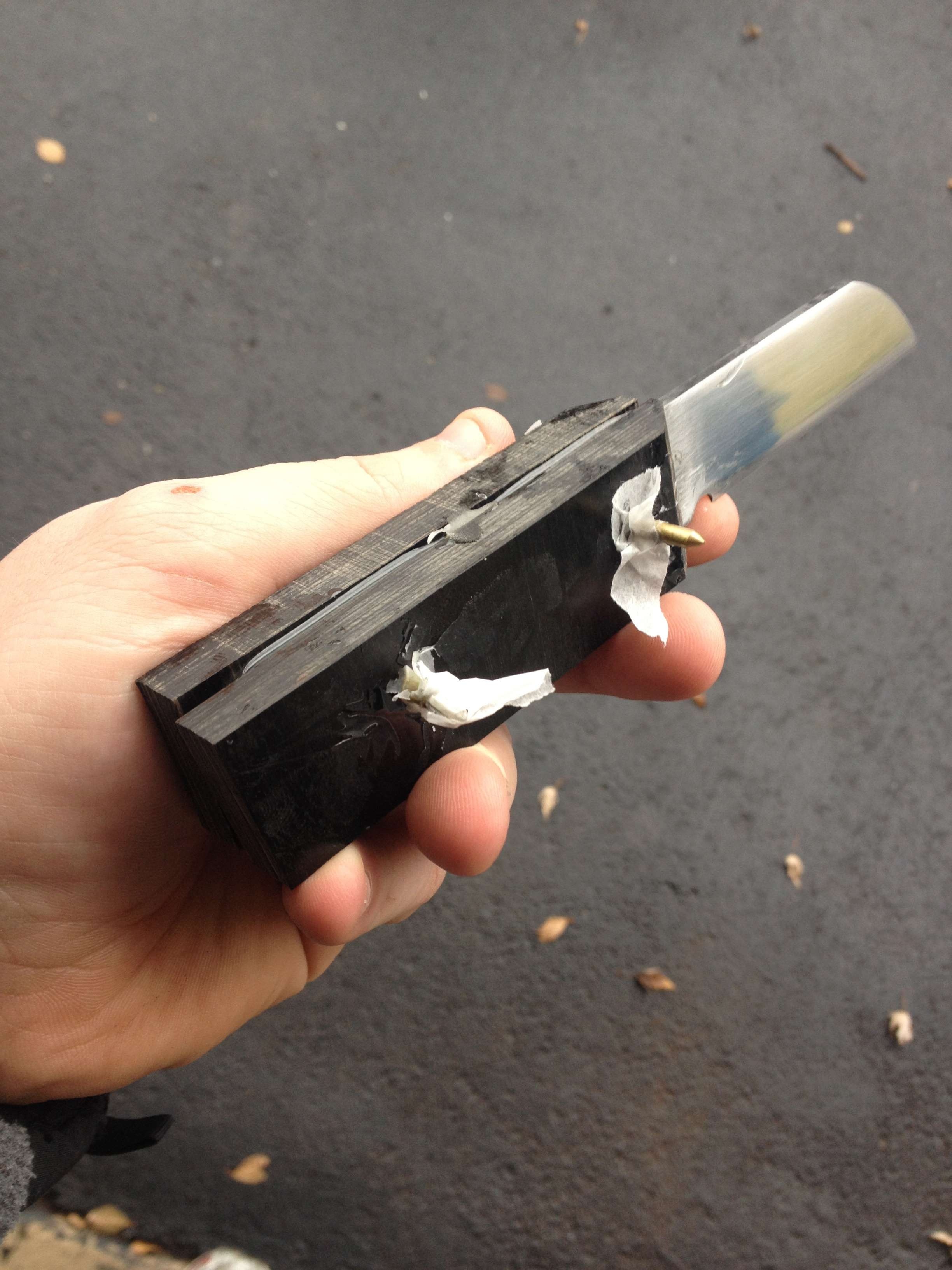

I mixed up some epoxy yesterday and mounted the scales and today I spent time with my new Harbor Freight 1x30 grinder working on the handle. Wow, talk about a total time saver in terms of the 1x30 grinder. I've regained my interest in knife making now since it won't take me 30 hours to make a handle by hand. Here's a few WIP pictures that tell a small portion of the story.

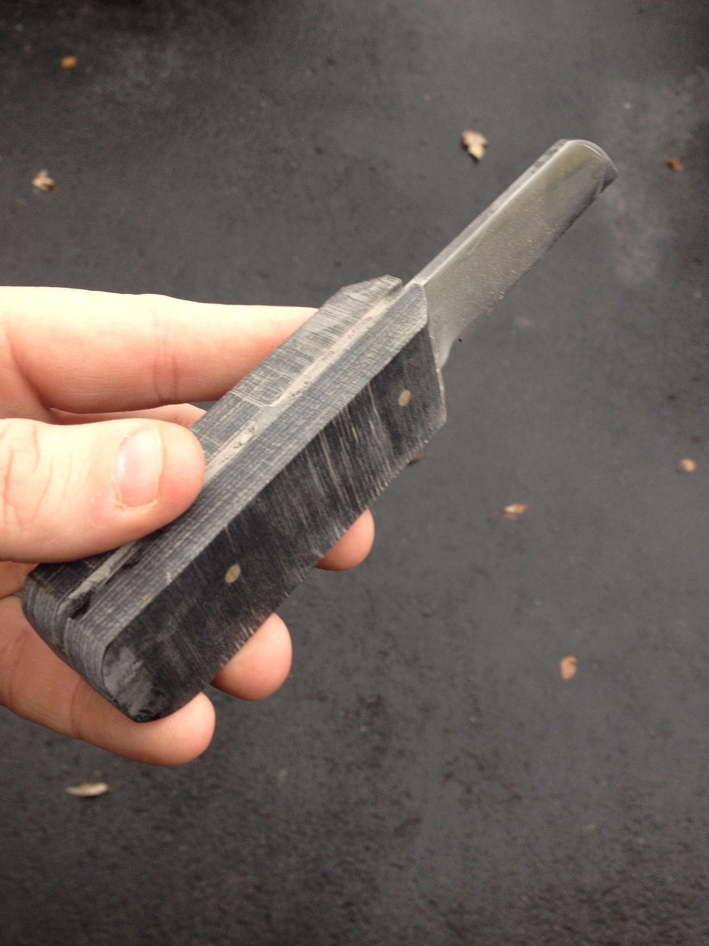

Initial sanding (very square and the butt of the scales are not even with the tang)
Scales are now flush with the butt (sounds kinda dirty) but still a very square handle

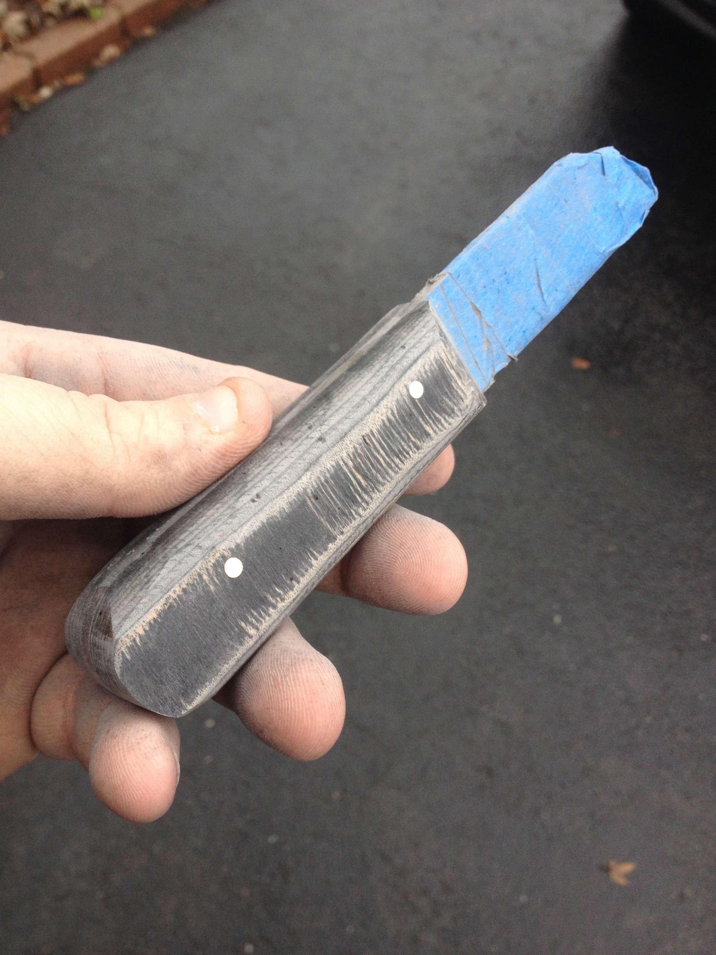

Finished with the 1x30, rounded the edges with the next step being hand sanding. Handle feels nice in the hand and 100x more comfortable than my first knife's handle.

Pete just a tip to consider. Before you mount your scales finish the front of them to completion. This way when you're working on shaping them and sanding them you won't have to worry about scratching up the ricasso or possibly the blade when you're finishing it. Something Stacy points out a lot and did with me on my first knife. That handle is still to blocky imo. Think of the handle like a woman... smooth curves and feels good in your hand ;) If it were me I'd round the top and bottom so it was curved like a "D".
I like to get the scales close to the edge of the tang (all the way around), then do the majority of shaping with them taped together. I've read that some people use a tiny bit of super glue to hold them together.
What I learned from my last set was that I had always made my scales too thick. Look at a lot of custom knives, doing so gave me a lot of inspiration. I chose a "coke bottle" shape for my last set.
