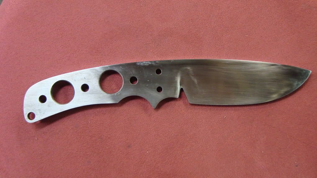

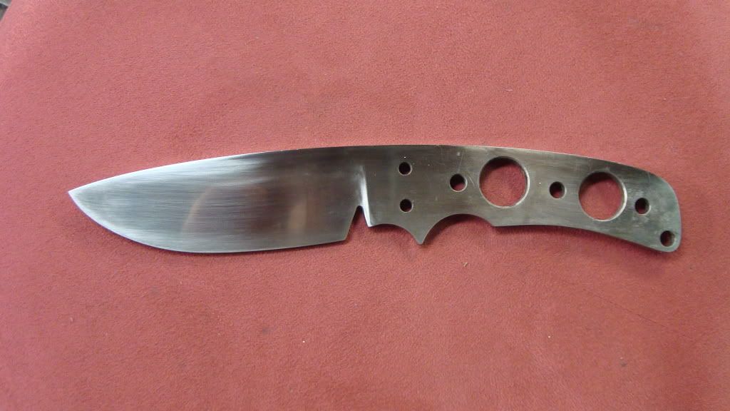

Are you sure about that Gorilla Glue thing? From what I've read it's super strong stuff but can be a bear to work with since it expands a bit as it's curing. Maybe I'm wrong but I thought I remember hearing mixed emotions about it.
The gorilla glue should be ok, if I clamp well. Being that it is a fulll tang knife the glue will have someplace to esscape as it cures
I haven't gone through the whole thing but I got this from a link in that "other" forum ;) here. Apparently it's a pretty in depth study of glues. When I get a little time to kill I plan on going through it.
I read the glue wars here and have read what others are using, to me Gorilla Glue has the toughness I am looking for and is easy for me to get. So I am up early in anticipation of my knives showing up today, I feel like a little kid on Christmas morning:p
Nice work! I myself am on my first project and I can't say that my blanks turned out half as good as yours. Keep up the good work!!! I'm really looking forward to those bowies.
Thanks, I spent a lot of time planning and getting advice on here before I even started, any success I have I owe to the members here for giving good advice.
Heres hoping the blanks come back tomorrow and I can get back at them asap

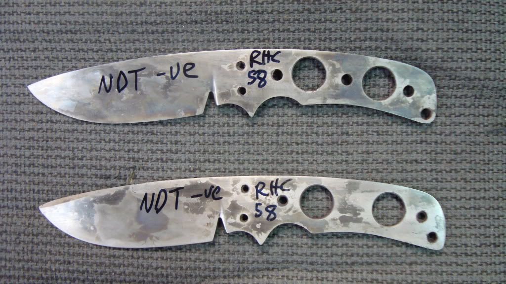

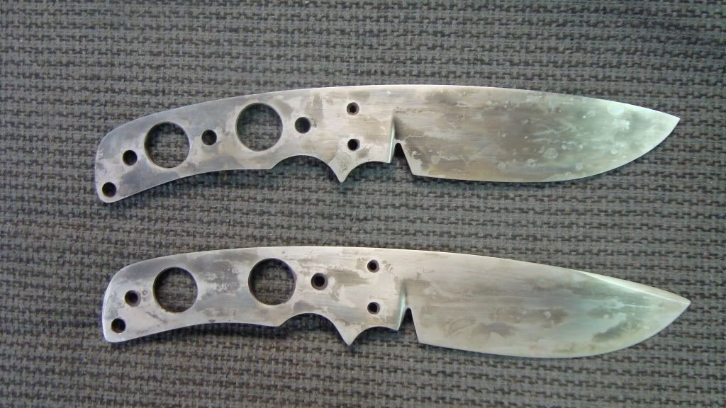

SO my first two born are back from Rob, so daddy is happy now. They aren't as shiney as they were when they left, but they are jst as smooth and hard now. Time for the for the sanding to start again.
So here they are in thier current state
Time flies when you arehaving fun:D, Got the scale off the first one
Want even tryig to do much else and they are starting to shine. Doesn't really show in the pictures but you can see clear reflections when in line with the sanding, by the time I get to 1200 grit they will almost be mirrors:eek:
Have to say it again Thanks Rob at Knifemaker.ca, don't think I could have been more happy with what I got.

I cut down about 6 bike boxes with the knife this morning so they would fit in the bin out back. The knife was still hair popping sharp, no burrs or dead spots on it, then hacked and carved a piece of 2X4, not as sharp but still more then usable. Then I battoned it though another chunk of 2X4 a couple of times, no cracks, chips or imperfections any where and still reasonablely sharp, decided that was enough of a test and dulled it out on the course diamond stone. Even that was a test, took about 1/2 hour to get it to what I would call safe.
My conclutions are that my design is sound, so that template is getting put in the keepers folder, and Rob's HT is top notch:thumbup::thumbup:. I think that even when I start forging that I will still send most of my stuff to him for that all important stage.
