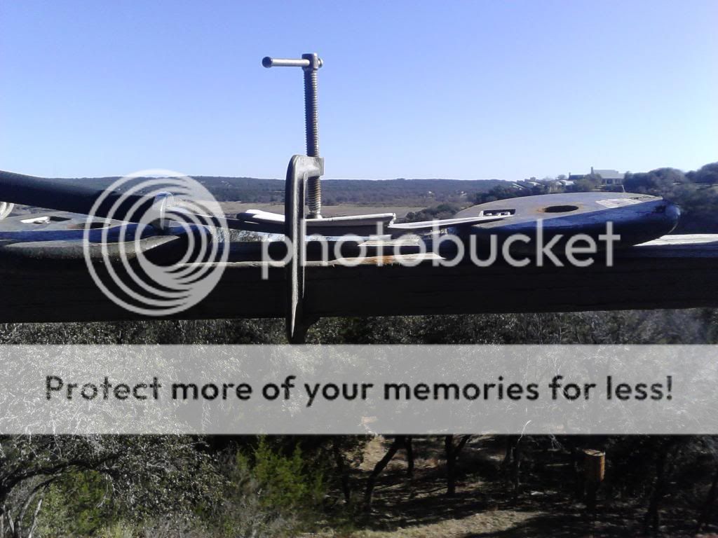

Here's something else it will do:
I was trying unsuccessfully to take the bow out. There isn't anything in line or straight on this knife, like it was put together by some little kid, which I'm sure it was, but they are tuff.
The reason that it will flex instead of breaking is that it is not hard. That picture just proved in my mind that it has no heat treat at all. This means that you won't be able to get it very sharp, it will dull easily, and it will flex.
But since it only cost $20, swallow your mistake and use it.:)
I had a metallurgist buddy on the phone when I took the pic, in fact I took the pic to ask him if I could bend it any further. He said 440 stainless should be able flex and take a set
without breaking.

I don't know about your "metallurgist buddy" but I make knives, heat treat knives, and I can tell you that that blade won't be past 40hrc. It will work fine for a $20 knock-off, however, don't tell me that it is hard. BTW, is it 440a or 440c?
He said it's probably mystery metal and nowhere near 56- or even 54 Rockwell. I never said it was hard, the pic proves that. I do say it's tuff. For what I have planned for it I don't need a hard, brittle blade.
Actually it would be super easy to get an edge on if it wasnt hardened, but itll dull very fast.
This knifes going back. When it arrived it had what I thought was a ridge of bubbled up black coating that I couldn't scrape off with my thumbnail. After stripping the coating off I found this. I tried to buff it out but it just got longer and deeper.
It's some kind of crack or fissure in the steel. Does anyone recognize this other than a seam? It won't hold up to even normal use much less abuse. Buncha bull$#!*
