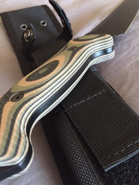

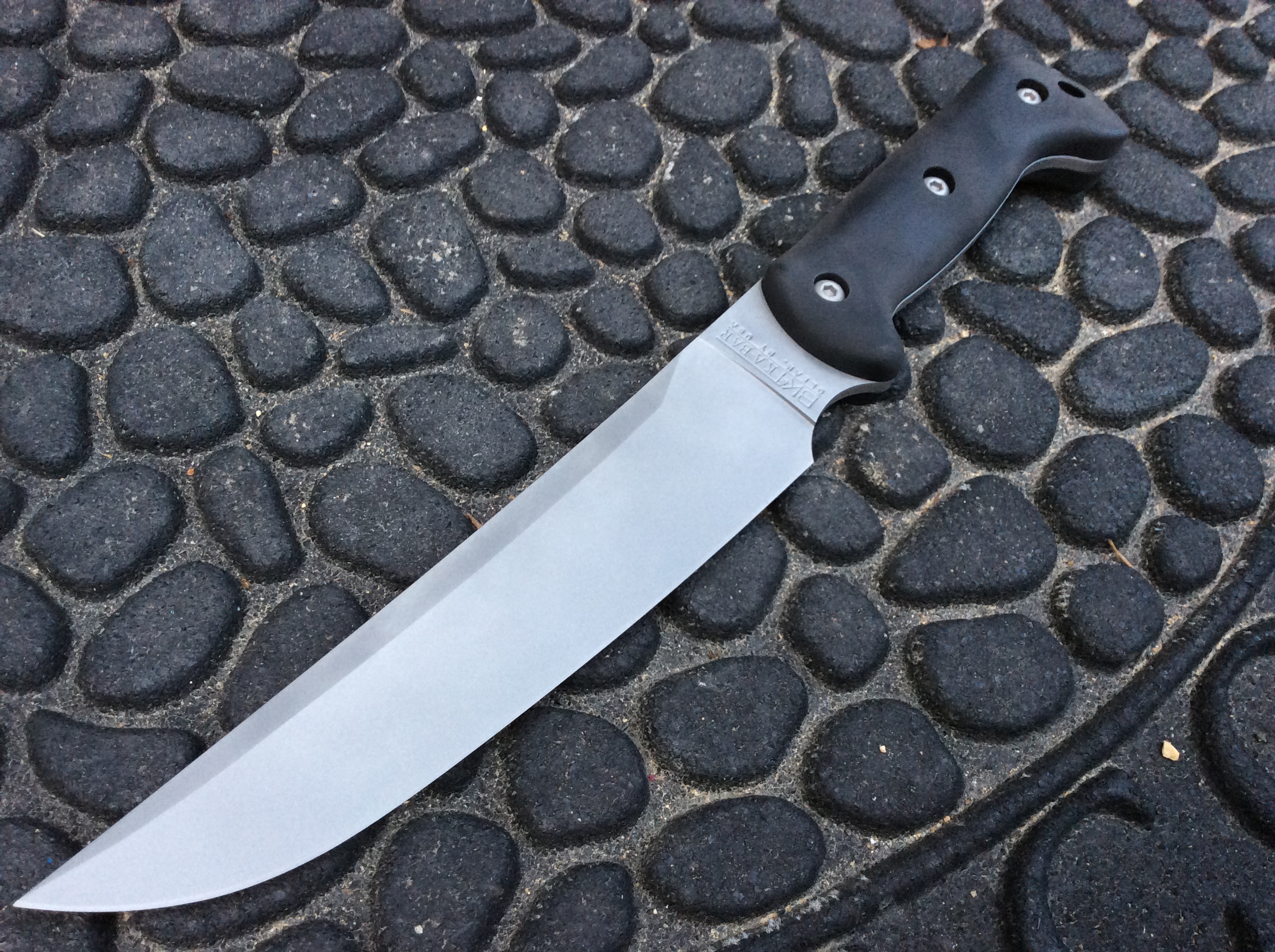

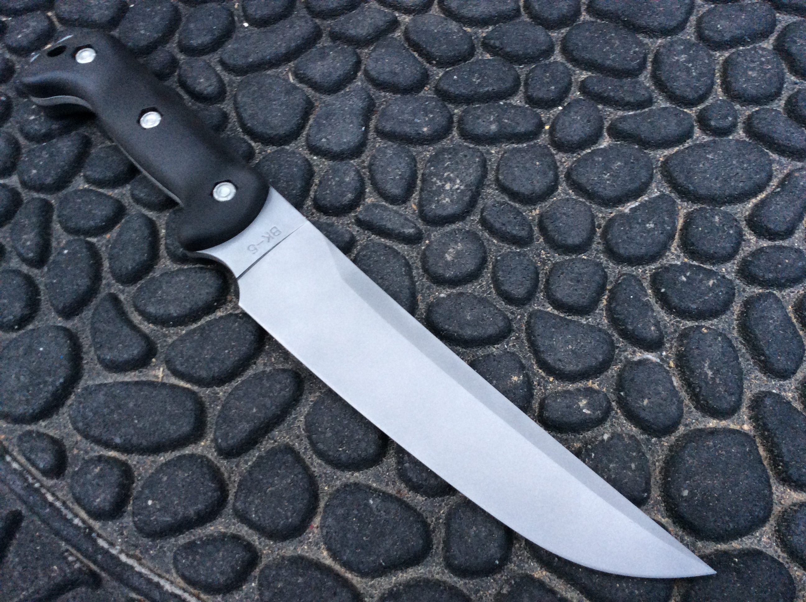

I've done this before to various knives and a few other Beckers. I like the matte finish because it gets rid of all the machining marks for a much cleaner look. I'll take some OOOO steel wool to buff out some of the matte finish for a semi satin look, add a patina, rub down with oil, and throw the micarta scales on once they get here! Next will be a custom sheath of some sort. Hope you enjoy the pics!
I left the handles on to help keep the coating under the knife scales
The finish is real nice!
Even the hardwear was left on and blasted
Lock nuts will stay put

If bead blasting carbon steel, is there a concern that you're creating a surface more likely to trap/hold moisture that could result in rust?
I remember I once had a firearm that was stainless, and had never had a problem with rusting, but as soon as I bead blasted it, started getting issues of "pin prick" type rust dots that would show up if not maintained very carefully.
The steel wool buffs out some of that matte finish. Once the patina is done and oil applied, there shouldn't be any issues with rust. I tend to wipe down my blades with an oily rag after each woods outing and I've never had any problems.
Love the TKC grips, also as far as sandblasted steel, only my personal experience but its not caused me any issues on mine. I think it could, but I clean mine regularly and oil them. I think the little dents hold a little bit of oil, just like they would hold moisture.
