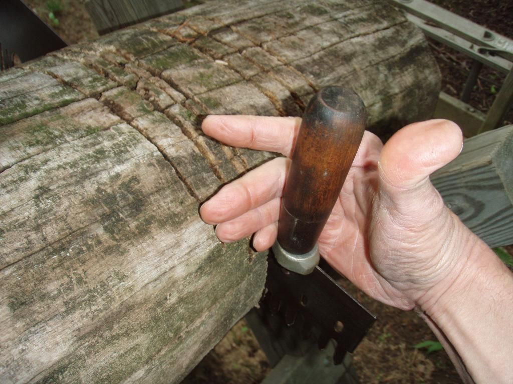

An often neglected purchase for someone planning to use a big one-man saw in two-man (woman) mode is a decent second handle. Those little auxiliary handles are ok for occasional cutting, but if you plan to cut in two man mode a lot, you should buy a good western handle for it. Biggest drawback in using the aux handle is getting your finger pinched after crossing the halfway point on the log. A western handle has a finger guard. Depending on where the handle hole is though, you might need to drill another one closer to the tip of the saw.

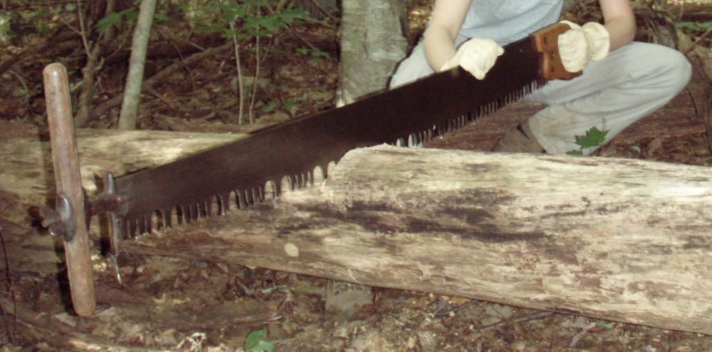

Saw below is a topper - broken end of a longer saw made into a 4' one-man. Blade is heavy, single bucks well, and takes a big handle. These are fairly common on Ebay.
There was an old timer lived up off of the Salmon in Idaho who attached an inner tube to one side of a crosscut and used it that way. He ran a one man logging operation.
