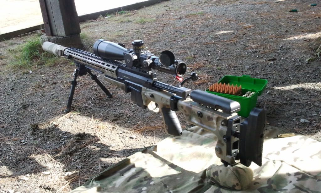

Yep, part of the reason I am a huge fan. I also have a 28" .243 barrel for my AI, I wanted to push DTACs as fast as possible. But I barely ever use it, as the barrel length with an extra 7.5 inches of suppressor on it make it a cumbersome beast that really can only be shot prone.
Here it is with an 18.5 inch, plus the can (with a mirage cover over it.)

BM11...killer setup, man! Is that a TAB cover? I love me some TAB Gear! :D
Yeah, Tony built that one custom for me. My suppressor only has 1/8" or so clearance in front of the handguard, so I couldn't go with a typical mirage cover. I actually have both kinds, the other one (a type 3 I believe) I use with my longer barrels.
I have a bunch of TAB gear. Tony is good people, and he shoots an AX, so that makes him even better, haha.
