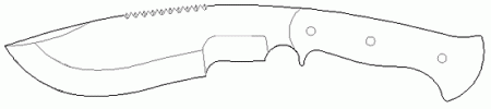

So much cardboard later....I come up with these:
attachment.php
3a has more of a straight spine (to the tip)
3b now has a clip point
3c brings back the sawback
3d straightens out the drawknife area

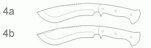

Which brings me to the latest designs:
attachment.php
4a goes back to a drop tip and a straight recurve, but keeps the flat draw knife area
4b adds a false unsharpened edge
So, what do you think? I could really use some input. So far, 4b is my favorite...but really only because it's the last iteration so far.

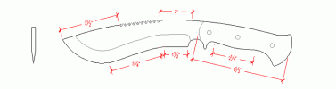

Also, here are some other dimensions to consider:
attachment.php
Starting clockwise from the topleft:
the 3.5" is room for use as a drawknife
the 2" is for batoning
the 5.5" is the length of the handle
the 2.5" is an average width from the center of the index finger, to the center of the pinky finger
the 1.5" is the width for the drawknife
the 3.25" is the usable recurve (maximized)
The reason I placed the sawback in the middle instead of toward the tip (like almost every other tracker) is that I think the knife should be able to be used as a draw knife.
attachment.php
(yes...those "ellipses" are actual measurements of my fingers, etc...and yes, I'm anal-retentive about details sometimes....:p)
I set it up so that the drawknife area is exactly the center of where you would hold the knife.
The sawback would be like Beck's...which is like the SAK saw (self cleaning). It's use would mostly be for making notches (for lashing, etc.)
attachment.php
And I want the tip to be able to gut/skin without touching the sawback.

Like the Pen, you've placed material forward on the blade. It is not dissimilar to a khuk- trace the outer angle and you have a less pronounced Ganga Ram. I kinda like it, Dan. The finger grip thingie bothers me, though. In practise, these never seem to deliver the comfort or stability desired, and sometimes get in the way. I don't know that has happened here- I'm merely thinking aloud. if there were ample room for an average to large hand behind the finger groove/handle guard, and the forward grip with finger overlapped truly an option well; that would be good, wouldn't it?
munk
The only thing I can say that to field dress an animal a deep belly is desireable . That looks great . I would like the handle " (Swept back " ? ) a touch more or you partially negate the use of the belly .

To my knowledge, there was no "gut hook" on the Tracker. That round-recurve section on the lower part of the Tracker blade is a rounder, not just a draw knife. It had specific uses, especially for working wood, like making bows and spears and fire-making tools, etc...
Lets see 4B with the rounder put back on...

Dan, try combining 2a and 4a and see what you come up with.
If they are too similar to combine I'm leaning toward 2a as I like the obtuse edge at the back.
I don't much care for the recurve on this particular design.

If it's meant to work well with a baton, I don't think that a false edge is a good idea. It'll tear up the baton.
I like 3D. Weight's forward, belly's substantial without being too much, and there's a little bit of straight edge for those times when I'm scratching my head, saying, "Damn, I wish this thing had a straight edge." ;) (YMMV.)
As for the guthooks, I'm not fond of them.
I was thinking of batoning taking place in the middle (between the sawback and the handle). But yes, if you baton on a false edge...might cause problems (or on a sawback for that matter).
I know what you mean about the straight edge...every once in a while I pull out my BM Skirmish and wish for a thin-straight-bladed knife just to get me through this apple I'm demolishing....
