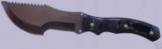

The TB Tracker, in the opinion of folks who have gotten them, does three things marginally: draw, chop, and saw. It push cuts fairly well, I'm told. Push cuts are the least used in fieldcraft.

The Tracker's allure seems to be more romantic than practical in my opinion.

Just for comparison, here's a photo of the Tops Tracker ....
attachment.php
I looked for a picture of the Dave Beck version, but couldn't find one. Did find this one by another manufacturer...
attachment.php

I will say the Tops Tracker feels surprisingly good in the hand.
But, god, it's ugly.

Beck's Pathfinder was a much more serious knife. It is a shame that they didn't use that one in the movie.
