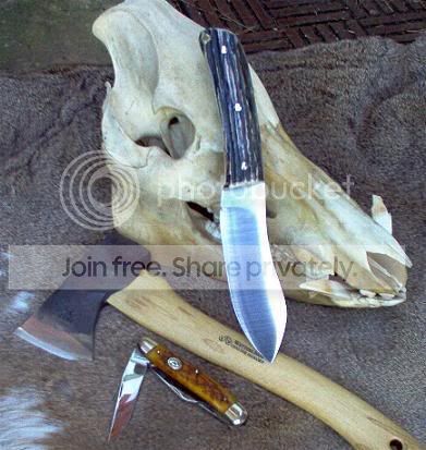

Personnally, I loved sooo much what Fiddleback posted, that I had to try the Nessmuk design; I made my "own" version of the legendary knife; take a look:
Lookin good!!! Thats some sweet pinwork there! Nice to hear of someone doing their own!!!
