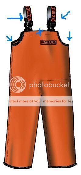

keep in mind that if the knife is going to be affixed to the suspenders of a pair of oilskins, the marlinespike should be a tight fit. if the knife is worn inverted, the marlinespike could be lost otherwise. I can't forsee ANY emergency where the marlinespike would need to be drawn quickly. however, drawing a knife from a sheath mounted high (chest level or so) is difficult if the knife isn't inverted (handle down).
here are the positions where I've carried a knife (not including in a sheath on a belt around the outside of my pullover and oilskins) indicated by the blue arrows and the X.
The strap carry on either side needs to be an inverted sheath.
The front of the bib can be carried inside of the oilskins with the handle up or outside with the sheath inverted (outside tends to catch on the trap as you bend over it to empty it though)
On the sides a knife can be carried inside of the oilskins or outside, i've never found a difference in drawing the knife from the side, except if it is worn outside of the oilskins it tends to catch on things and can be lost.
I prefer a boot style clip on sheaths to wear on the oilskins, but it is near impossible to wear the knife (or keep the knife) on the suspenders like that.
I can't tell you the number of knives I've gone through trying to find something that works. if your knife is affordable enough for me, I might just have to pick one up. :)
Thanks for that pic. That helps alot. I see what you mean about attaching a knife to suspenders like that. Quite a challenge. Would you ever consider a sheath that you wear on your bicep? It would require taking it off and putting it back on if you added or removed clothing though.

I just took out my Grundens and had a look. Instead of attaching the suspenders as usual, then trying to clip a sheath to that elastic, why not intercept the suspenders? Make a sheath that attaches directly to the bib on its bottom, and design the top of the sheath such that you clip the suspenders directly to it. This would make the sheath almost integral to the bib.

Another carry position is on the back of the bib, inverted, and outside of the oilskins. this way, even in a pullover, you can access the knife by reaching up and finding the handle and drawing downwards. It also makes the knife accessible with both hands, which could make all the difference in the world if you're holding on with one hand, and letting go means a "gloucester sleigh ride" out the open stern of the boat ;)
This also helps by keeping the knife in the same place regardless of the amount or style of clothing worn. I can't tell you the number of times I've reached for my knife and couldn't find it, because I was carrying it somewhere else :eek: .
