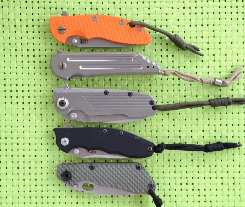

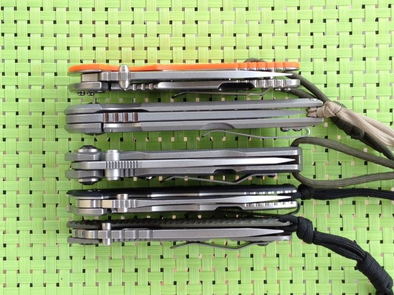

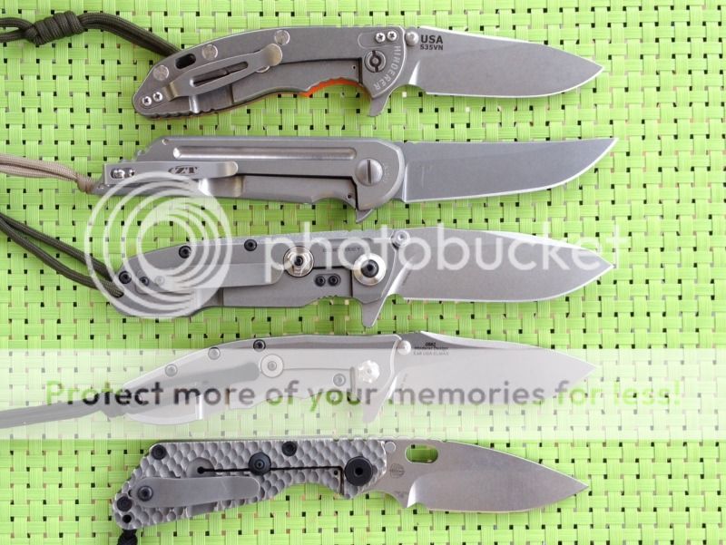

Here's a few pics of the District 9 vs a few of my other knives. The D9 is comparable (or better) in quality and finishing to all the pictured knives. The knives are top to bottom:
Hinderer 3.5" XM18 Slicer
Hoback Knives Kwaiback Midtech
District 9 Storm Drop Point
ZT 0562
Strider SnG DGG

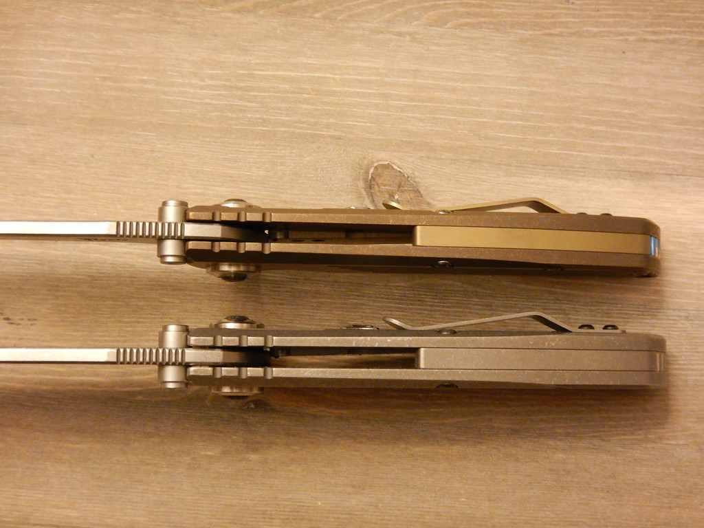

To those who have one, what do you think of the raised pivot design. That's really the only thing holding me back (well, maybe the rotolock isn't my favorite detail either) but I really like the blade shape and overall package looks pretty enticing. So, is the raised pivot distracting and/or clunky to you? Just looking for opinions, I feel like if this was flush or less protruding I would like it alot more.
The raised pivot hasn't been an issue for me. I never notice or am conscious of it in use or carry. In my comparison pic above the thickness of the pivot looks much more obvious than it seems when actually handling the knife.
My main criticism of the knife is the weight, I wish it was 2 oz lighter. 5-6oz is the sweet spot for a tank like folder, imo. I am also going to put a deeper carry clip on mine because I like a lower profile in the pocket.

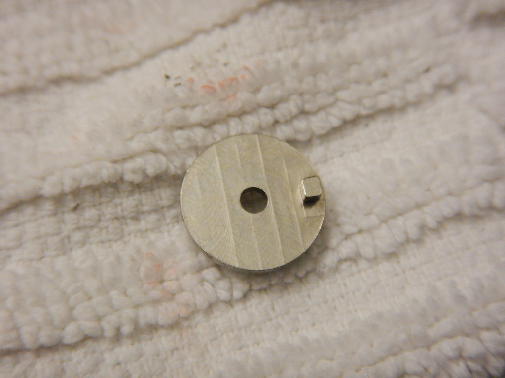

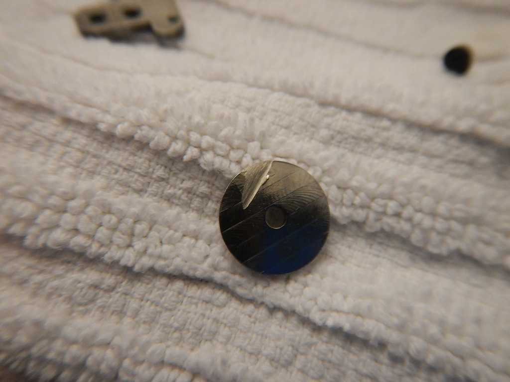

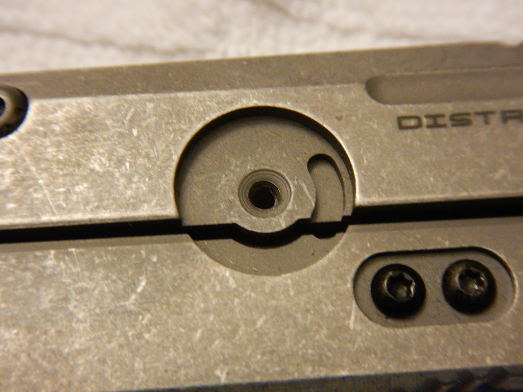

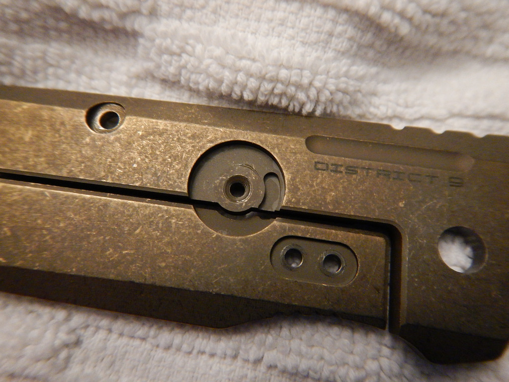

Just got my D9-A and the disk near the lockbar does NOT seem to function as a Rotoblock... But on my District 9 Storm, it does rotate and block the lockbar locked. Odd. I can't wait to pull these both apart and see how they tick. The fit and finish on the D9-A version isn't quite as nice as the District 9 Storm, and the function is a little more gritty and not as smooth.
I'm guessing Reate removed the function of the lockbar disk to avoid legal issues since theirs is a "production" version. Because there's no need for it to be there as a LBS either, since it has a built in overtravel tab on the lockbar insert.

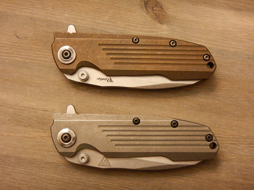

So here we go.

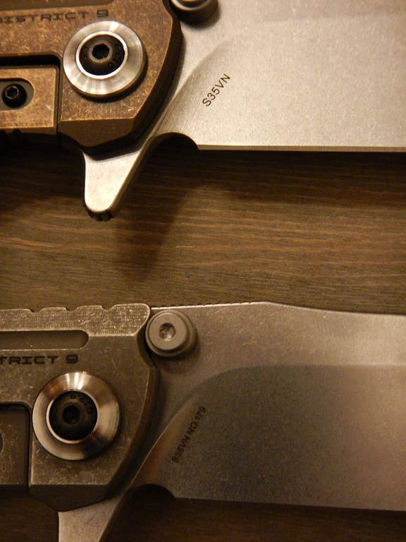

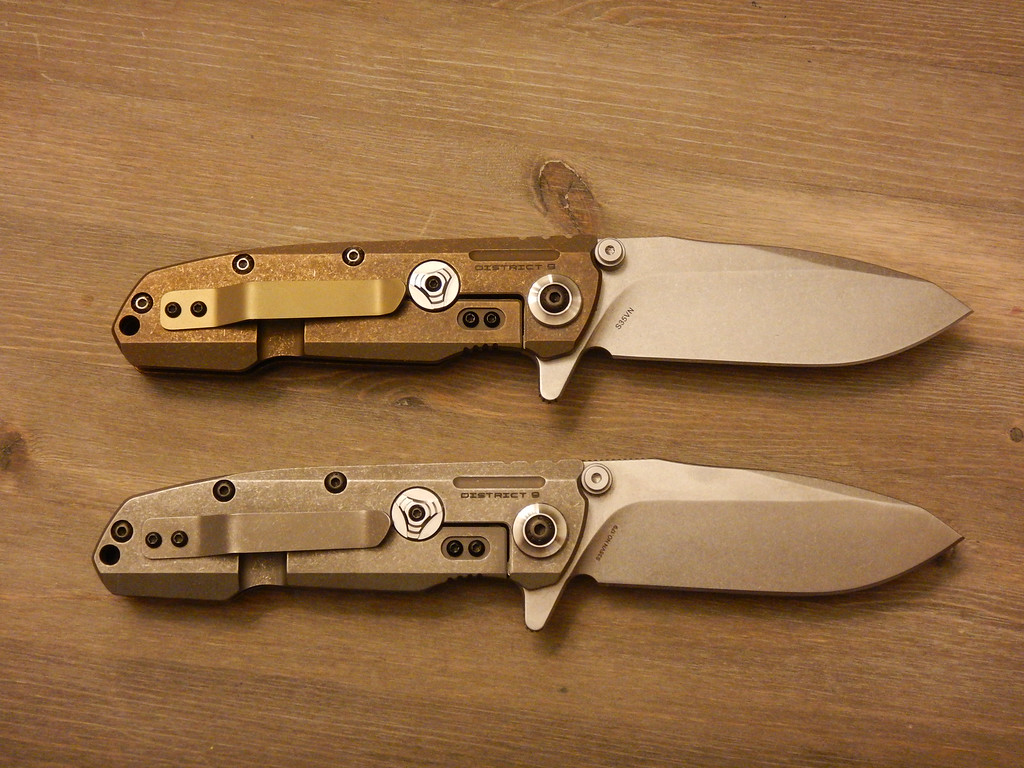

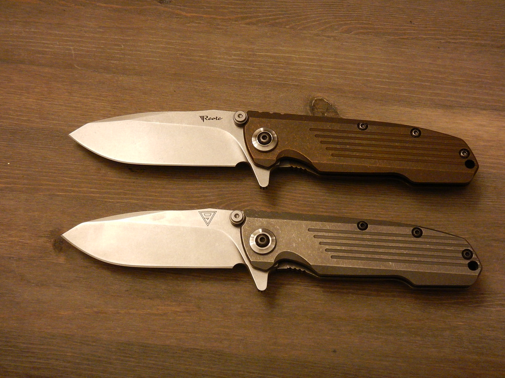

Top is the Reate D9-A (bronze) and the bottom is the District 9 Storm Drop Point (plain stonewash).
The grinds on both are fantastic and they are both scary sharp. I've paid more for knives with imperfect grinds compared to these two.
Jimping on both is very well done, grippy without being too aggressive.
Fit and finish on both is phenomenal. I give the edge to the District 9 version, but both are perfectly centered and really well done.
District 9
Reate

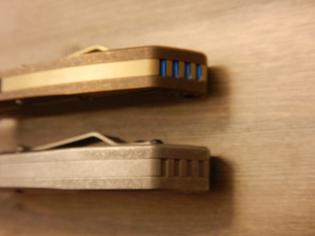

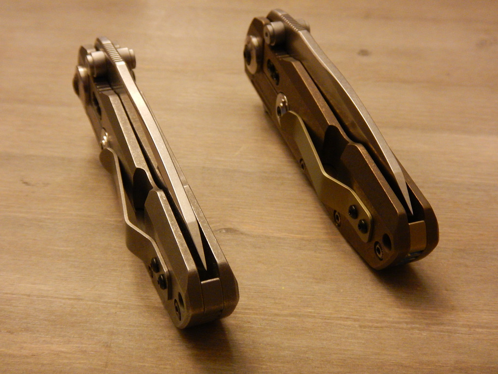

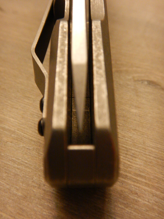

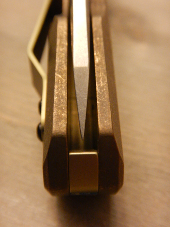

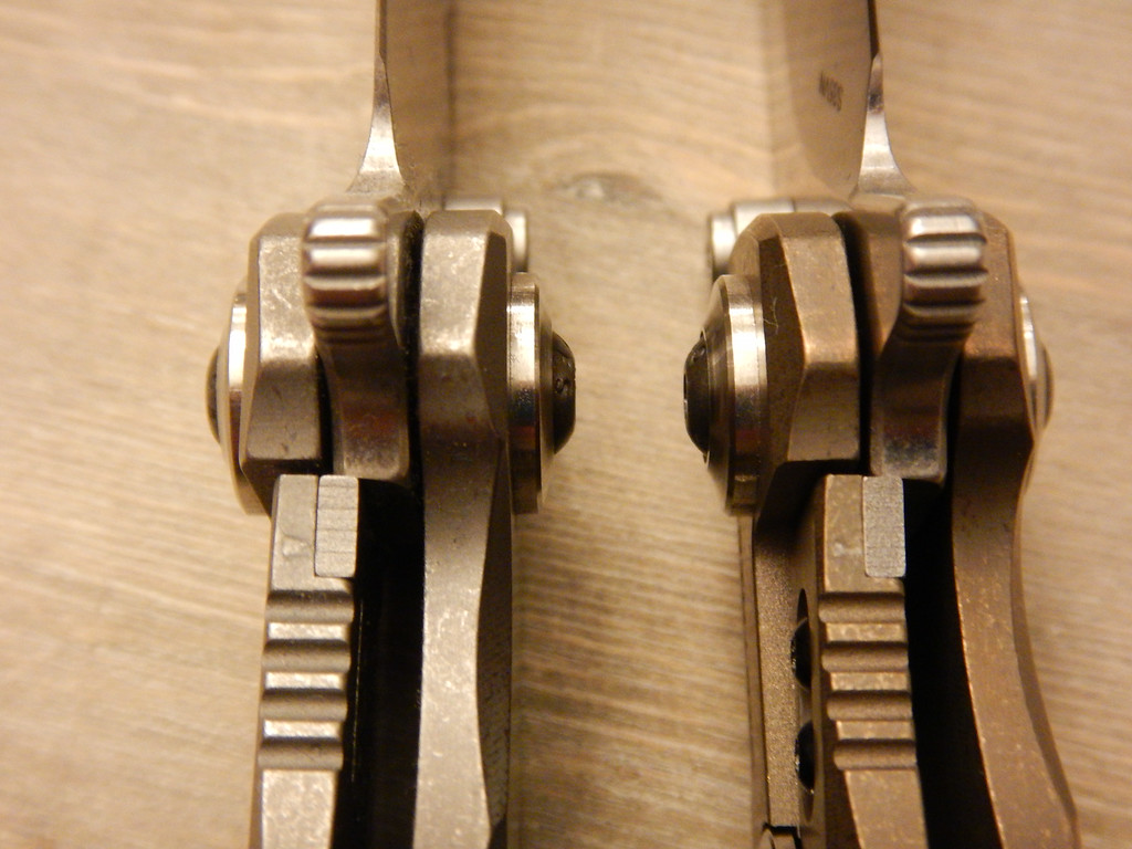

Lockup on both is rock solid. The Reate version is a little sticky. Neither had been cleaned yet in this picture, the D9-A just came out of it's box a couple of hours ago, and the Storm has been carried by me off and on for a week or so.
Here's the main difference between the two, the District 9 Storm is numbered, while the Reate D9-A is not.

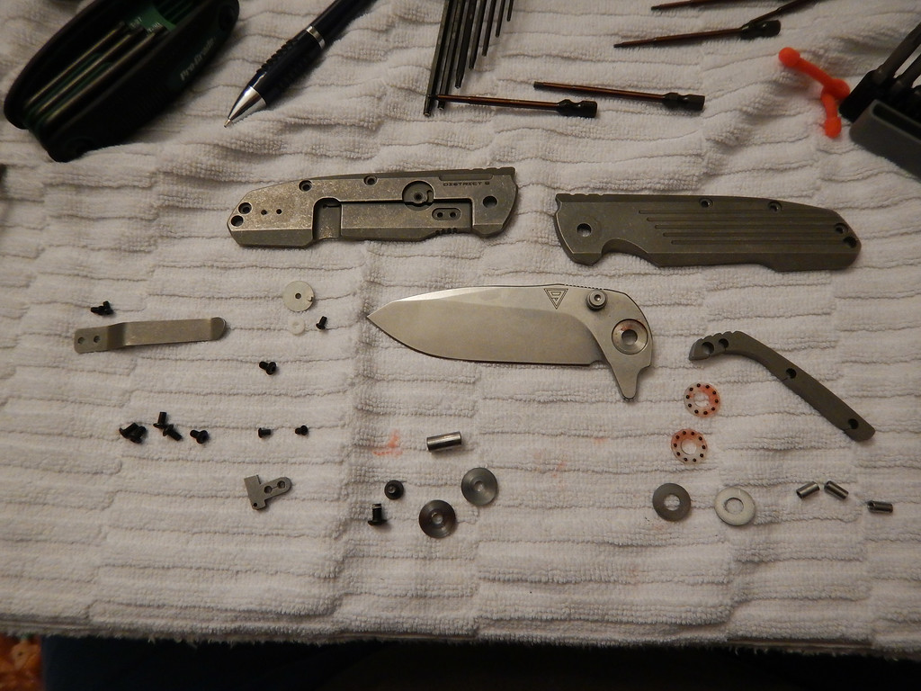

See next post for the tear downs!

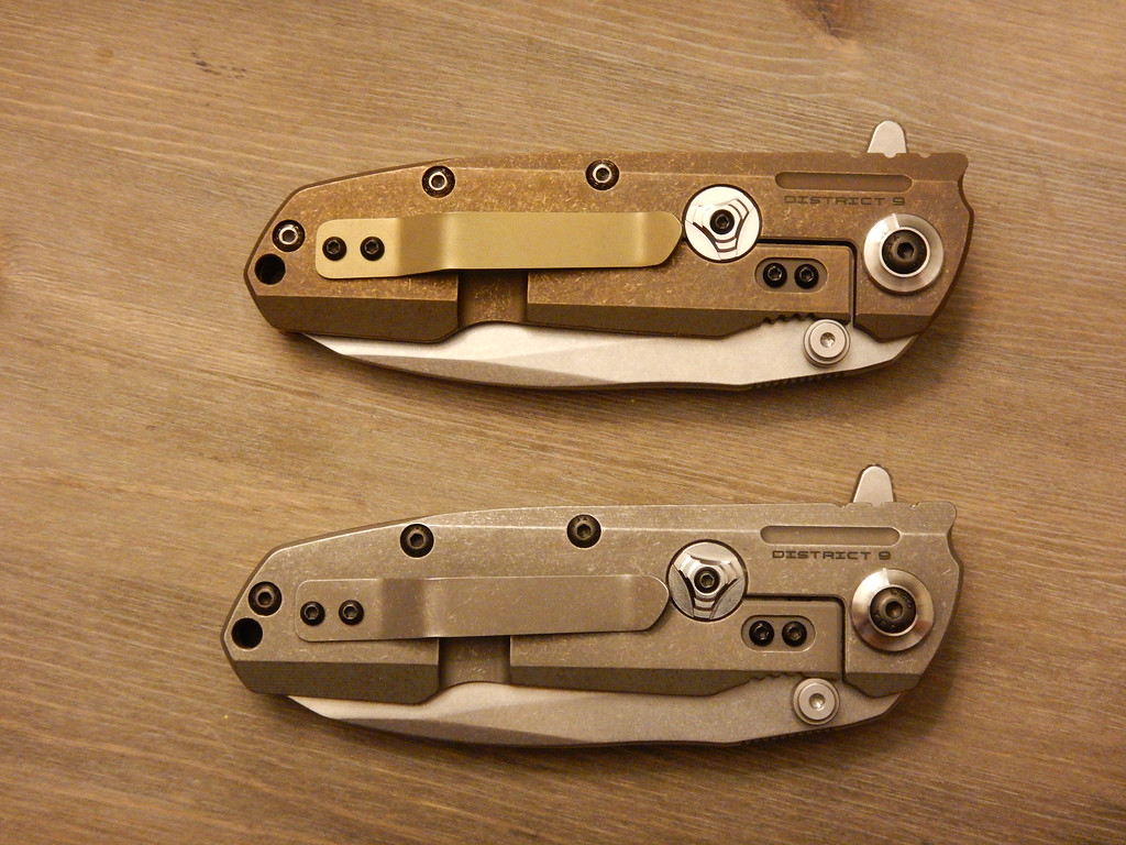

Reate D9-A
District 9 Storm

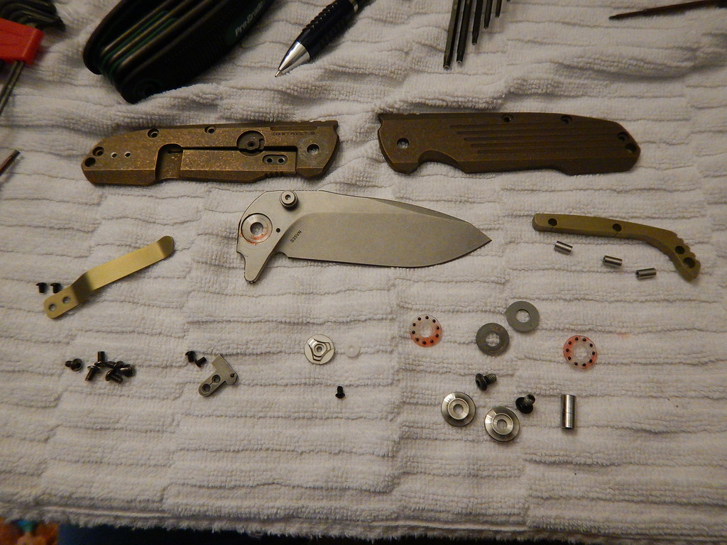

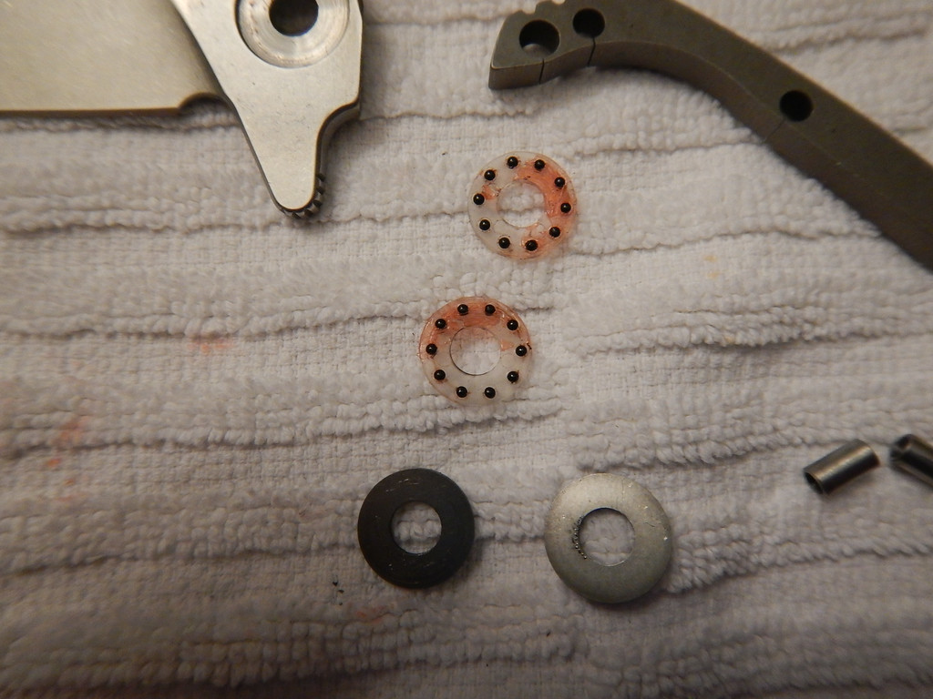

Here's the guts. The pivot screws are 2.5mm Hex and the handle screws are 2.0mm Hex. All of the Hex screws are Class 12.9 which is something like the equivalent of SAE Grade 8 bolts, basically the strongest you can get in Metric. This also means that they are all standard size and not something proprietary, which means replacement parts are as close to going down to your local ACE Hardware and the potential for upgrades to Titanium is possible. The lock bar insert, "rotoblock"/LBS disk and pocket clip are all T6 Torx, the same that Zero Tolerance (and other brands) use for their pocket clips, though the thread pattern seems to be different.
Reate D9-A
District 9 Storm

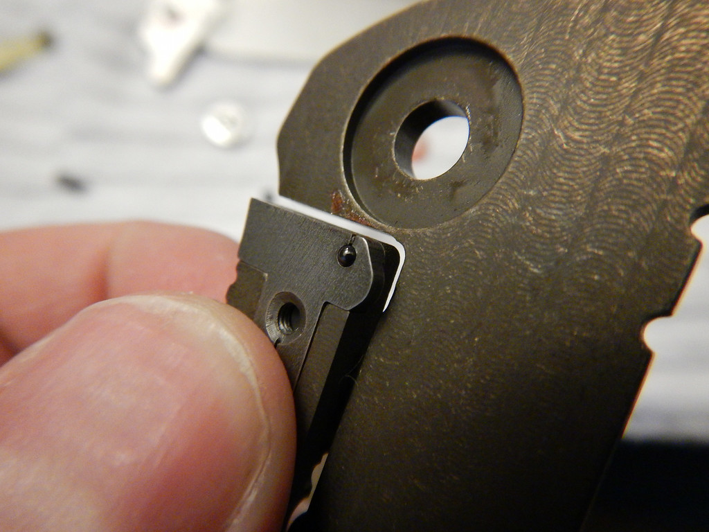

Mystery solved, though we don't know why the change was made. The recesses are the same:
The bearings and pivot construction on both are the same, bearing race on the handle side, and then caged bearings against the blade. The bearings are small and black, District 9 claimed they were Ceramic so since they don't look like steel, I'm guessing that's what they are.
The lock bar insert is well made (exactly the same on both) and seems to use a black ceramic ball bearing for the detent as well. You can also see the overtravel protection. Both certainly feel smooth and have that nice "click" when they close.
You'll also notice that both are well designed enough to keep the lock bar from dragging on the side of the blade when moving through the arc. There's also a relief on the side of the lock face on the blade to minimize shearing against the detent ball.
The action on these is perfect, they fire hard, lockup very nice. As I said earlier, only a hint of sticky lock on the Reate D9-A.

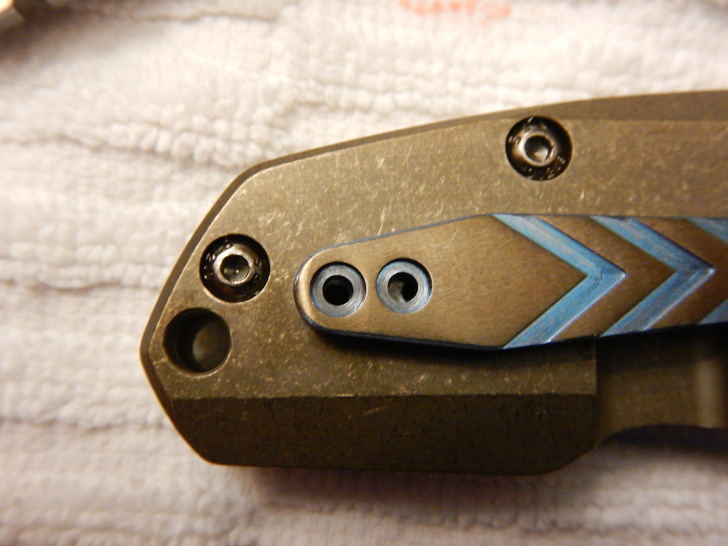

My only real disappointment is the pocket clip, it's just uninspired and doesn't really fit in looks with the rest of the package. It's secure and slides on and off of my pocket edge nicely, it just doesn't look right.
I was hoping a 0561/0550 Gen 2 clip would fit since the pattern looks the same, but unfortunately they don't.
(this is a custom Gnoleb 3D titanium clip for my 0561)
As you can see it's very very close. I'm sure Gnoleb and others would be willing to make custom clips for it, though.
