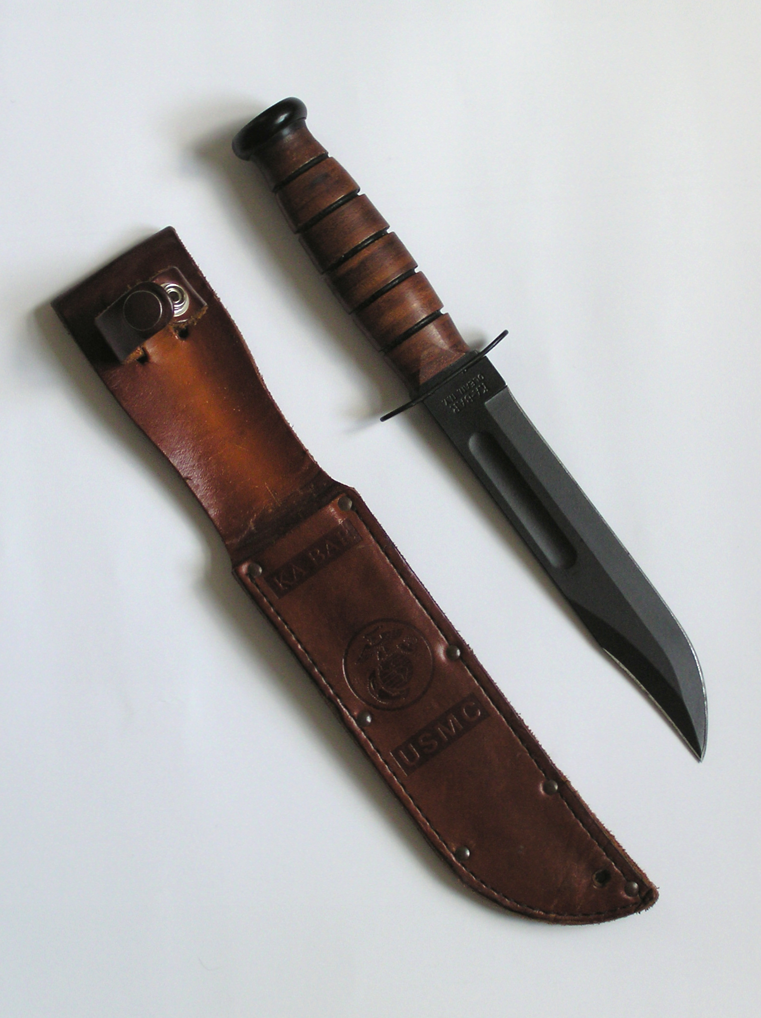

nothing against your design but that is not a practical knife it would be ridiculous to sharpen and very front heavy
Front heavy is good for chopping. I want a good hard steel anyway, I don't want I knife I have to sharpen often. It's much easier to sharpen than a Kukri, which has been a very popular knife design for many hundreds of years.
Also Barry, something to think about regarding the saw back: Every time you saw, the teeth have to clear the chips from the width of the blade. With that thick of knife, that's a lot of wood. There's a reason saw blades are very thin. Also, looking at your handle's guards, I think they'd probably get in the way when sawing.
I didn't link any designs. Your google foo is strong. The hand-guards are a bit stylized, and you may be right about the width. I'm thinking cross-cut type teeth, only good for going against the grain. The saw is really only needed for bones and getting perfectly flat edges, and notching, and isn't integral to the design. I have a blank space for saw teeth, why not have them? On my pre-prototype very crude saw teeth work amazingly well. I think with only a little refinement it will be useful enough.

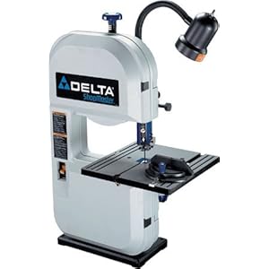

I'm quite sure my ban-saw was intended for wood. It was given to me because it's previous owner hadn't turned it on more than 2-3 times in 4-5 years.

So this circled in red, that is a fuller?
I agree, no value.
I predict as it is drawn, it breaks here.
Those groves and holes, they won't make it stronger.
and
For something that is so thick, the bevels you have drawn are very small, something like a 25 degree angle. per side
You keep comparing the slicing portion to a kabar, but have a look at the thickness vs bevel height on a kabar
The blade bevels have a much slimmer taper to them
something to consider

In my head I know it's "band" but my fingers and tongue have trouble with the 'd' :) I'm too reliant on spell checker!
Mine is a Delta Shopmaster by the way, and the previous owner used it for cutting sheet metal and my immediate reaction was "OOOO! I can use it to cut out my knife blanks!" He replied "I don't know if I'd use it on anything that heavy, but you're welcome to it" I've had it a couple months, have even turned it on (no blanks!).
I didn't get any literature on it, and the machine doesn't say anything about materials. If you guys say it'll do it, I'll give it a shot.
I agree, no value.
Of course. That's the notch I'm moving up to the widest part of the blade, and that hole is out. I like it for tying too, but it's overall not useful enough to sacrifice any strength at its most critical point. The hole on the pommel will be moved to the middle of the pommel, rather than the front.
and
Of course. I just drew a little something there. I'll do the edge at 20 degrees (for prototype at least, but I'm sure that'll work well for a utility blade) with the bevel tapering/feathering off reducing the appearance away from the edge, for smoother cutting.
Yeah, I'm heavily influenced by the Kabar. It's an amazing knife, but I need something a little stouter.
One of these?
No, it won't cut steel
