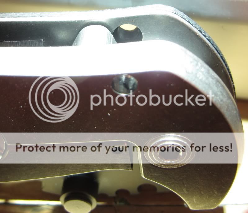

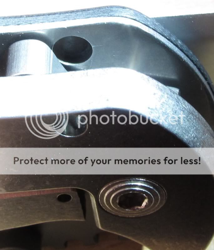

The real fix was sanding the contact point on the blade, a smaller pin would needed to be very different in shape,
the way I see it, the thick part of the pin goes through the scale with the G-10, so the hole in the scale matches the diameter of the pin,and the small side of the pin goes through the a smaller hole in G-10, similar to the hole on the other scale.
the pin does have a slight movement side to side, and so, sometimes it stick a bit out on the G-10 side
I think this is because it was meant to move and rotate for equal wear, but i could be wrong
It would have stayed firmly in place if the thick part was just a bit longer, and the pin side a bit shorter, so it wouldn't move inside the thinner titanium scale, if that makes any sense, somewhat like in the picture below
now if a thinner pin would be installed, it would have a gap in the hole of the scale, and will rest only in the hole in the G-10
for the pin to rest on the scale too and not only on the G-10, it would have to be thicker at that side, and thinner only where the blade sits, or a washer of equal thickness to the thinner scale would have to be installed in the scale hole, and the thick part of the pin would be shorter
http://img196.imageshack.us/i/img6035b.jpg/
http://img717.imageshack.us/i/img6036p.jpg/
http://img801.imageshack.us/i/img6037n.jpg/
http://img560.imageshack.us/i/piniw.jpg/
[IMG=http://img30.imageshack.us/img30/9899/pin2u.jpg][/IMG]
Uploaded with ImageShack.us
steven K.'s pics show better what I'm trying to say :D
hope this makes sense :D
that and my concern with the pin was that it would cause the blade to open farther giving you a poorer fit for the lock to mate up with. thats why i sanded on the blade itself where it contacted the pin at closeup

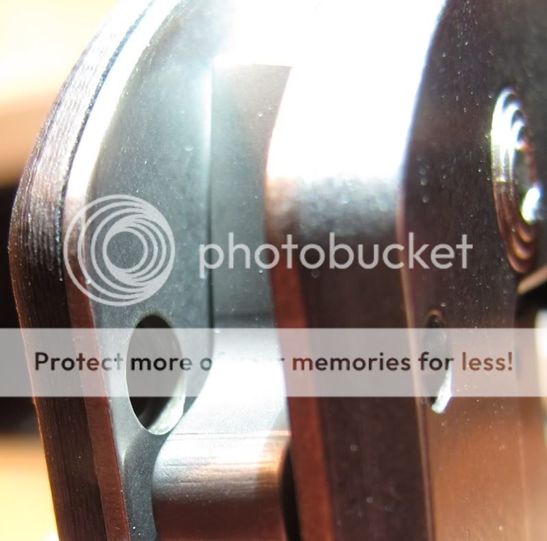

Hey HD, I followed your first review of the folder since I was having the exact same issue. Damn thing was hard as sin to open...I followed all of the advise that was tossed your way and not much of a change with mine. I just took a picture of it because I noticed some rubbing on G10 side of the blade. Does this look like it's suppose to be this way or do I need to ship it out and get it replaced?
Sorry, don't mean to hijack the thread or anything
If I were you, I'd send it in. It seems that a few of them may have this problem.
