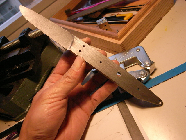

It was more than one month ago when I started to pick materials up, in early march.
It's been 15 years since I made my knife last time, I forgot everything needed for knife making.
I made many mistakes and correcting them took a long hard time....
work in progress on the thong hole.

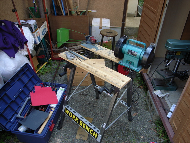

This is my shop. A small bench grinder and a drill press are everything.

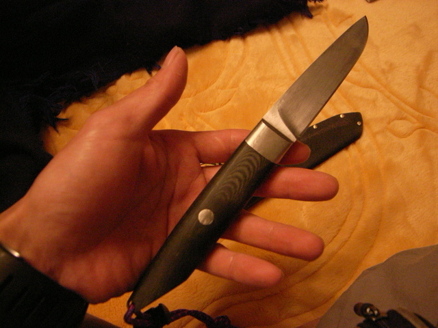

overall view of new knife.
and comparison between the previous one.
new one is slightly larger(about a inch in overall). handle is black micarta.

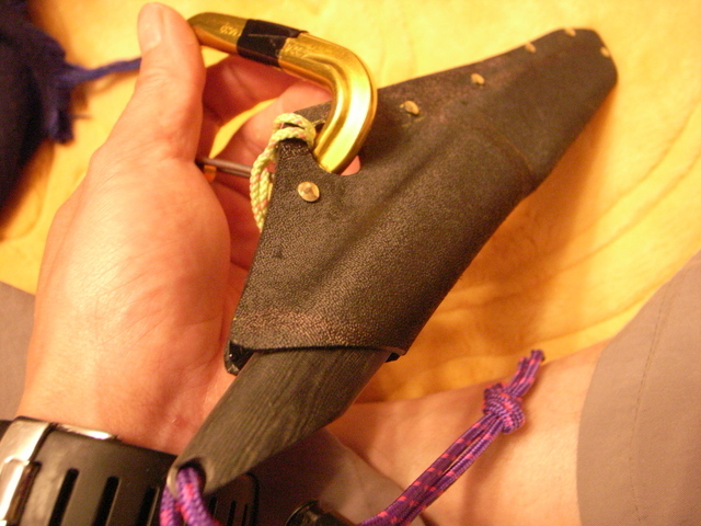

the sheath, fixed with 3mm brass pins.
Knife overall 220mm with blade 90mm long and 3mm thick.
Steel M2, quenched with salt pot and tempered three times, hardened to 64+ HRc.

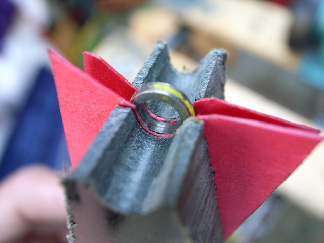

Handle black micarta with red sheet spacer. Bolt and guard are stainless steel.

That's a nice knife and very good work, even more so considering your shop. I take it you made the blade as well?

I did all works except for heat treatment, mostly by hand.

It can be hanged on both right and left side.

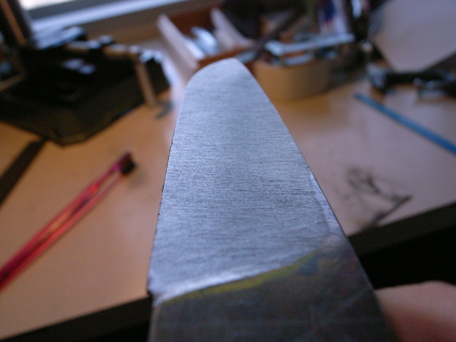

Blade in full flat grind.
Tang is weakly tapered, about a half thickness at the handle end.
