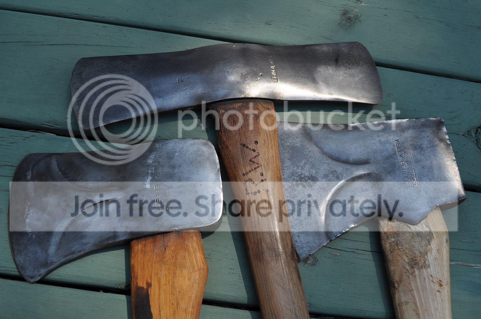

Last week I won an auction on the bay for 3 Puget Sound pattern axes. The one in the middle was listed as a 1938 Sager Chemical Axe with a CCC stamp (Civilian Conservation Corps). The other two were unknown commodities. Living in the Puget Sound region myself and not owning a Puget Sound pattern axe I was keen on getting these.
Well they arrived today and I started cleaning up the two unknowns. The rust bucket on the right with the taped up handle turned out to be a Kelly-Charleston. I found no markings on the 3rd axe but it's still a good axe. Here's the Kelly.
The stamp isn't deep and it didn't show up through all the rust. But after a little work with a brass wire cup on an angle grinder the stamp is pretty clear.
I'm pretty happy with the trio. This definitely rearranges my to-do list. Gotta hang one of these Puget Sound axes.
