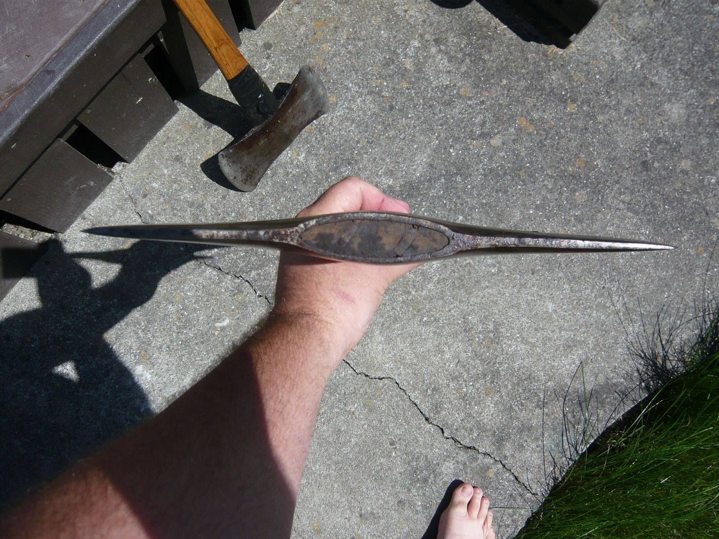

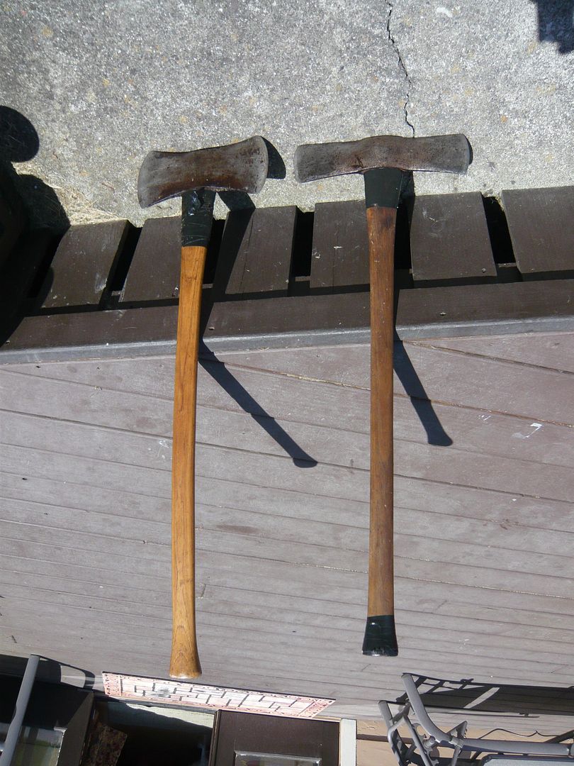

A couple more pics. In the first post of this thread I showed 3 axes.
The one in the middle is a 1938 Sager Chemical Axe. The one on the right turned out to be a Kelly-Charleston. The one on the left is a beat up no-name. So which one did I pick for this project? Bearhunter knows. Of course I picked the no-name basket case.

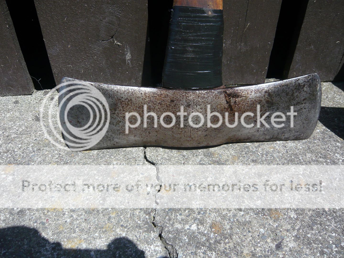

My reasoning was this, it had little to no collectable value so I felt free to treat however I saw fit. It was also the widest of the 3 axes, measuring 12-3/4" bit-to-bit. The long narrow head exemplified the Puget Sound felling axe.
I bought a new handle from Tennessee Hickory. It had a nice grain but it was thick as a bat - needed some major spokeshave work to get down to the thickness and shape that I like.
The eye was well-aligned to the head so it hung pretty straight.

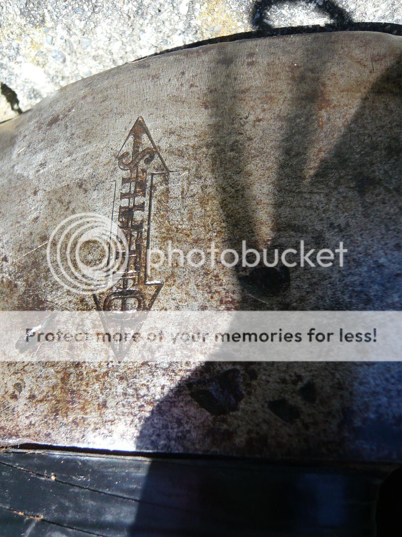

I found only a faint remnant of a makers stamp on this axe. It looks like a row of tear drops forming an arch. If anyone recognizes this please let me know.

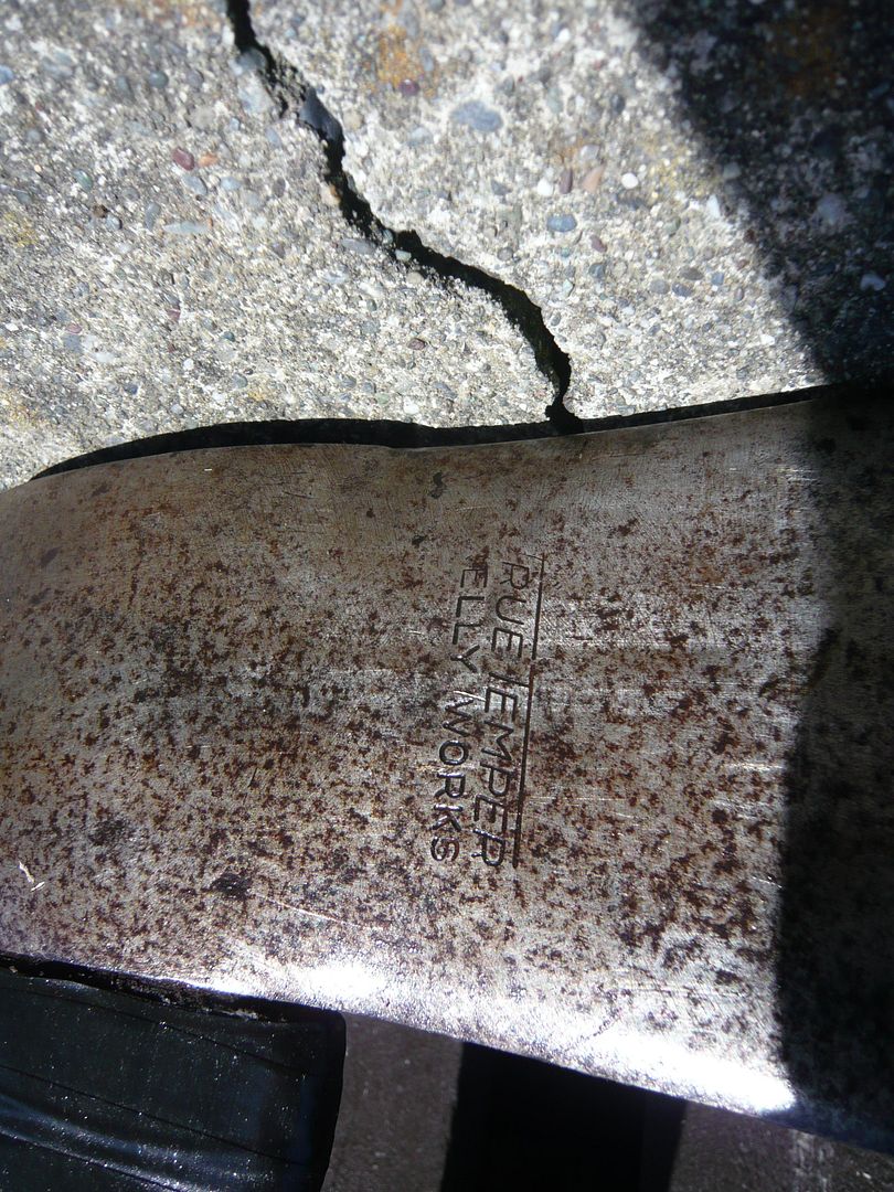

This is the same way..hard but not chippy....took forever to hone...never have sharpened it again...Originally, I thought STILETTO was just a model of True Temper...this has TT Kelly Works on one side and Stiletto on the other.
Do you still have that last one SQ, if so can you see any marks that line up with those on the opposite side?
