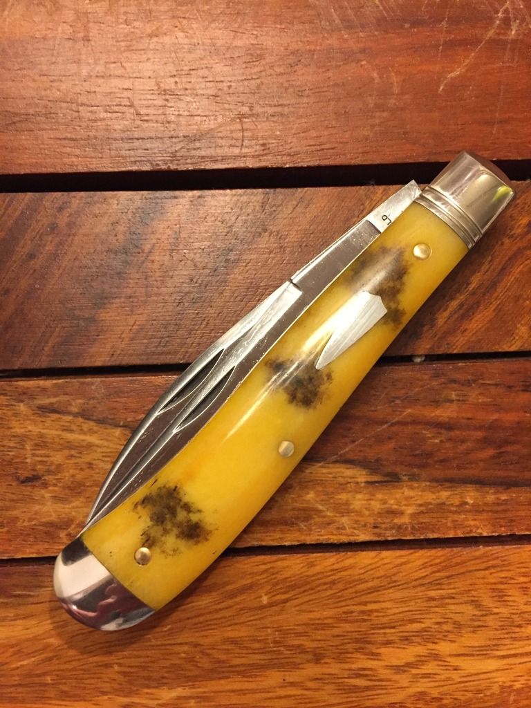

Just received my RBB and couldn't resist giving it a little improvement. Its a fine knife but needed some more dye - I'm very happy with the colour
Very Nice! Do you have any before photos? Would love to see the differences.

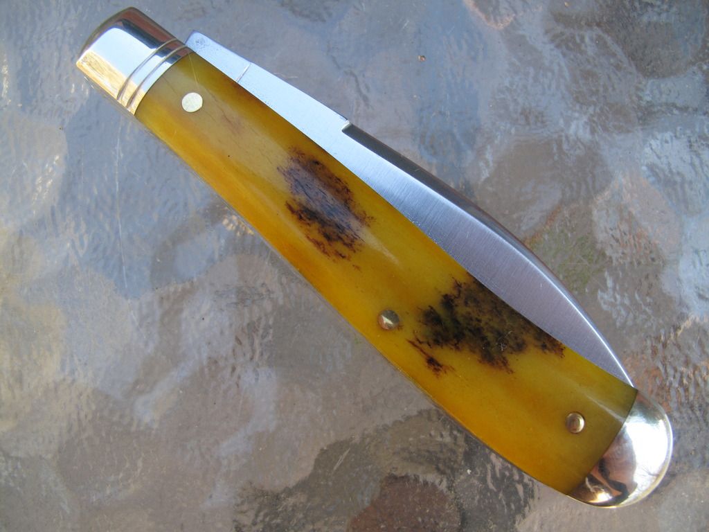

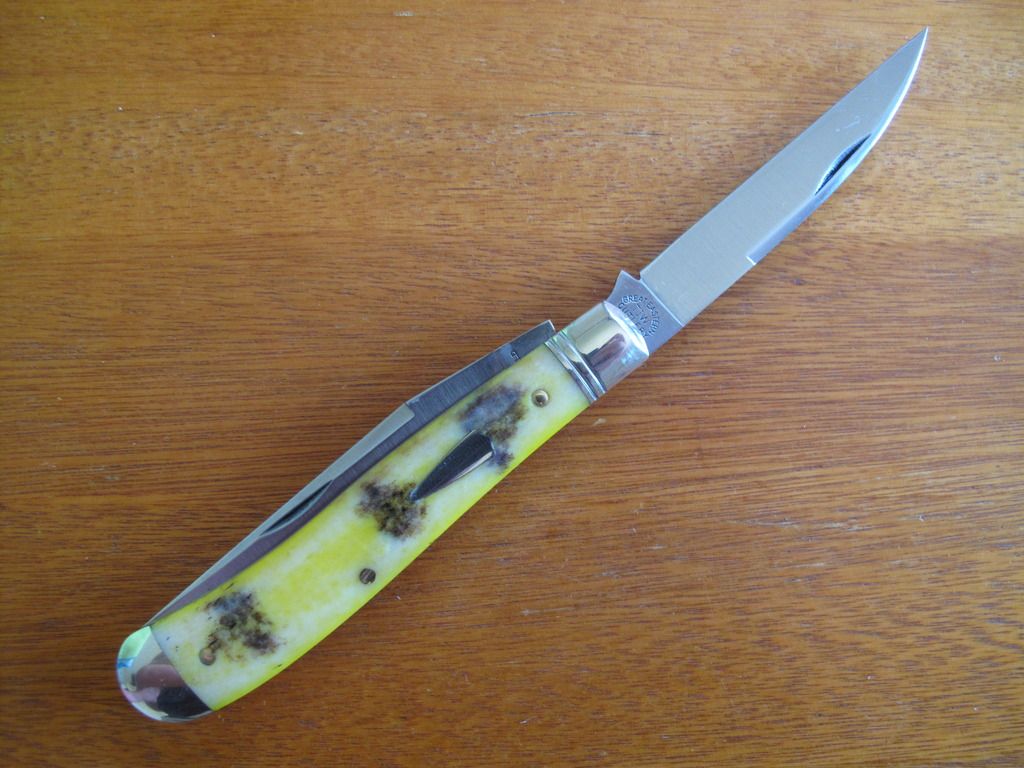

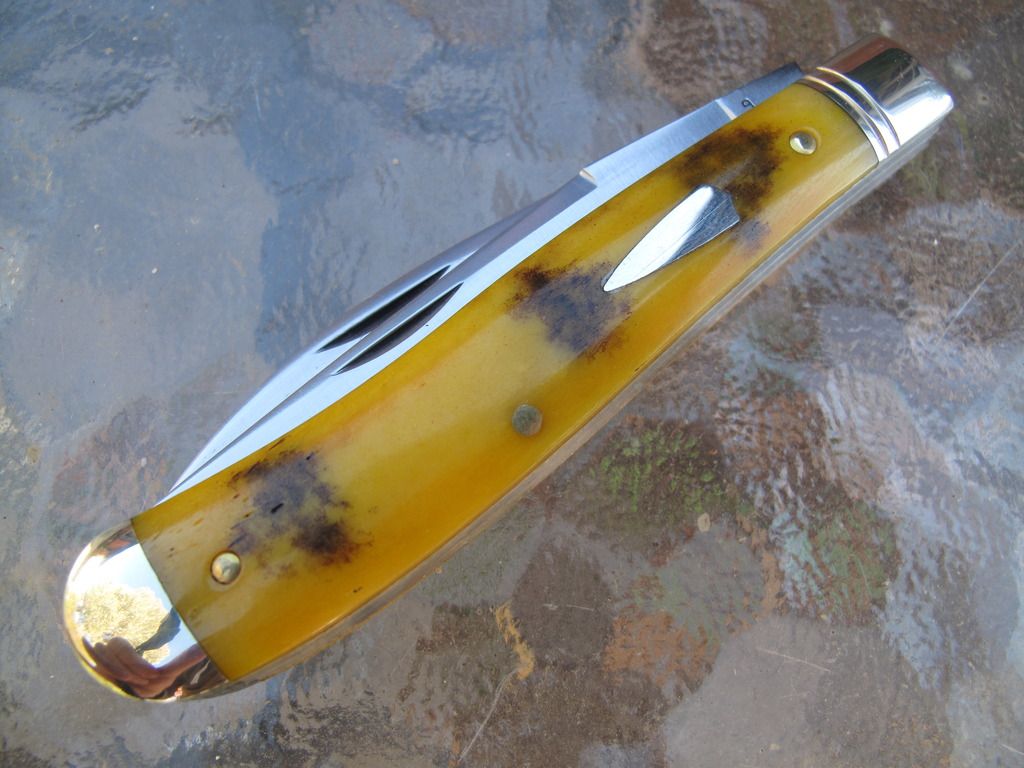

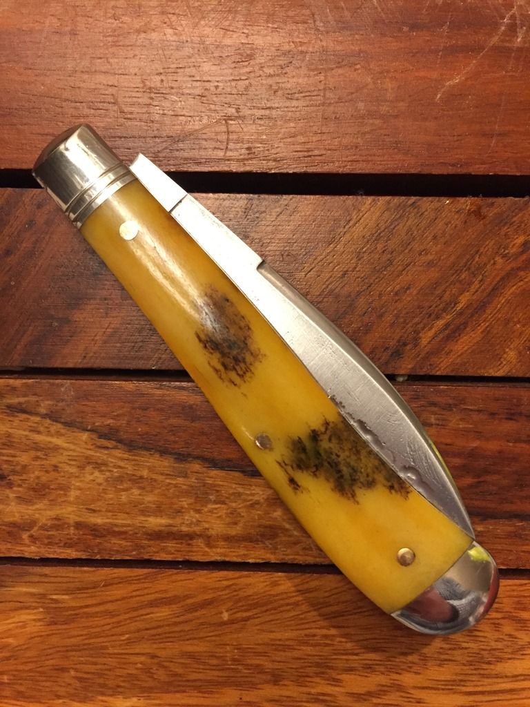

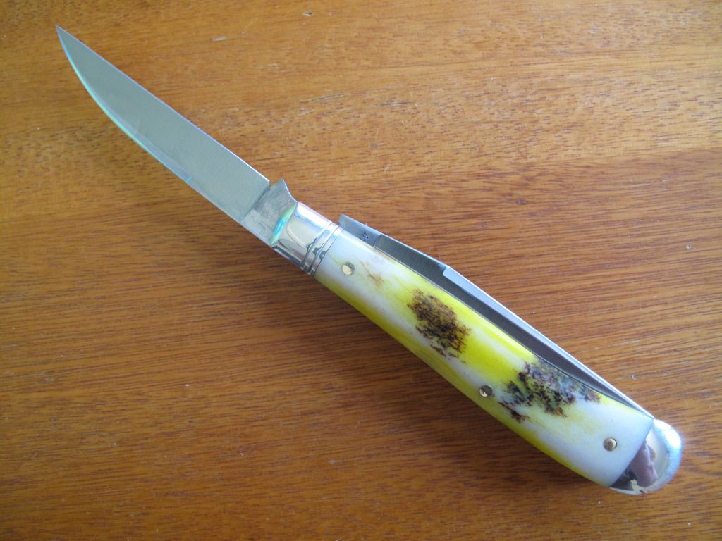

Camillus, that looks awesome! Looking at the before pic of the knife, I'm sorta surprised that one even made it out the door.
It was exactly what I wanted as I was always going to dye it, and I wanted one with nice even spread of brown patches.
So the process is the normal RIT dye method discussed on these forums.
Using golden yellow RIT powder dye.
Its boiled on the stove and the knife is suspended by its blades in the pot for about 3 minutes. Then washed in clean hot water followed by oil. The golden yellow is a little dark for banana so I tried to limit the time. Any longer and it would have started to turn too gold. As it is there are lighter areas that keep it looking banana.
An important trick is to try and avoid pitting on the metal (mainly the backspings) by moving the knife around and also regularly wiping away any tarnish spots as they appear on the metal with a paper towel. I think the tarnish is caused by specks of undissolved dye.
In my experience bone always seems to cope well with dyeing - i have never seen it shrink or crack- although it did start to discolor a little from the heat with whitish blotches apearing. This discolouration faded as it cooled.
