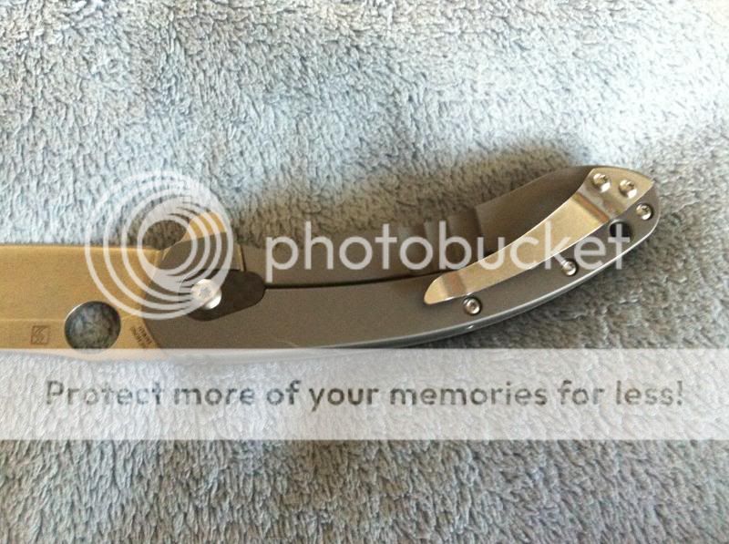

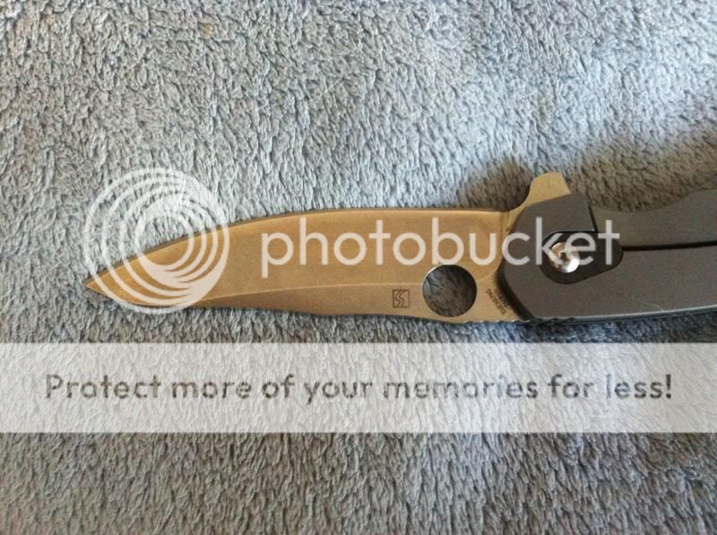

Here are the pics I took, they aren't great but it gives you the idea.
Per Jill Jackson's cited post.. I would say that the fake's spyder logo looked 'thinner' than the real ones. Your's seems to have the proper bolded look... but doesn't mean its 100% real.
Doesn't look good to me. The titanium doesn't seem to have a stonewashed finish as it should. Really bad if an actual dealer is selling the fakes! Sorry if it is a counterfeit Fish, at least you aren't out any money.
Is your lockside stonewashed? Jill's pics show that the clones don't sport that "roughed up" look.
Thanks Kniferbro, if it is a fake they got two very experienced knife guys. I can't begin to think it is a fake given the packaging, accurate bar code etc. but I guess one can never really know if the knockoffs are getting that good. I will check with my friend to see who he got it from and check if they are real Spyderco dealer, but it sure looks legit, it's just a quiet one!!! I'm tending to go with spketch's call, and just say it is a little on the 'muffled' side. It functions very well though.
Argh, just saw spketch's current post, the lock side scale does seem stonewashed to me, compared to other knives I have with stonewashed blades or whatever...
