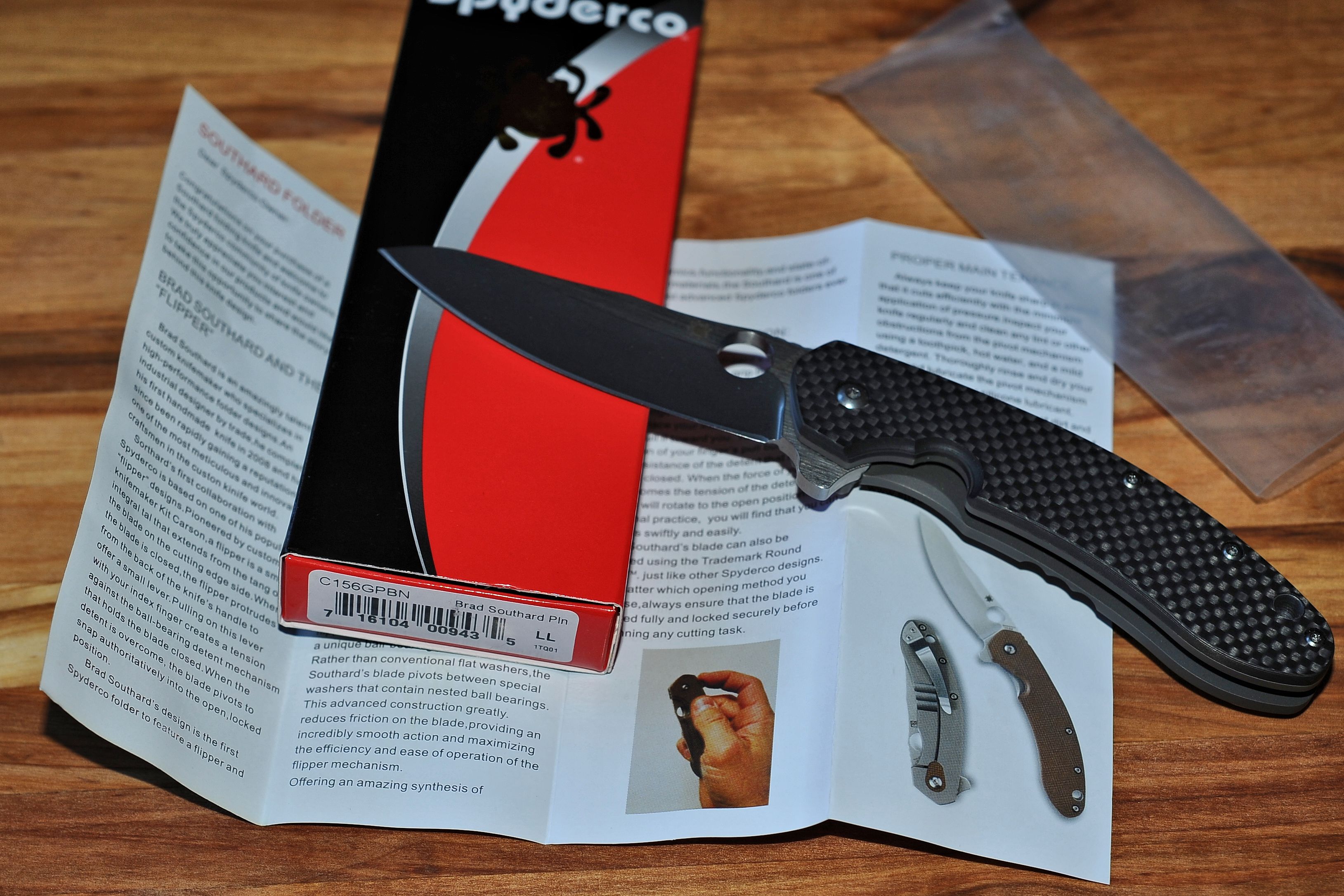

If you're up for disassembling it you can be certain. The bearings used in the fake are totally different.
Wow that fake is a pretty close copy judging from the pics, thanks for posting. How is the feel in hand, the fit and finish? If you held them and opened/shut them would you know a difference?
Yeah I'll take it apart, what am I looking for?
One other thing, the blade on the one Jill posted has obvious grind marks in the blade, this one does not, just FYI. The fit and finish of the knife is very good, and the blade was razor sharp out of the box FWIW.

Curiouser and curiouser grows the cat. (old saying) Well after taking it apart this knife it has the right liners, with the appropriate holes, the correct looking bearings and blade, pivot and pivot hole, but the pivot center spacer does not have a flattened side. The scale looks somewhere in between the one in the link that Mastersword posted. Which I suppose would be correct if that is not a carbon fiber scale he is picturing...I am pretty sure that this one is at least mostly real:rolleyes::rolleyes::rolleyes:

Hate to disagree, but it looks like one of the fakes to me. Those are my comparison shots getting linked here and I have at least a little bit of Southard experience (I have, uh, a lot of real Southards, and I've handled three of the fakes, including the one I bought to disassemble and shoot comparison shots of).
I could be getting fooled by the low-quality photos (please try to shoot in brighter lighting if you take more photos) but the scale looks like the fake Southard CF scale (it also comes in four colors of G10 fakes) and the frame looks like the smoother finish of the fakes as well. :(
Also, FWIW, I'm pretty sure that every real Southard I've disassembled (lots) has had a flat side to all the hardware pieces I marked in my photos, along with matching flat spots where they seat.

I don't own a southard but to me the most noticeable difference is the clip.
The fake's pocket clip is shaped different than the real southard and so is the one on your knife fish.

Thanks Kniferbro, if it is a fake they got two very experienced knife guys. I can't begin to think it is a fake given the packaging, accurate bar code etc. but I guess one can never really know if the knockoffs are getting that good. I will check with my friend to see who he got it from and check if they are real Spyderco dealer, but it sure looks legit, it's just a quiet one!!! I'm tending to go with spketch's call, and just say it is a little on the 'muffled' side. It functions very well though.
Just saw this bit as well--the fake had the exact packaging, bar code, etc. that you're describing. I'll dig up a photo of the box if you'd like to compare it to yours (I'll see if I still have a shot with the sticker, hang on).

If you're going off of my photos from the Spyderco forum (linked previously in this thread) you should note that my pile of real Southards all have custom clips (made by STR) added to them. The clip on the fake looks exactly like the clip on the real knife, except that, IIRC, the holes were a slightly different size between the two.
Here is a high res image of the 100% fake carbon fiber scaled Chinese Southard clone, with the label end of the box showing. Compare your box to this one, compare the way your Southard's frame and scale looks to this, that should give you a better idea if yours is a fake or not:
I scanned the barcode from your image, it links to the real Southard on Amazon :( These cloners are getting better and better at what they do, I have to wonder if they're Kaminoan...

Those fakes are scary. I only found one real difference, that somehow nobody else pointed out. The pocket clip screws are all wrong.
That said, if somebody sold me that Southard, I would have a really hard time telling it was a fake. I'm guessing the blade steel would give it away.
