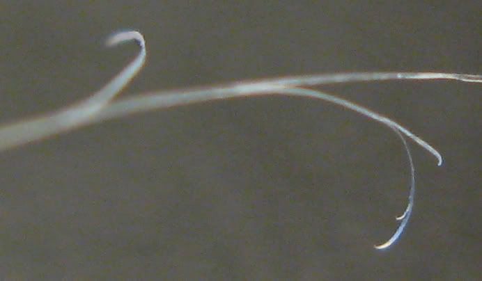

I have the Kershaw Mini-Cyclone in ZDP-189 and found I worked way too hard trying
to tune up the edge on ceramics, I ended up buying the DMT diamond stones and
used the coarse and fine and then the ultra fine ceramic and a strop and now the
blade is what I'd call amazingly sharp, as others have made mention, if it isn't sharp
you are not finished sharpening it yet, but, there is the possibility that you are also
not holding a consistent angle, so I'd give fair warning to practice on a knife you are
not as fond of first before addressing a more expensive one.
This knife will easily do what I call tree top trimming of the hair, where you need not
bring it near the skin in order to cut the hair off, also of course it will make curlicues
or fuzzy sticks of a length of hair as well, nice shots Vassili !
So, if you have some 'new' tuff stuff in your folder, you would do well to not give up
but give the diamonds a try and a word of caution, do not press as hard as you would
on regular stones, moderate pressure does the trick...
G2
edited to add, what to look for when sharpening, I hold the knife up towards the light with
the blade angled so the bevels catch the light and you should see a very smooth even flat area
of the bevel, if when you tilt the blade and see additional reflections, other bevels, it means you
need to keep working on it, similar to the magic marker trick some people do, to see if you are really
getting down to the final edge. I just look for the light, follow it along the edge to the point and it
should be nice even plane of the bevel down to the very edge. I'll try to get a shot of that, tough to do!
didn't get a good shot of the edge, as it's more that you 'follow' it along the edge in the light, but did
take a strand of hair, luckily it keeps falling out! lol, it's a bit grey so it's not as cleanly seen as the other
shots above but you'll get the idea, took the one and made several slices against it with the mini-cyclone
