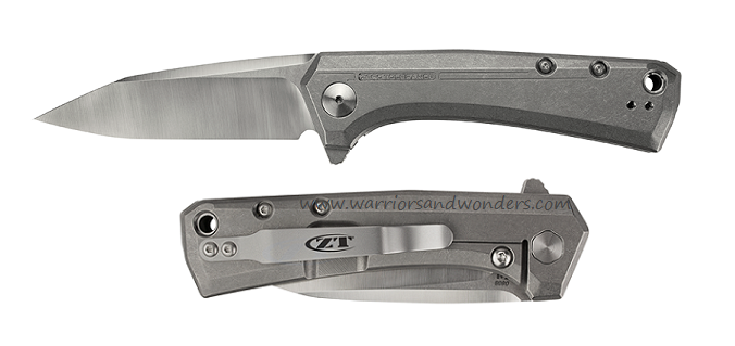

Any reason why the new model ZTs (204/220/456) lack the sleeved/sandwich construction (screwed into standoffs from both frame and lockside)? Construction/Build Quilty has always been a trait of ZT.
Construction of newer model (note: screws going directly into the titanium frame)

I imagine it's cheaper to have straight channels on the spacers and threaded holes on the lockside. I hadn't really noticed it until you brought it up, but it does (sadly) seem like an attempt to reduce cost. If you strip the threads on the lockside that becomes an expensive replacement part...

Having tapped holes in titanium and steel, titanium is a HUGE pain in the ass to tap.
I seriously doubt it's for ease of manufacture or cost.
If anything, there will be extra work involved in removing broken taps from time to time.

It has screws from both sides that go into stand-offs, right?
That's not having holes tapped from each side, it's having holes on each side.
Drilling holes is easier than then tapping them.
It has a back-spacer, but that may have stand-offs inside it (like on the old Spyderco Military, before they switched to an aluminum back-spacer).
Or it might be steel that has tapped holes...steel is easier to tap than titanium.

Looking into it more, it might be a threaded titanium back-spacer on the 0808...have to find disassembly pics or e-mail ZT to find out for sure.
If that's the case, then they could have gone with a similar option on the new knives.
It just seems that it must be a designer choice to go with standoffs and a threaded scale, since they then have the expense of stand-offs, AND the risk of broken taps when threading the titanium side; that doesn't sound like cost saving.

The 801/808's scales are drilled, meaning no threads. The screws come in from both the show and lockside scale and go into a threaded standoff.
The 804's lockside scale appears to be tapped, meaning the hole is threaded. A single screw comes form the drilled showside into threaded hole on the lockside. I haven't disassembled the 804, so I do not know if the standoff is drilled or tapped.
