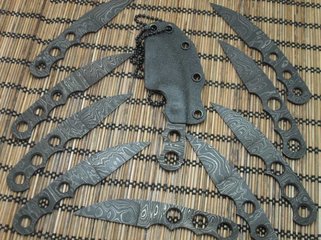

Patrice you may want to increase your fc ratios, and let them soak for a bit. The method to my madness changes from etch to etch. However i sand at least 3 times (i use steel wool) between etches, and imo if you let the etch sit for a bit before you neutralize with windex, you'll retain some of the darkness.
Heres a pic of some of Brads damascus in neckers, i etched all 10 in the same jar, and it looks like i actually used up the fc in my mixture, it went from brownish to green! Do some experimenting with your scraps.
Greg
I agree with Greg. Using a stronger FeCl mixture for longer and doing multiple etches should do the trick. To get a grey black finish I have been known to soak blades up to an hour in 50/50 FeCl/Vinegar. Just remember super delicate parts like tang threading can be etched away on a long hard etch.
Thanks for the Damascus etching tips guys, I'll give that a try.
