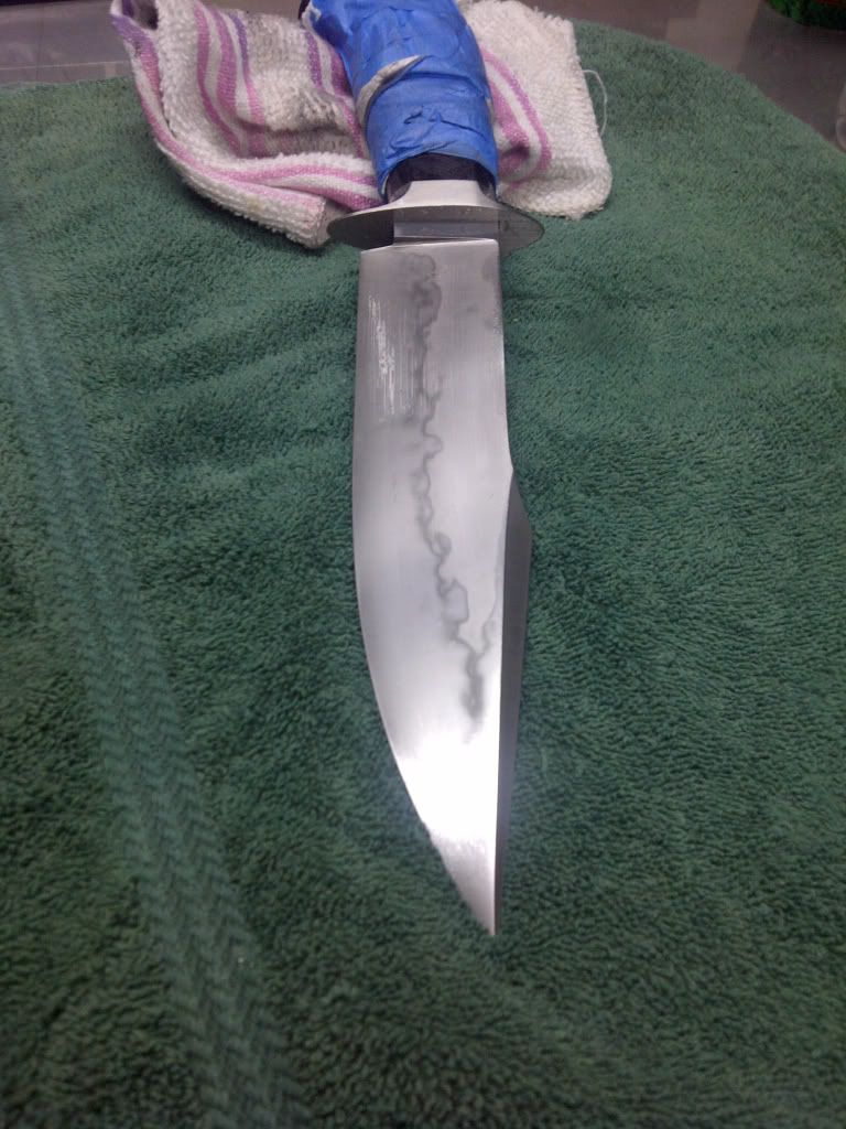

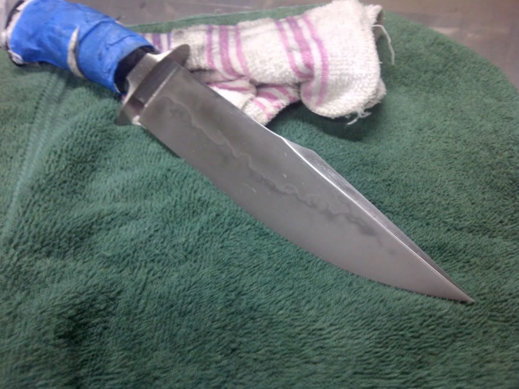

I do everything the same heat gun and all but I use ferrul chloride and the blade turns black then I flits the he'll out. Of it and I wonder why I don't get that beautiful art polish finish that u get :)
I get the more Shiva Ki look :) not to refined
All kidding aside Nick you truly are an artist
My feeble attempts

Don't be so hard on yourself Joe, I think yours turned out great! And mine are really ugly near the middle of the game... :) Here is Will's blade after 5 etch and polish cycles... but before getting the oxides polished off.

Your blades look good Joe. Flitz though won't really bring out the white wispy parts. Loose abrasive powder will change the dark parts on the hamon boundary white. You can get 1200x rock polish on ebay. Try it...:)
Thanks Stuart
Would that be what is commonly referred to as rotten stone ?
