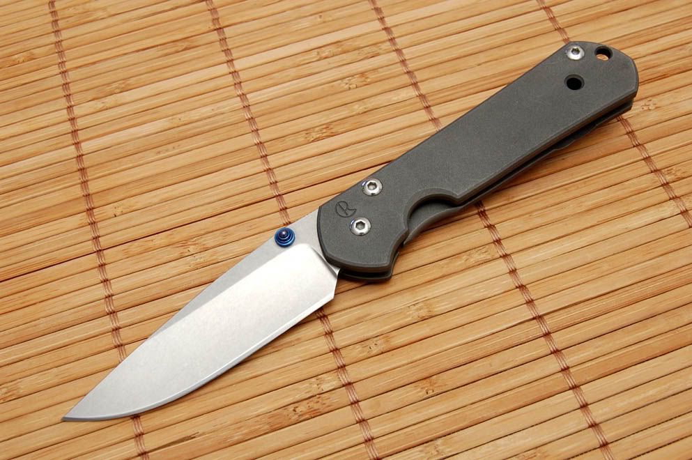

Here is a photo that I have never posted before and it is the only image I took of this knife just the other night. Placed the knife on the background focused and took the photo (I always use the self timer)
1/21 sec @ f 3.6 exposure
all that was done in the image editor was to crop it as was suggested re the photos presented above by shappa.
may I also suggest that if you are using something to prop up knives when shooting, cosider getting some plastecine from an art store or maybe a store that sells scrap booking or childrens play things. Easy to mould and manipulte and size and much easier to hide and it will compress and hold a knife in place when needed.
