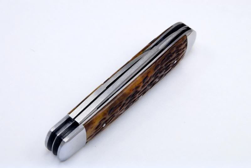

Wanted to say thanks for having this great thread. This is a knife I made,and photographed using my old homemade light box set-up. I will post a follow up pictures in the near future after making one up close to Coop's design. In the mean time feel free to pick this picture apart! The only way I will learn. The VERY biggest problem I see with it is my reflection in the bolster and too much shadow.
Thanks all, great thread.
It's strange that you got such "hot spots" on the bolsters if you use a tent. Did you have your ceiling lights off?
Ken, I don't want to pick apart anyone's work. I think you did a fine job by anyone's standards.
It does appear from your photo that you have your light source on either side of your subject. Most of the time you are going to want the light source, back behind and up and over your subject. So that your broad light source is reflected in the blades and bolsters of the knife. About the only time I would use side-lighting on a knife would be to accentuate the texture of the handle material.

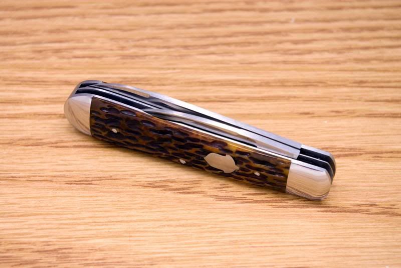

Just set this up and one of my first with new light box. My old box was open from the top and I had halagon shop lights shinning in from the sides. I will box in the back and top better after i pick up some more foam board.
The bulbs I picked up are "natural light" by Westinghouse 23 watts 1425 Lumens.
I still have a lot of playing around but I can see this is going to give me better results.
Ken
Ken: As Phil aptly pointed out, the shot is clear, but not perfecto. Yes, you need to tame those reflections and come in over the back with your lighting. Rounded bolsters are especially hard. Looking forward to round two....

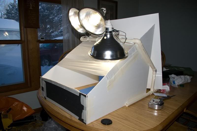

When I look at Kens box camera angle seems like it might be a problem and also the diffusion material has wrinkles in it and that will affect the highlight/shadows falling on the subject. It is imperative that the material be absolutely flat for the best and most reliable results.
When I see setups like this and I know Coop that this thread is the $75 setup, what with products available on the market and quite inexpensive prices without the inherent problems attached, it concerns me that folks don't just buy a good product instead of spending time & $ in this way.
I also see that the distance from the light to the subject is not very much and this does not allow the light to diffuse enough before striking the subject. Move the lights farther from the diffusion material so as to allow the light to spread and then be diffused before it strikes the subject. If you are unable to do that, then add a layer of diffusion material to the outside of the lamp holder which will add to diffusion.
During the daytime, if direct sunlight is coming thru any of those windows, Ken, try to cover the windows as extraneous, uncontrolled light can also affect the results.

Ok, I think I am getting it now. I turned my new light box around, and have the Lights from BEHIND!
Its only been stated about 20 times in this thread you need the light from behind! :D
I also used Coop's method for merging multiple shots of the same knife into one photograph using Photoshop(in my case PS Elements) Boy , it almost makes it fun! and much faster than what I was trying to do. I know I still have shadows and things to work out, but I am getting a good foundation I think for better knife pictures thanks to this thread.
Thanks for your input Murray. I snapped a picture of my light box in my excitement before I really had it set up.
Ken
