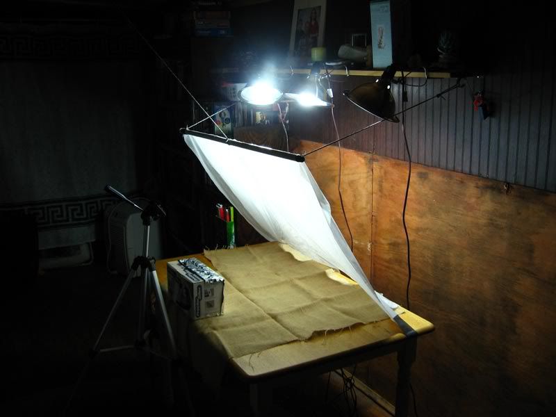

First of all, I'd just like to say thank you, Coop. I've found a wealth of information in this thread, and I finally was able to acquire the first ingredients to putting together my own setup today. I picked up three of the clamp-on lights and the appropriate GE Daylight 6500K bulbs today at Wal-Mart, and I'll be getting the PVC pipe and fittings I need tomorrow, along with a roll of draftsman's acetate tracing paper if I can find it, to finish it up.
I just couldn't wait to try out these lights, though, so as soon as I got home I rigged myself up a (very temporary) diffuser setup out of a broom handle, two white plastic trash bags, and a few pieces of paracord (as well as the ever-present duct tape ;)). I attached the lights to a handy shelf in my back room, which just so handily happens to be totally windowless, dragged my table over, and laid out a piece of burlap. Not having a reflector of any sort, I jury-rigged that as well, out of an (clothes) iron box and a bit of aluminum foil. Then I grabbed my camera and tripod, and got started taking shots of my EDC knife. I wound up doing better without the tripod, actually.

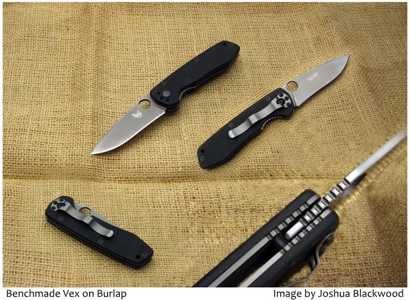

Here's what I managed to get out of it. I'm not terribly satisfied with it, but I think I did pretty well to be running on two hours' sleep for the day. The composition of the collage is lacking, I know, as is how I did the lower right inset, but I threw it together pretty quick in CS3 so I could get it posted. I'm definitely still a learner at Photoshop, and probably will never cease to learn new things in it. Photo collages like this are a bit outside my expertise. The only reason I used this format was so I wouldn't have to upload multiple images on my current dial-up connection.
And my setup:
Yes, that's paracord tied from two angles holding up a broomstick with trash bags taped to it. I'm a redneck and proud of it. :p
Thoughts? Criticism? Pointers I can make use of tomorrow, when I've had a good night's sleep? Thanks for looking!

Hey Josh,
I like your style. I'm just that way too: Git 'r done....!
Already you are producing clean shots. Black handles are ALWAYS going to give you fits. If you have CS3, then you will really be able to make it all work.
Lower the diffuser about 6" in the front. Get it closer over the table. Lower your lights down a bit ,too, when you can. I like a shot with a bit less vertical lighting.
The D.O.F will improve on your inset if you use a smaller f-stop, but you will HAVE to use a tripod if you choose to do so. Only need it for the inset blurring.
You can see why I so often use a non-linear background material. The insets blend MUCH easier.
Keep at it. You are 90% there!

Thanks for the quick reply, the kind words, and the helpful advice! I'll try a few different knives tomorrow night, after I make the changes you suggested. Hopefully by Tuesday I'll have my more permanent diffuser put together; I'm basing it off of what you use in your studio, as you posted in your other thread here.
I forgot to mention in my earlier post, but I'm using a Canon Powershot A560 point and shoot, so no manual adjustment of the f-stop, unfortunately. I am saving up to buy myself a DSLR later in the year, though, as I've realized that I really enjoy photography in many varieties, and need something with manually adjustable f-stop and shutter speed (among the myriad of other features) to really be effective in what I use it for.
And yes, I do indeed see the difficulty inherent in blending backgrounds with more texture and depth to them. I think I seriously overused the Clone and Heal tools in CS3 on that collage! :D
