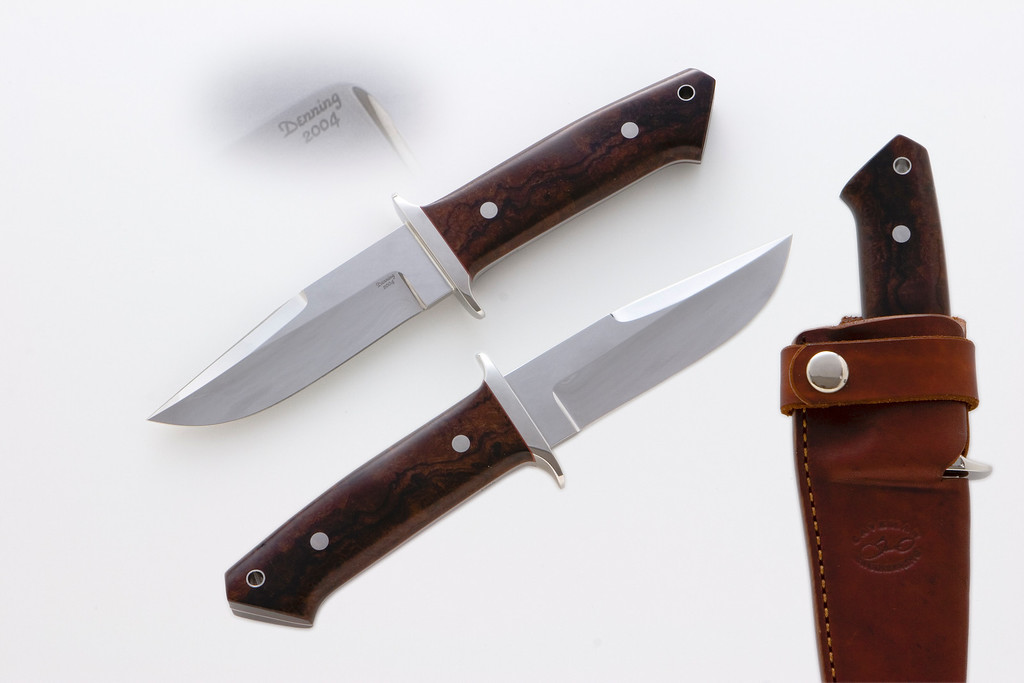

Here are my latest attempts - comments & criticisms are welcome.
and
On the Chute, I cut the picture to close to the bottom edge and the feathering means that there's much smudgeness there...
Hi Joss,
The images are clear. Hard to get a pure white background right, but you did good. I don't love the composition, but that is a style preference and subjective anyway. I know you are exploring and enjoying yourself, so keep on it. It took me about 200 images before I got real comfortable..
Lighting improvements are wished for:
Stag bowie: Get more light directed at the lower LH quadrant. I like the texture on the stag, shown with the harder lighting.
Chute: I would want the lighting a bit higher so the highlights are closer to the center than only on the edge. You want to show all three grinds, yes, so maybe even the brightest area of the blade as the flats, and not necessarily the top clip. Same with the vertical shot. It needs lighting on the face, not just coming in from behind. Pay attention to the reflections on the button before you accept it. That's a killer from my perspective.
Just my thoughts. Hope you are enjoying the process!

Thanks for the comments. What I think you're pointing out are some of the limits of the simple tent concept. My light is coming from the back only, and the white reflectors don't do much other than removing hard shadows. I think that ideally, I would need the lights at at least 2 height / distances. I also need a much, much wider diffusing net. The set up I use as a diffusing surface which is not much wider than the piece of board on which the knife sits, which means that the light comes largely from straight behind. Maybe I should try again with also the flash, maybe with a -2 EV adjustment. I think it will still overpower the lights though.
What do you not like with the composition?
I'm not convinced of this. Looking at this photo from your setup shows me you can get the light up much higher. The highlights are almost centered, showing me a more overhead lighting.
The blended insets. It's just an enlargement for one (My personal peeve with insets, and some noted pros also do it, is to simply add an enlargement. No new information or perspective. Yuck.), and they are hazy and vague. Sorry.
One more quick question. I have noticed that my previous multiple exposure pics looked off because the perspective of each exposure was different, and therefore the final pic looked un-natural. This is also something I notice below in Jonathan's Ed Fowler pic for example. So on those pics I tried to not move the pics around too much. Each of the exposure is exactly w the perspectives (or shadows) out of wack?
That's a great start. In order for a multiple inset image to look 'plausible', it is imperative that the lighting is all coming in from the same general direction (It's called global lighting). Yes, that's smart.

Aaaahhhh... But that wasn't done with this set up. It was done with a hand-held 580 EXII with my DIY diffuser. So yes, the light was coming from a different direction - front and above in fact.
No sorry needed, I asked for the comment. I understand your point.

Tastes will vary, but IMO, the overall composition is off-balance, stark, with poor use of space. The inserts of the logo aren't done well at all. I would say they're too small and feathered badly.
You have the technical skills needed to do these types of compositions, congratz they're not easy to come by. As Coop said the artistic composition part only comes with time. Time spent studying your compositions. Ask yourself while you're doing these images; what is the main focus of this composition, and are you forcing the viewer's eye to keep returning the subject. Or is the composition taking the viewer's out of the picture?
In my images I try to avoid dead space. I try to fill every part of the the frame with information. I want to keep the viewer's eye moving within the frame. I want there to be depth and levels to my images, and play with perspective. I think it keeps the viewer involved with the subject. Many years of commercial photography taught me that job number one was to make the viewer look, and job number two was to hold their attention as long as you can.

Thanks for your frank feedback. I completely agree that the composition needs work. I need to learn to visualize pre-shoot. This is a area of development for me not just for knife pictures but all my photos.
Can you give me details on how I could improve the feathering? It is another area of development for me to know how to use Photoshop. I know the tools, and I know how to find them in the menues, but not *how* / *when* to use them.
I tend to find your pic a bit busy for my taste, but I can see how there's much empty space in mine.

Joss, first of all let me say that my Bose image is one of my busiest images and I was just trying to show you an extreme opposite. Your compositions are going to reflect your taste. Try to balance the main images better within the frame.
Your feathering technique is fine, my objection would be the size of the logo, (it's way too small) and the logo isn't centered.
How and when to use the tools in Photoshop are again part of the creative process. Compositions often start with pre-visualizing with what you want to show in the image. Rough thumbnail sketches on a slip of paper often help. Next, photograph enough different angles of your subject that you allow yourself some other choices, if your original plans don't work out. There should be one image that is the main focus of attention and all other elements should support or reinforce that main subject.
Most important, don't be afraid to try different compositions, don't get locked into one view. Place the main subject first. Try different positions with your inserts, different sizes, different opacity of the layers, maybe even the focus of the inserts. Play, try different things. Take your time, study the image at different sizes. Reverse the image and see how it looks backwards, or upside down. Remove the color and see how the contrast of the image is. After a while you'll know when the image looks right to you. However don't be surprised if some time later on you'll see things you want to change. The perfect composition is when you can't change anything without hurting the image. I've seen perfect compositions, I don't think I've ever made one.
