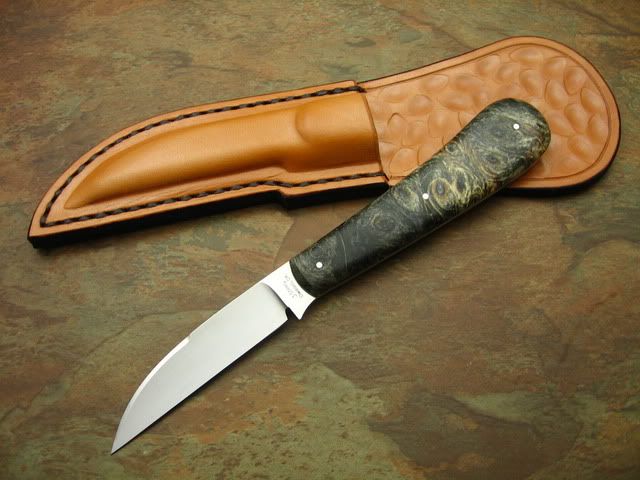

I moved my lights more directly overhead as you show Coop. It helped ! :thumbup:
image is shown as the photo was taken, no editing
^^ A very clear shot. I'm pleased your are proud of yourself. Nice.
My critical eye now looks the the next biggest improvement: Reflecting light back into the dark areas. The lower RH corner needs more light.
I surround my knives with reflectors. I use 5"x16" mirrors with an adjustable angle (I made them up myself from a plexiglass store provided stock.)
You can do the same with tin foil and cardboard. And, it needs it.
Please keep going. You are turning closer to Knife Photo Pro with every shot. :D
Coop

Thank you Coop, I see what your talking about, I will use them on the next one. I may make Photo Pro some day, but theres only one Photomagician and his name is Coop :D
very nice photo,aswell a beautiful knife who is the maker
Thank you, I made it and the sheath.
4ever3,
That is one good looking knife and the sheath is "spot on" for the right match. Excellent work! :thumbup::thumbup::thumbup: Looks like you got the photography down pat as well.
Larry
