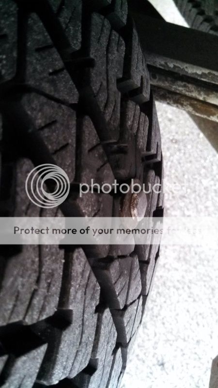

I picked up something while out and about this morning. They were kind enough to include a washer.
:rolleyes: Oh well, I've been meaning to take it in to a shop and check the alignment. Now I have an excuse not to be lazy and actually go.
