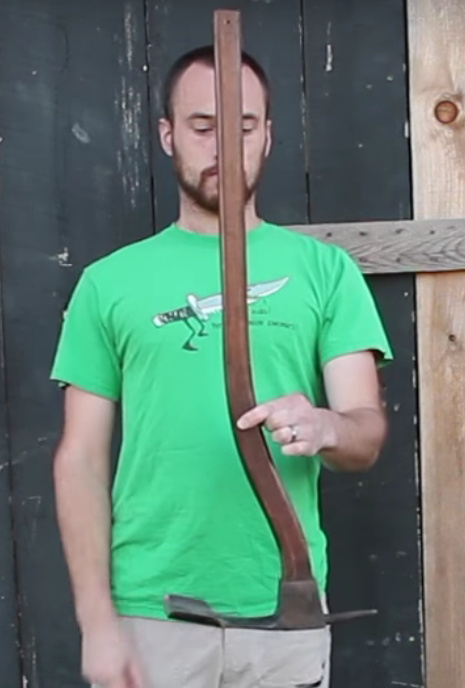

An adze or even a broad axe never experiences the hard use that a felling, bucking or splitting axe endures. What you can get away with on a adze handle won't fly on an axe handle - not even close.
Doesn't come close to the curves in the adze handle you posted earlier. And that bottom one is weak. It ain't gonna last. Just because someone made one doesn't mean it's a good idea.
I don't see how you're able to judge the strength without seeing the run of the grain. The appearance in profile can be very misleading, and what you see in the shoulder could be the results of a typical thick shoulder reducing. Also, the curves are very close to the adze example. However, please refer to what I actually asserted:
"Also, other tools have been made with very curved handles without issue, and many axes besides. With good grain alignment there's minimal runout of any significance."
I did not say that an axe must have a handle as extreme as that adze I posted. I said that very curved handles are feasible, and that with good grain alignment, there will be minimal runout beyond the superficial. This is a straw man.

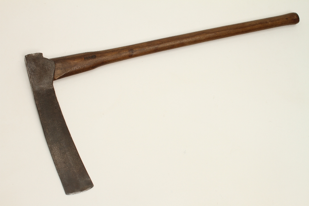

I honestly don't know what an "axe's balance" is. It seems like a feely thing that frequently gets tossed out but never explained.
This explanation seems to be primarily for a felling axe.
There are other points on an axe that it could be balanced from. An axe could be balanced vertically on one's nose. Does that make the axe a "balanced axe"?
This is a great post for several reasons. I like the last paragraph. I can't count how many times I've seen some clueless person find the balance point of a knife and, holding it there, proclaim that the knife has good balance. Every tool has a balance point. That doesn't make it well balanced.
But I really want to talk about the meat of this post and that's the image and its explanation of balance when referring to a felling axe. When making that horizontal swing you don't want the axe twist down because it's lacking a poll and is unbalanced. And we've shown that trying to compensate for the unbalanced axe with a screwy haft isn't practical or durable.
Example, when I'm hewing my axe has an offset handle. I've mentioned before that this makes the axe want to twist in your hand. You're constantly expending effort to counteract gravity.
Now imagine doing this all day......
...with an unbalanced axe. A logging crew often worked 60 hours/week. Think about doing that with an unbalanced axe. You'd fall behind the guy working next to you. The camp boss would notice right away. One day you'd pick up that other guy's axe and give it a few swings. You'd feel the comparative ease of swinging it right away and realize why you couldn't keep up. Next payday you carefully put aside Papa's axe that he brought with him from France or Italy and you'd buy yourself a blocky American poll axe or later on, a double bit. And if you didn't you wouldn't be around long.
